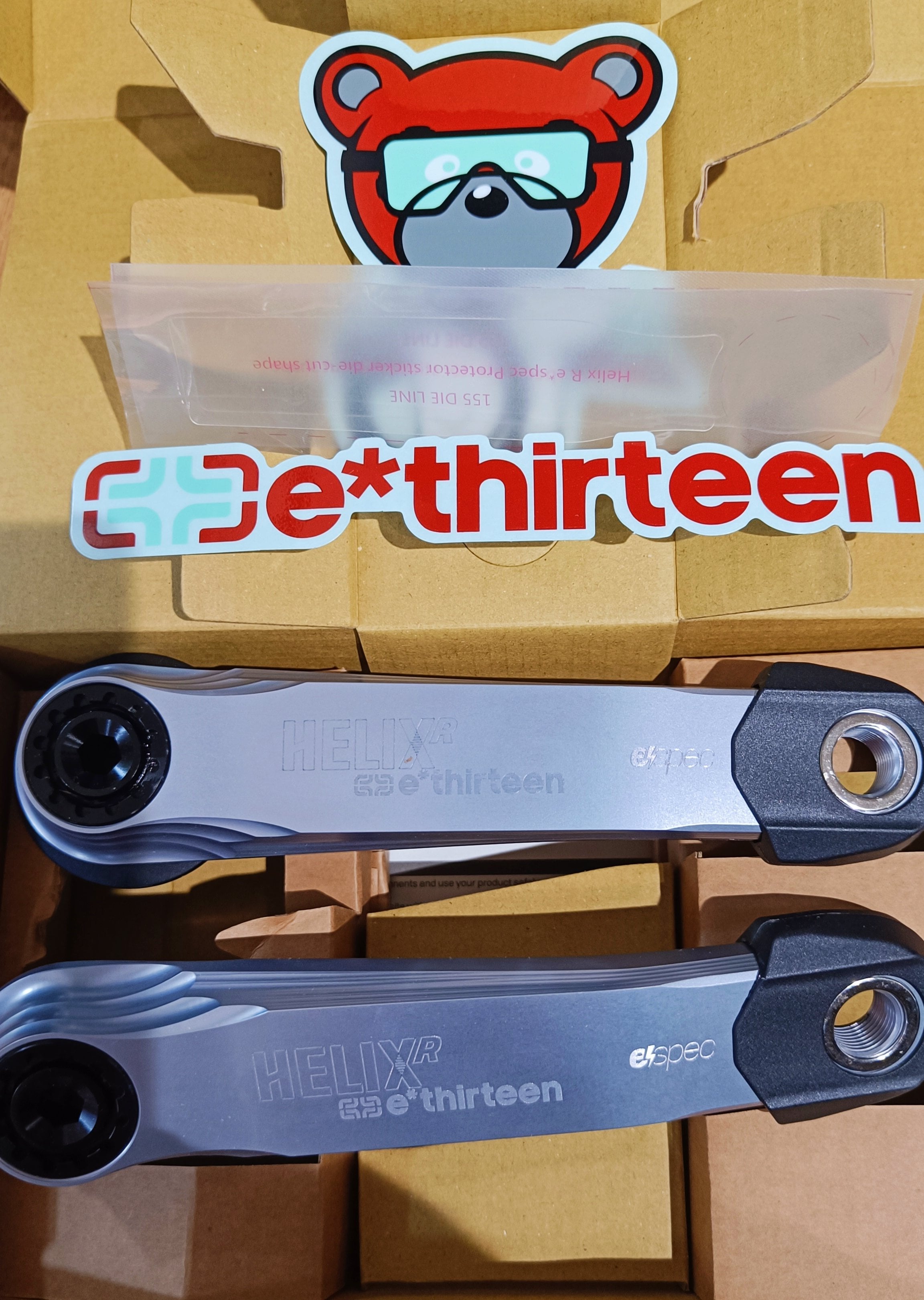

I've ordered them direct from E*Thirteen UK in Silver - 155mm.
The cranks arrived today.
Free next day shipping from e*thirteen UK, great service.
They look really nice and definitely feel lighter than the SRAM X0 they're replacing but they are 5mm shorter, I'm hoping they don't bend as easily.
They did come with boots and protection tape.

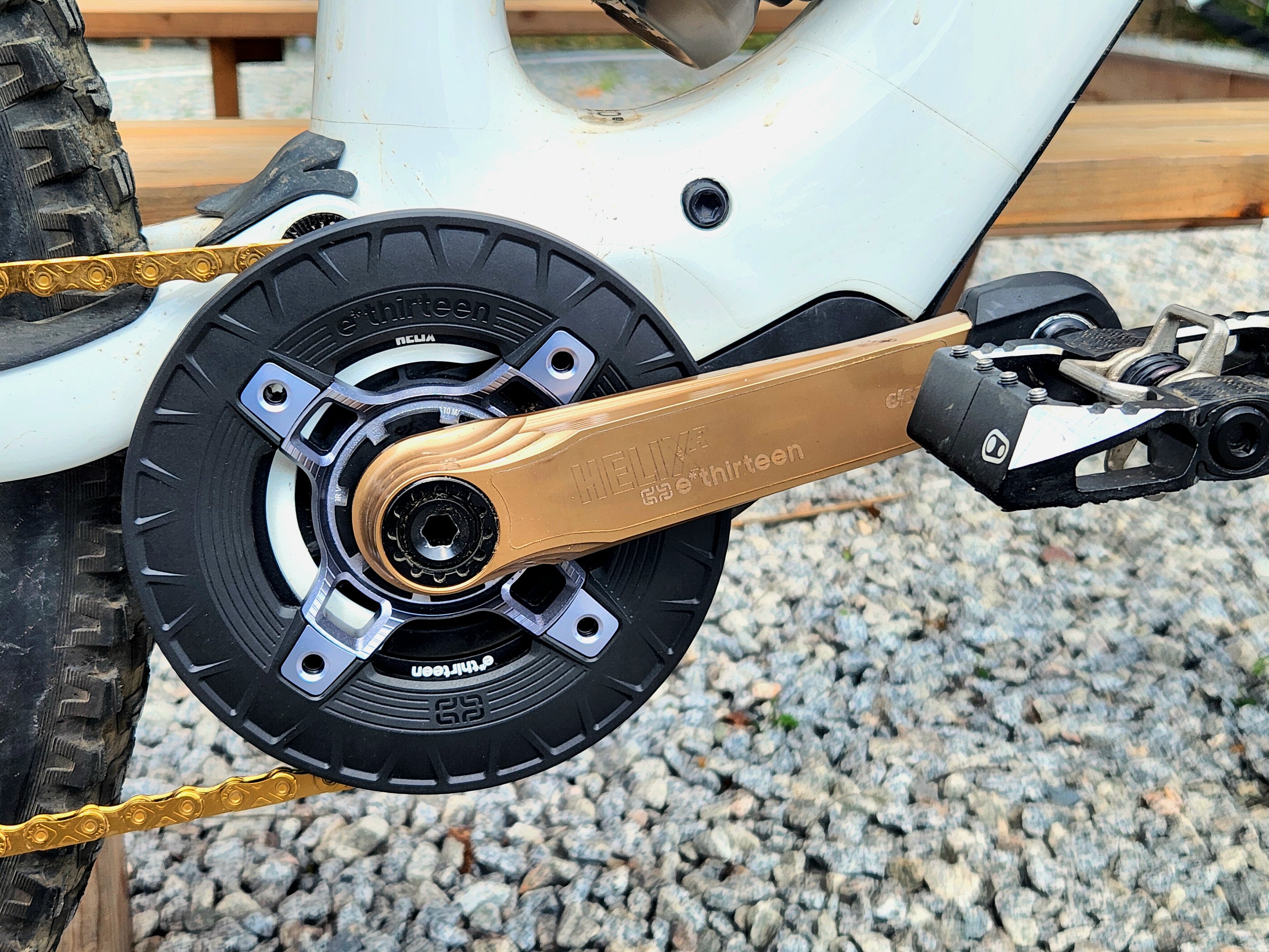

Absolutely. They have a similar profile to the Hope and Pinnd cranks they just have less machining in the underside. Look great in gold if you have any kashima!

please, question - I also want to replace stock cranks on my Amflow PL Carbon Pro to these e13 Helix, there are 2 offsets, 21,5mm and 26,5mm, is it right to order 21,5mm, I hope? I think that original ones are about 22mm, so 21,5 must fit...?
Many thanks for your reply..
Hi. See above I have these on my Amflow. I'm actually looking to sell the gold ones as I've changed these now (no issues with them I just like changing parts!) not sure where you're based but I can stick them on ebay if you're interested.
