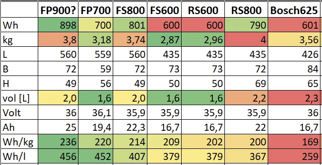

a 10s4p config would mean 40 cells. that would be 936Wh max in the datasheet. a little bit unter 900Wh in reality

I think is ~3g more per cell so 40 * 3 = ~120g heavier than the current FS800 battery

Not really, weight difference with wh equalized is minimal: FS700 3.18kg at purely theoretical 800wh would be 3.63kg vs 3.74kg of the FS800, 110g not that much difference.
The only real advantage is the slim tube with the issue that 700wh is the only capacity doable with this cells.
The problem with the cells of the FS700 is that you can only create a 700wh or 1400wh that would be twice the length or twice the width both not practical for an emtb.
