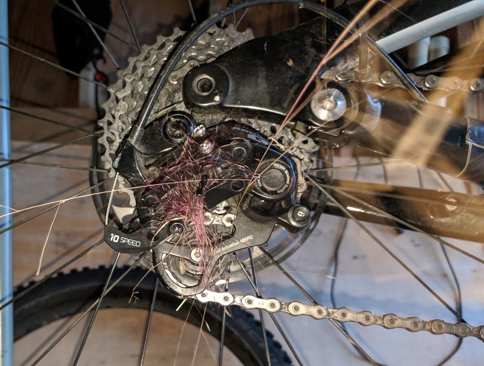

It's really the farm where I ride, the woods are haunted.
Never occurred to me as a possibility, but I may have to look into that issue for my riding area...
This mech was free of debris when I left tonight:
