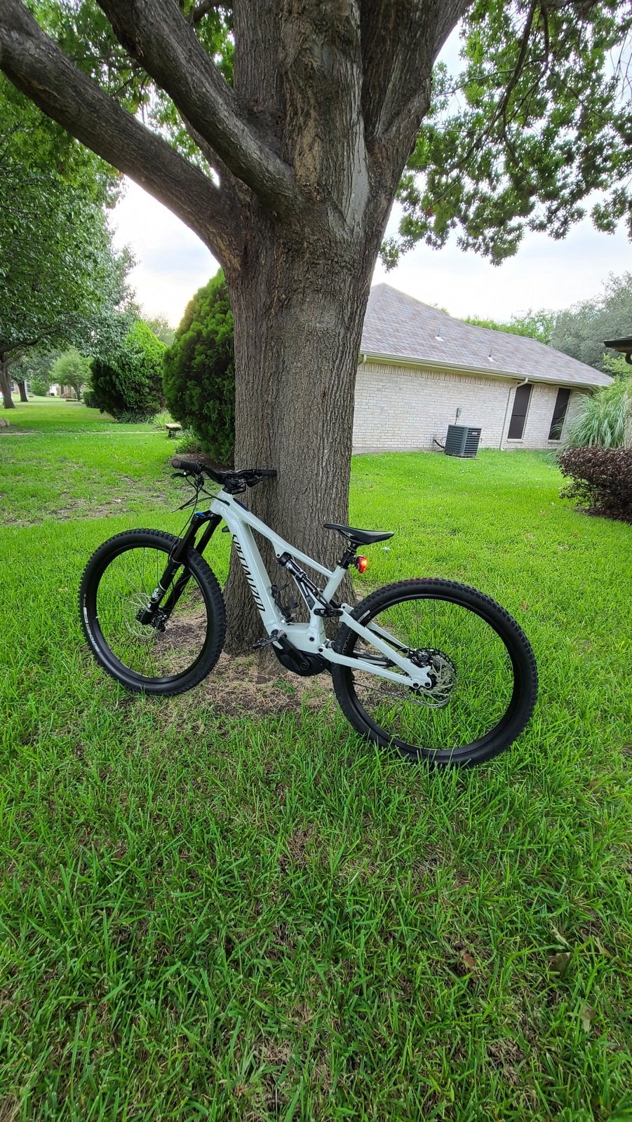

I had one for a few months. For entry level it is one of the best. But once you look at the specs. The Spesh gives alot more bang for the buck imo. I felt like the geometry wasn't downhill enough. It did ride great. But the power delivery of the brose was night and day, way more natural feeling.
I also went to a Turbo Levo Comp which upgraded suspension to fox 36. If you are gonna start hitting some extreme stuff your gonna want better suspension. Didn't like the 27.5" wheels. Didn't have any tech support. Literally no one will work on them. Even when I left the dealer they couldn't figure out how to get the front wheel off. Just didn't feel comfortable with that.

I had one for a few months. For entry level it is one of the best. But once you look at the specs. The Spesh gives alot more bang for the buck imo. I felt like the geometry wasn't downhill enough. It did ride great. But the power delivery of the brose was night and day, way more natural feeling. View attachment 70890 I also went to a Turbo Levo Comp which upgraded suspension to fox 36. If you are gonna start hitting some extreme stuff your gonna want better suspension. Didn't like the 27.5" wheels. Didn't have any tech support. Literally no one will work on them. Even when I left the dealer they couldn't figure out how to get the front wheel off. Just didn't feel comfortable with that.

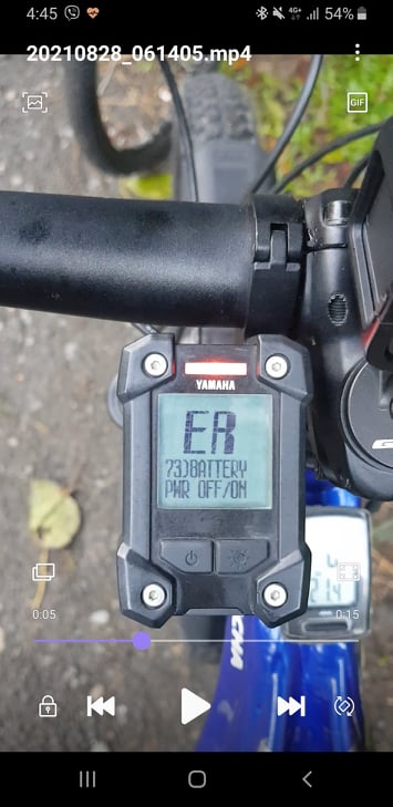

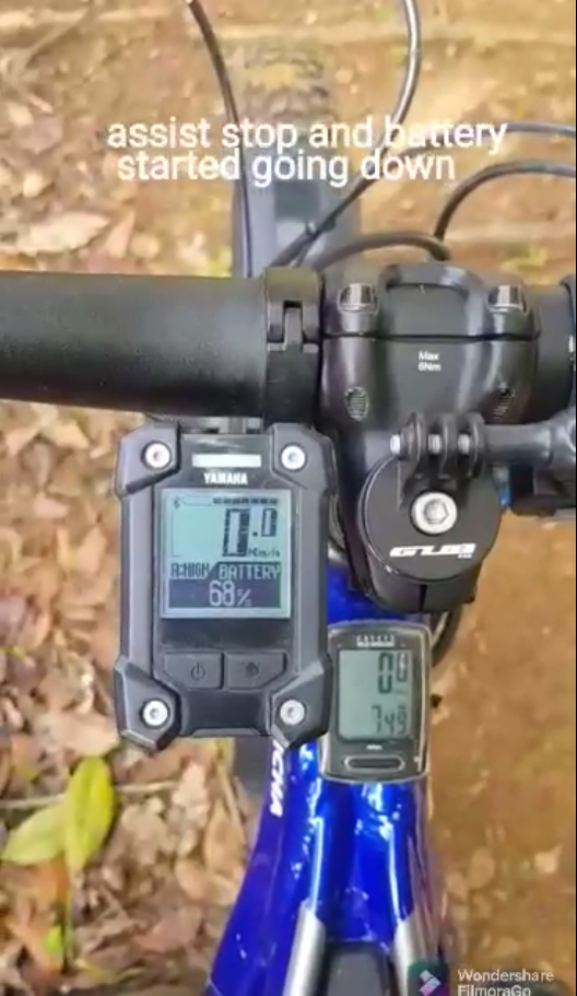

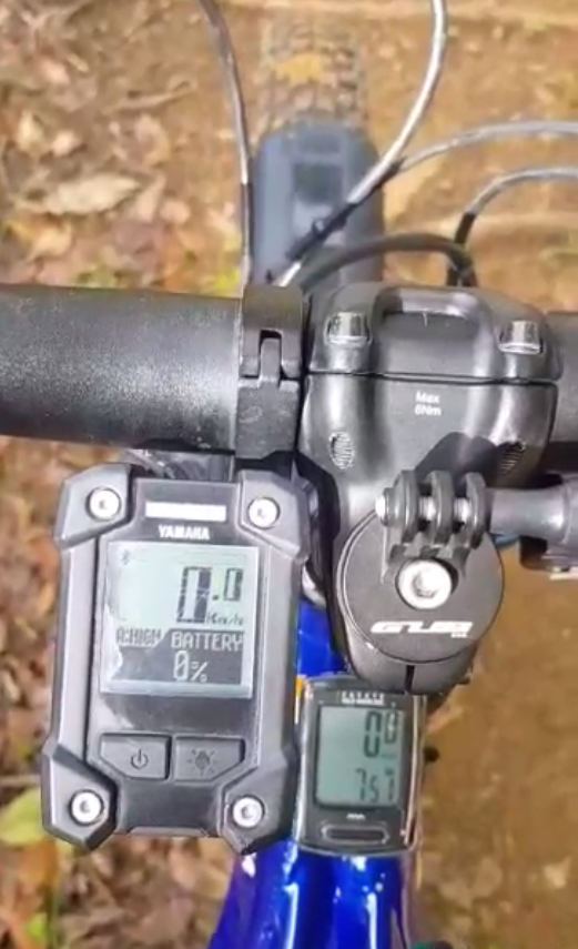

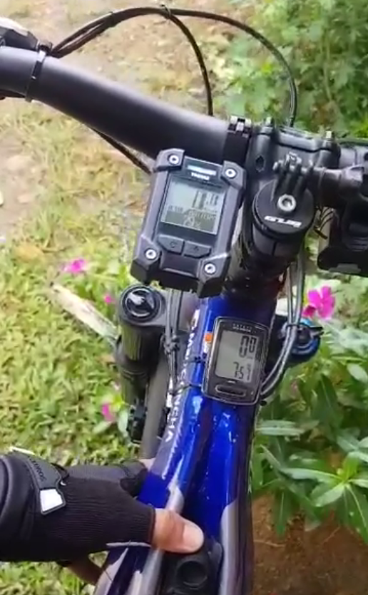

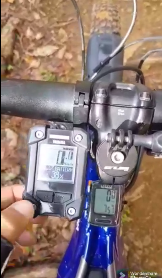

Hi! I bought my Yamaha YDX Moro pro in Japan last October 2020. A few days ago while biking, it started to malfunction. First it registered an error 73 and just turn off by itself. When i switched it back on, again the same thing happened. I tried to change the drive unit from my brother's bike, (same model). Upon testing, it started okay at first but after a few minutes, (+/- 6 minutes) the battery monitor started to drain rapidly (less than 2 minutes from 91% to 0%) and lost all assist. The monitor is still on but the battery shows 0%. When I got home, I charge the battery, and after a few seconds, it came back again to 91%. (jump started the battery). I am sure same problem will happen again since it also happened to my brother's bike. Can anyone please help? Thanks!

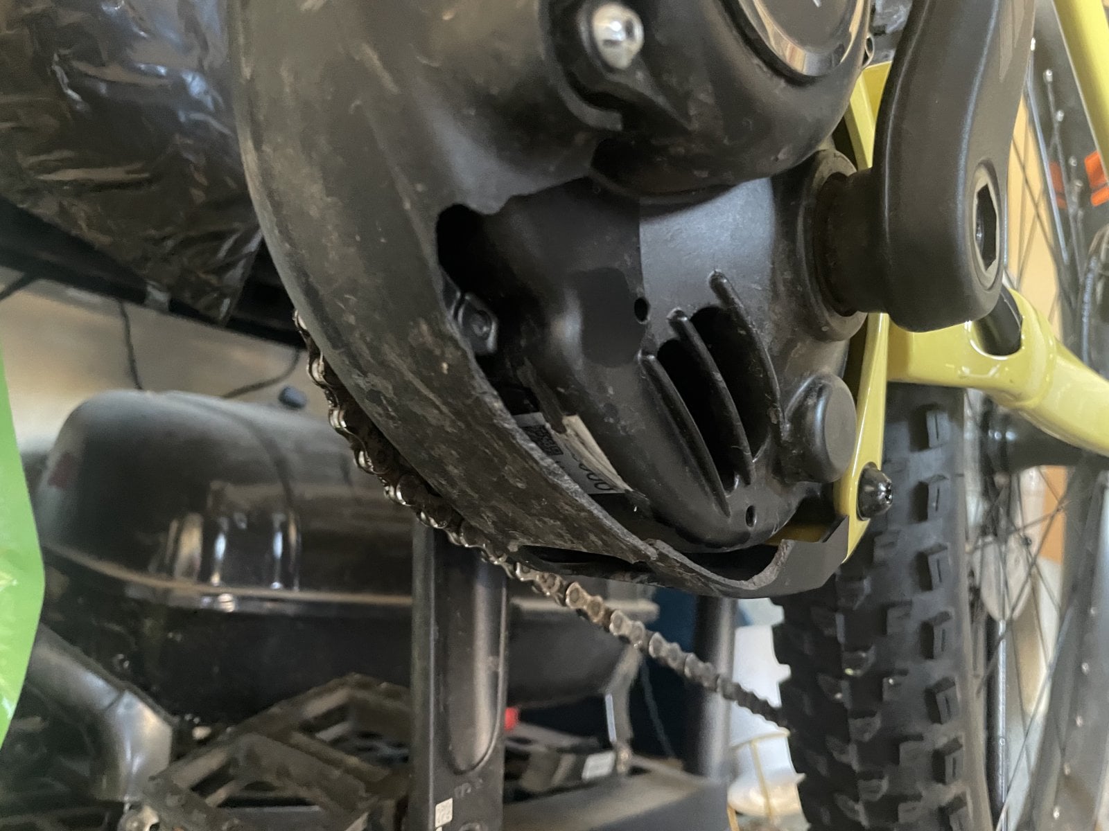

BUT I was - through the chain under load - clipping the crank on the chainstay... Turned out Motor Mount bolts were loosening... LockTite fixed it but not before I lost a bolt during a ride...
Since the replacement and locktite. no issues.... but just saying... be aware.
sounds like your battery connection is bad, did you try taking out your battery then re-seating it?

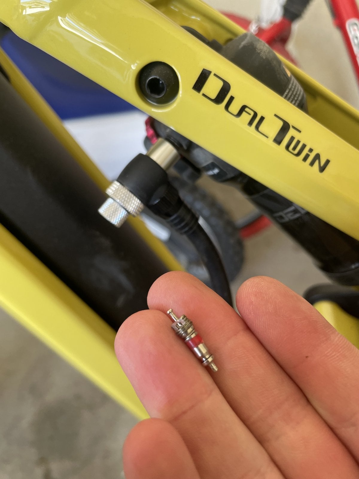

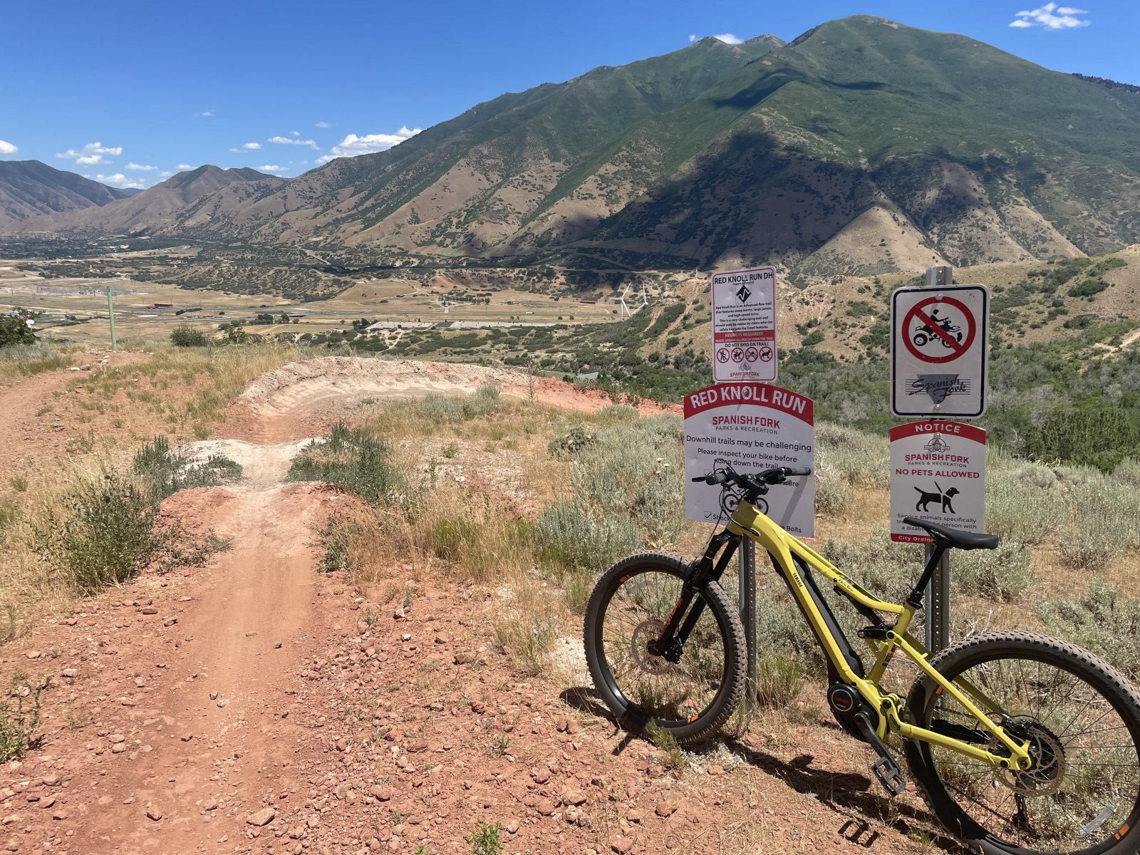

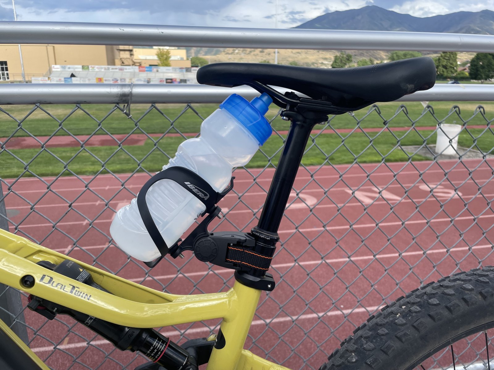

Picked up a moro (non-pro) a few weeks ago, loving this thing so far! Only issue was the shrader valve in the shock was bent/pushed in too far from the factory, so I backed it out and replaced it, this was AFTER I went on a gnarly trail and bashed the engine guard (oops). I assume it was a mix of unlucky/technique plus low pressure in the rear shock.
Also Any fellow owners have a good way to mount up a water bottle?

I have mounted …. With really long Velcro straps… a bottle under the battery and slip and baggie and rubber band over the top. But on road only. Off road. Camelback.

I found two of my motor mount bolts loose (chain ring side) but my wife's was tight. We have the same amount of miles. I'm going to replace the bolts with hex heads and locktite them. We'll see if its better.
