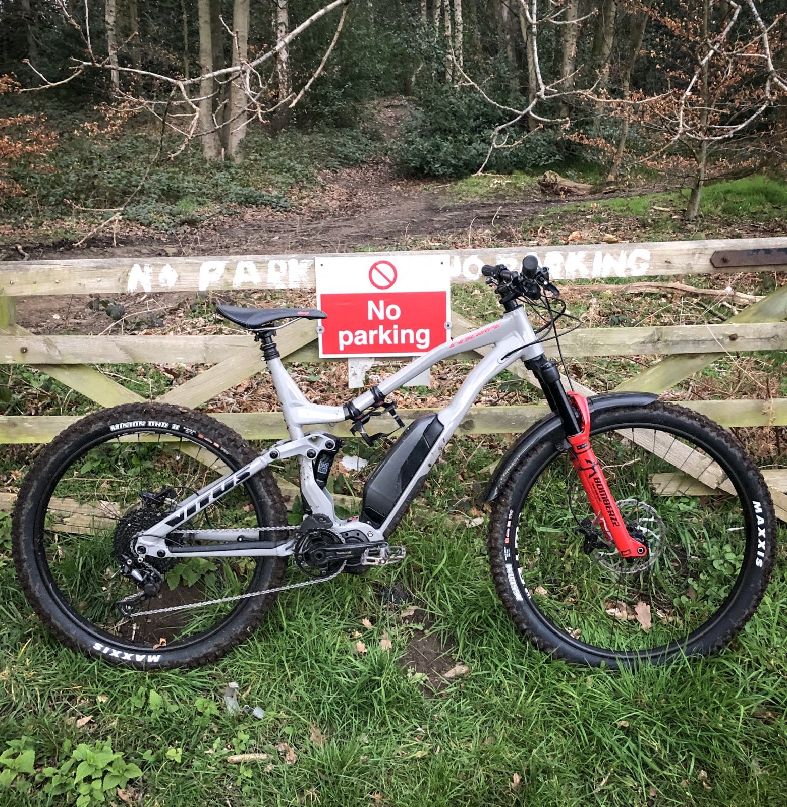

This is mine, XL. Pretty much stock except seatpost (170mm drop was too long), saddle and grips. Also fitted Schwalbe Procore to protect the rims.
EDIT: oh yeah and Deore 4 pot calipers, with original levers/hose as they are the same and saved me dealing with the internal routing faff once i realised :)

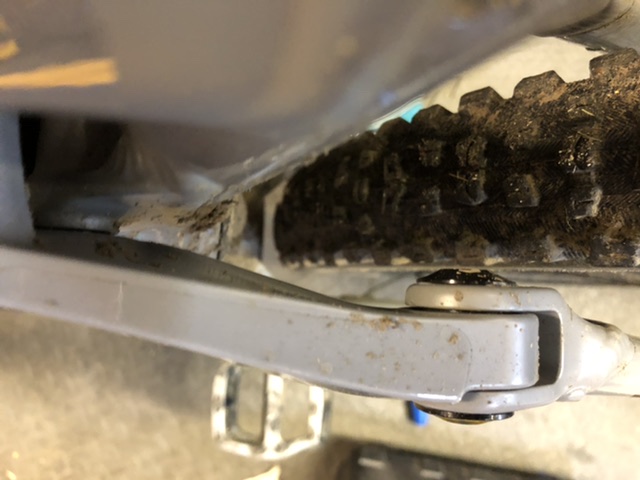

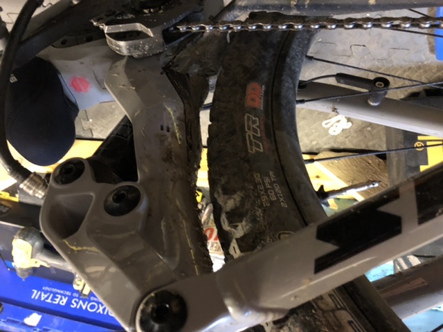

Update: just checked rear end clearance with a 29er. Plenty of room with a 29er 2.3 Maxxis aggressor. On bottom out the 140mm travel of the E-Escapre has no areas even remotely in contact, I’d guess with the extra 30mm of the sommet (same frame and shock length, just more shock stroke) you may have tyre contact.
