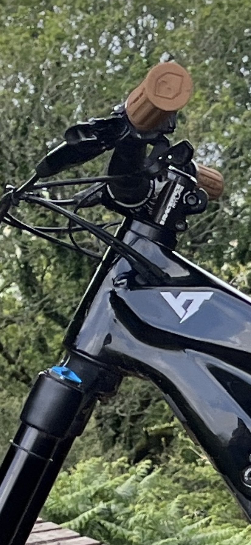

Has anyone managed to run an angler set like the Superstar Slackerizer or Works one in their Decoy? I’m tempted to run my Decoy MX in the high setting but counteract to steepening of the head angle with either an Angleset and/or a Reverse -0.5 angle steerer race or Niner Slacker Puck.
The reason being I want to steepen the seat angle but not the head angle.
Anyone had any luck? I might just not bother if it’s too much of an arse to do as I’m aware there might be clearance issues with the fork and downtube.

@Chrysaor did you have any problems with the fork clearing the downtube as I know that’s the point of the Knock Block headset? It’s hard to tell if it’ll clear or if an external lower headset cup will be enough to clear it.
Don’t have any photos of how much clearance the forks have?

I was on the XL Decoy 29, plenty of room for the Fox36 grip2 and later on a Manitou Mezzer
Cheers, I think I have about 4-5mm clearance but nowhere near as much as you. I think an external headset cup will sort it
