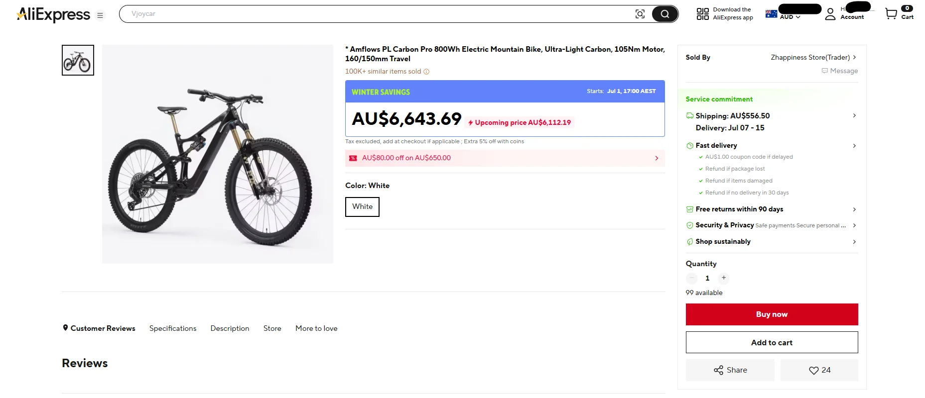

Listen. I post this as a warning to others. I buy from Aliexpress all the time. But here is an Amflow PL Carbon Pro being sold at less than AUD$7K, that I could buy right now.
But there is zero chance what will turn up, will be an Amflow PL Carbon Pro with full warranty from Amflow. You'd have to screws loose to think it was. You'd be lucky if it was even was an Amflow. It says it's white. The PL doesn't come in white.
Now I don't know where these sites are getting these bikes. But there has to be an ounce of common sense. The internet is not policed worldwide. Anyone can sell anything. And the original manufacturer can't be held responsible, if someone buys their product from whatever source in China, and sells it cheap on the internet.

Not where you go to buy $10k e-bikes for $6k and expecting a warranty to go smoothly.
You might not know, but the Amflow PL actually costs that much in China. It's even cheaper – less than 37,000 yuan. And that's the official price.

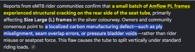

There are 120 people in our small local community. Seven or eight of them have a crack problem. Yes, it's a "small" batch )))

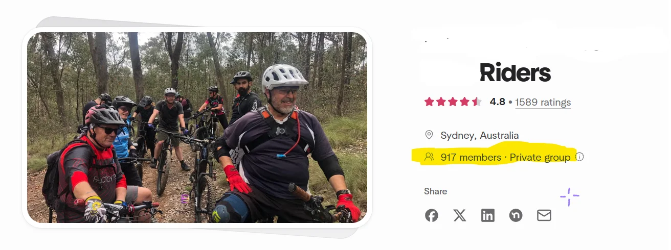

There's 917 in my MTB community and zero have crack issues. And secondly. How about you come clean with where all these bikes were bought. Are you Ron Hack ?
And lastly. Are you trying to claim that 7% of Amflow PL's cracked at the seat tube ? Surely if this was the case, there would be an uproar from the public. And there's no such thing.

Right now, it's just a small batch of carbon frames that are cracking; the bike hasn't been on the market that long, and the ravages of time are taking their toll on the others as well. What if there are more and more of them? Then it won't matter where they came from. Amflow could be in for some serious trouble.
That's almost 6% in this group alone. Any defect rate over 2–3% is generally considered poor for a consumer product.
