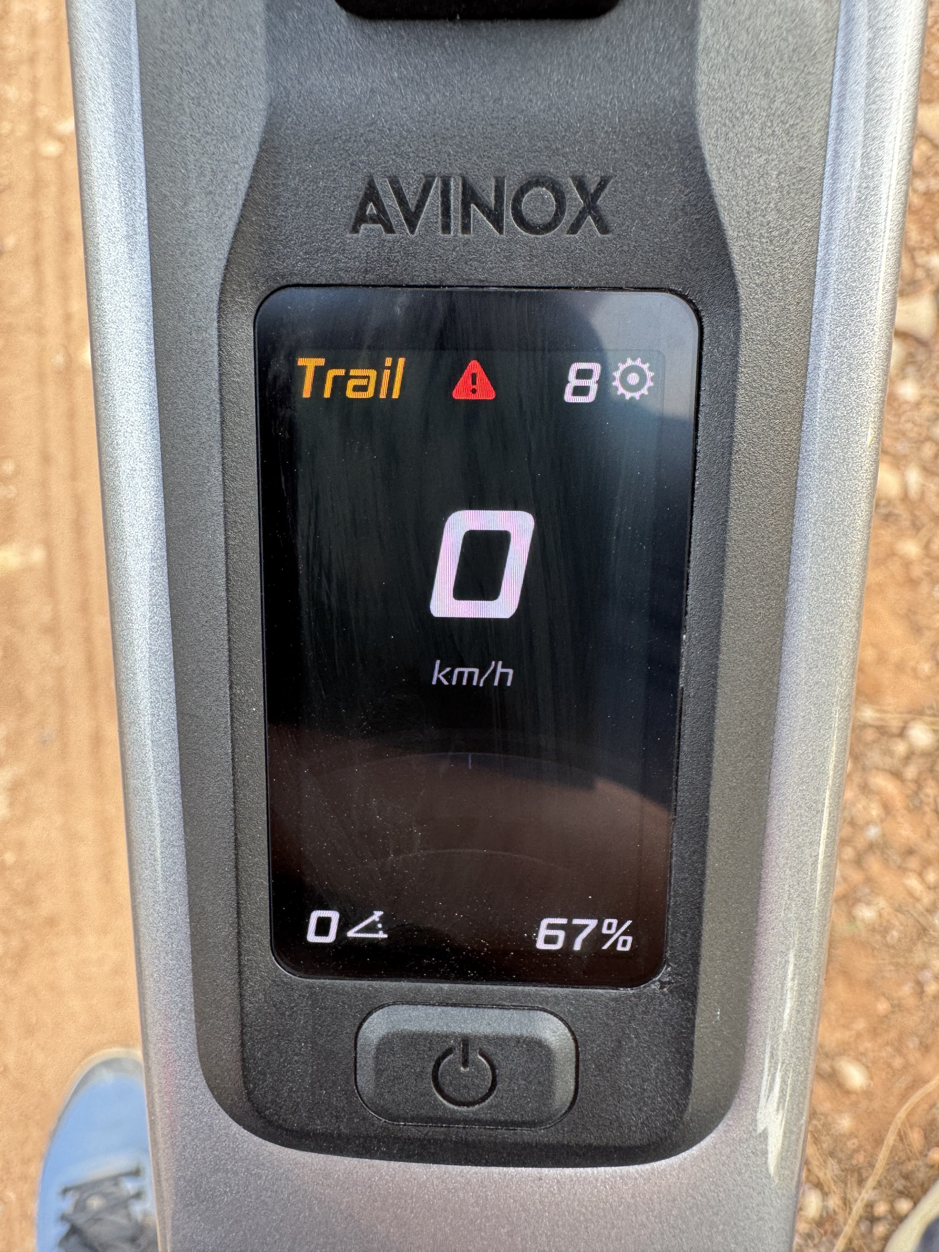

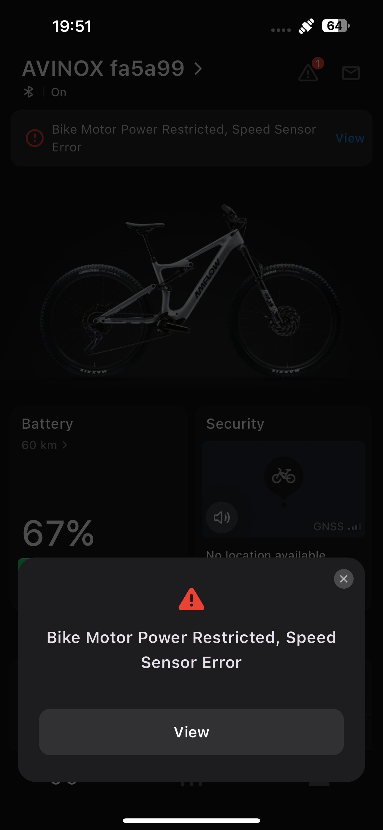

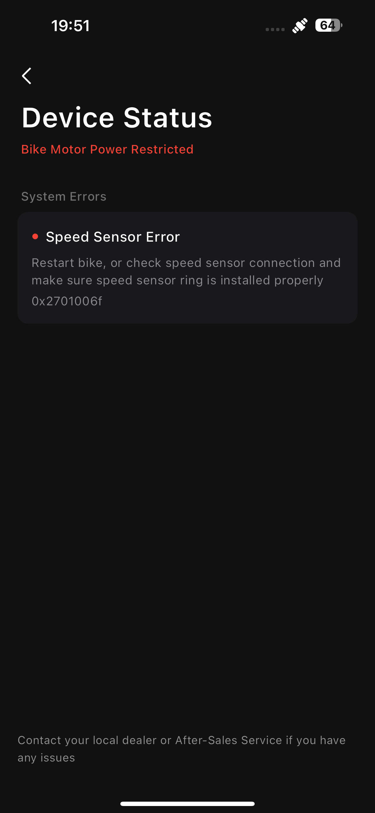

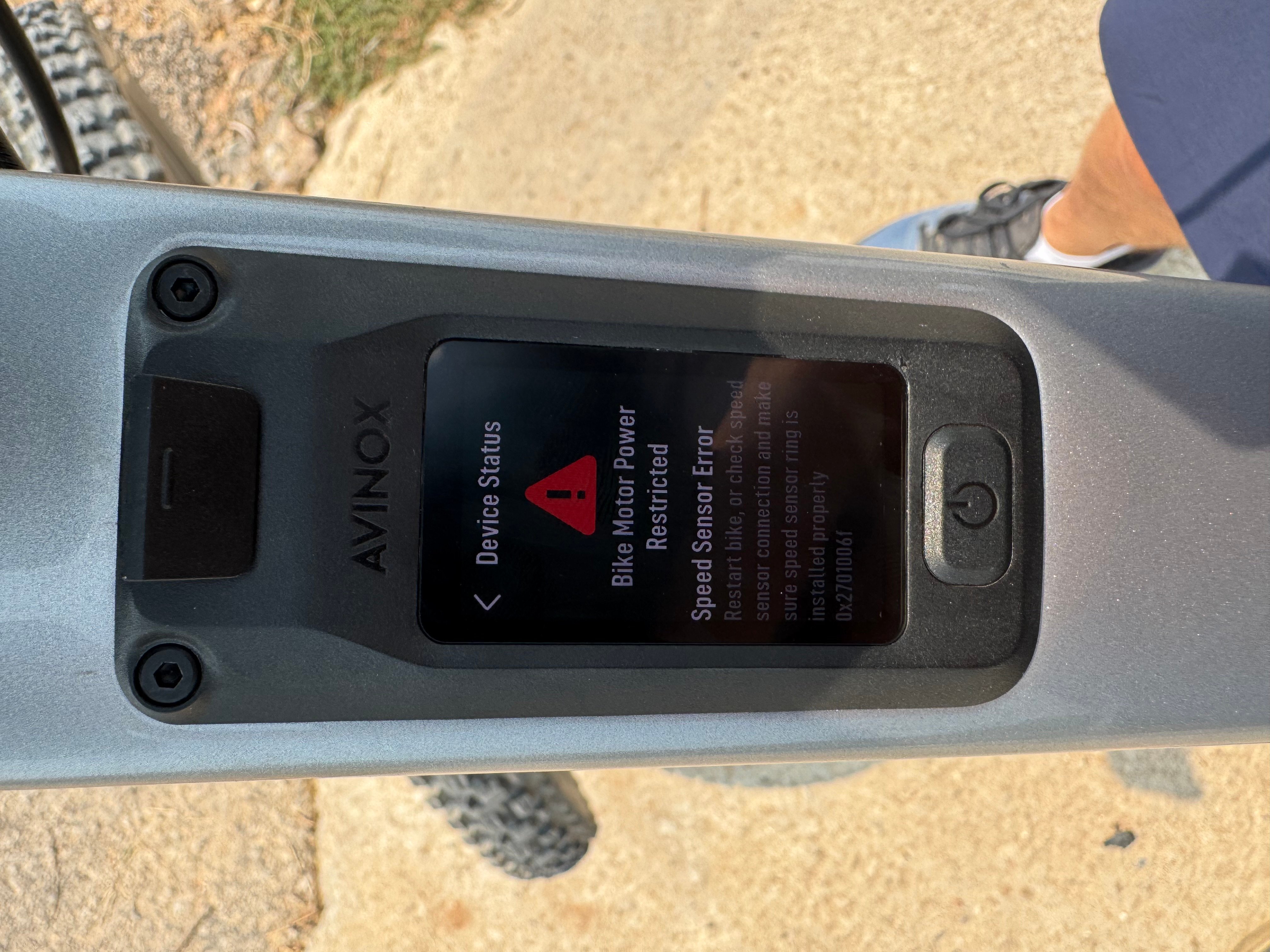

Amflow: Bike power motor restricted, Speed sensor error

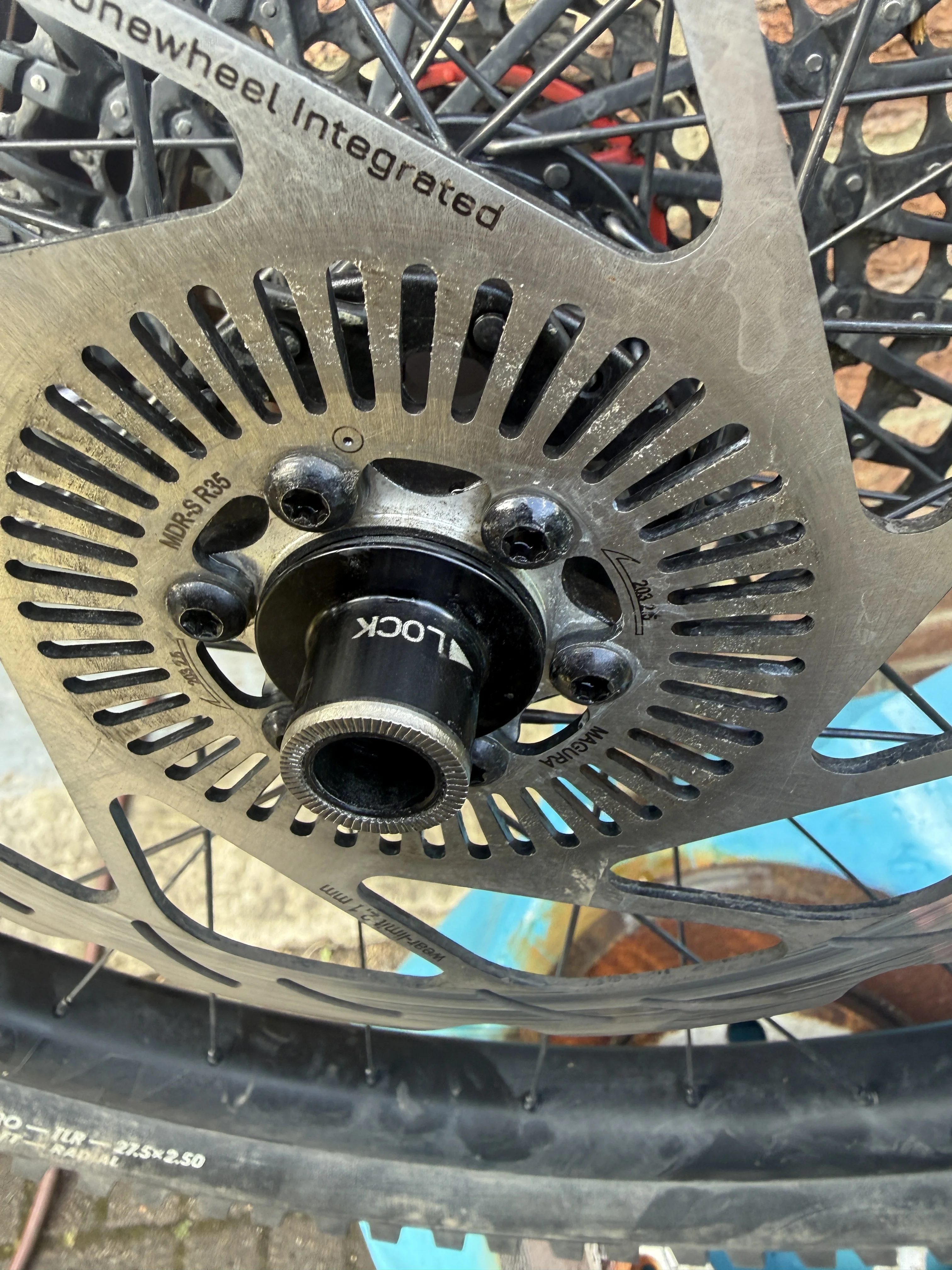

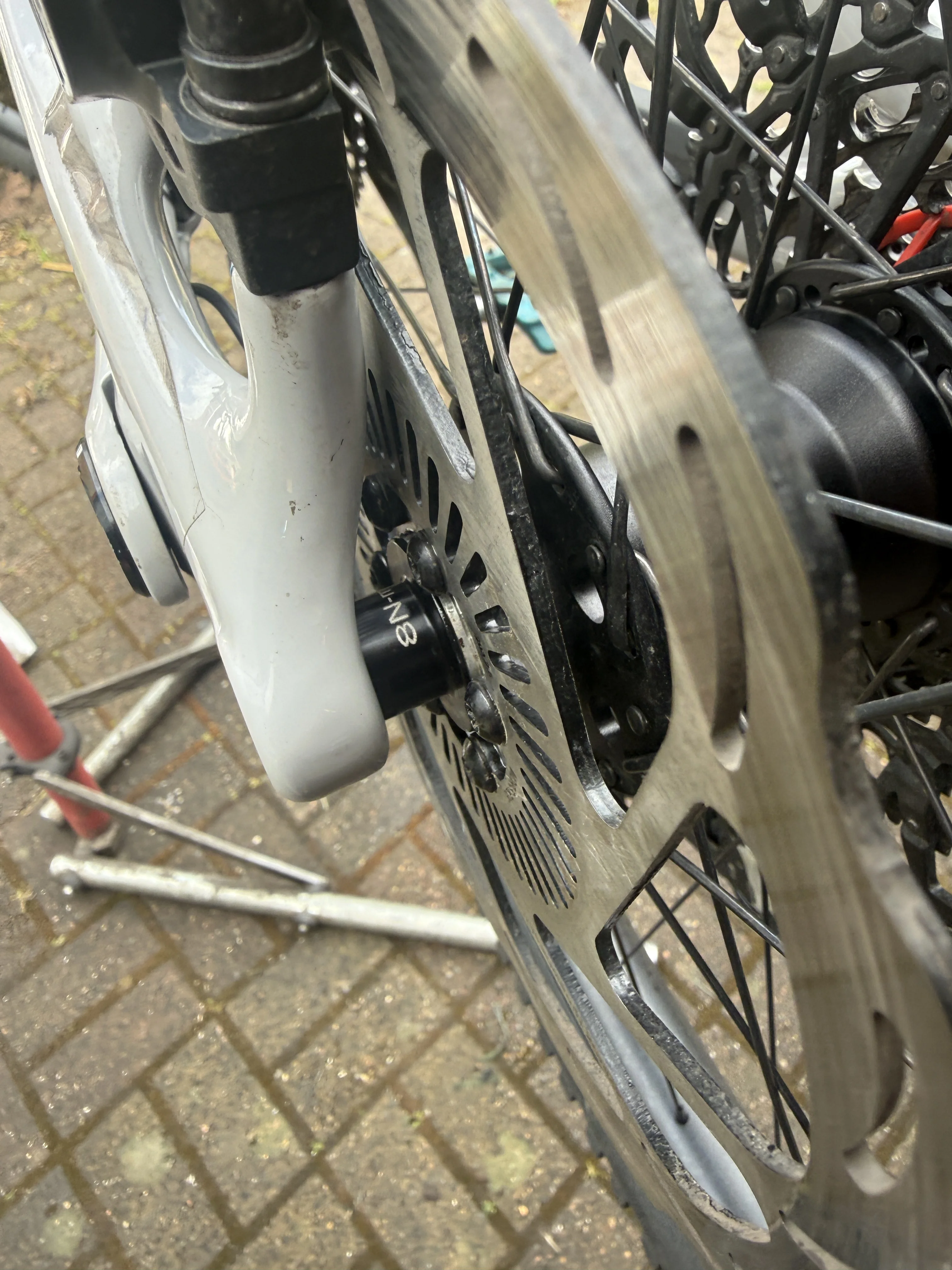

My Problem was solved by mounting 1 mm spacers between signal disc and brake disc to narrow the distance to speed sensor. Obviously this tolerance is quite crucial, running a different wheel with slightly different disc position can cause this issue. Should be mentioned in the manual imho.

I will second the spacer fix. Avinox states the clearance for the sensor to ring should be 1-3mm. I have Magura two piece rotors, which have a pretty thick mounting point, but I started getting this error on my third ride on my new Crestline 181.2. I looked at the gap, and it looked to be maybe 2-2.5 mm. I picked up some stainless steel 5mm bolt washers, which are approximately 1mm think. Mounted them between the rotor and the sensor ring. While I only have one ride on this fix, it appears to have done the trick. The gap to the ring looks to be pretty close to 1mm, didn't actually measure it as it's hard to get a gapping measurement tool in there. Will update if it reappears.
