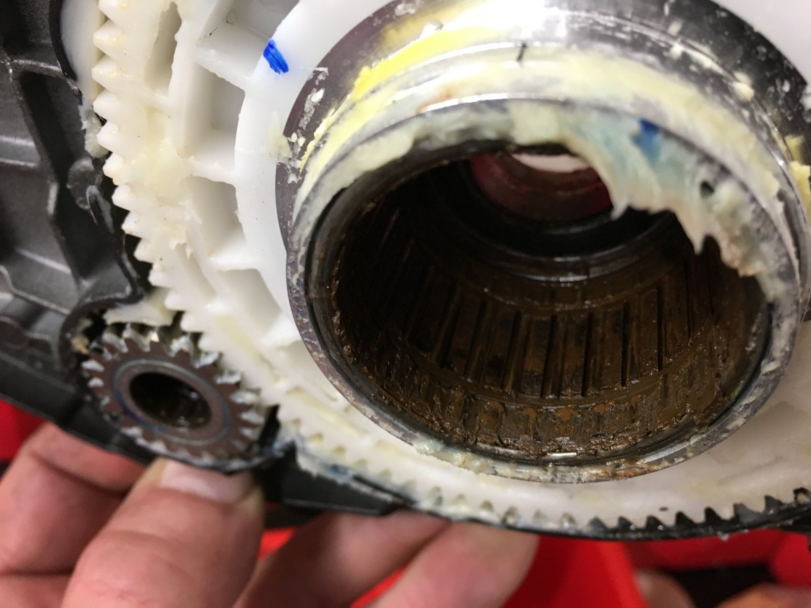

That part is the freewheel gear and it fits into the large clutch bearing. You can put your fingers on it but any grit or dirt what so ever could badly damage the bearing surface, hence, best not to touch it.
A clutch bearing needs to grip the bearing surface it runs on when it needs to lock the drive. If a high pressure or Teflon grease it may slip or judder (both scenarios are bad). If an abrasive grease like Graphite or Moly grease is used it may also slip and may contaminate plastic gearing.
There is normally always enough grease left in the bearing to "go again". If not? then a suitable grease like the one we use should be applied.

Thanks, I’ve just looked up what clutch bearings are and how they work. They seems to have lots of tiny springs which facilitate the grabbing effect when the shaft tries to rotate in the reverse direction. Clever stuff!
So is this clutch bearing what you refer to as the “main motor bearing” and the one in the direct firing line of water and mud ingress?

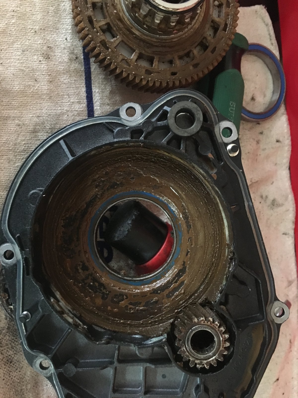

No, the main motor bearing is the relatively large bearing that supports the aluminium sprocket carrier and the large plastic drive gear behind the cover. The clutch bearing can be affected when water gets through the right-hand crankshaft bearing.
The blue bearing in the case below is the main motor bearing and the rusty thing in the white drive gear is the clutch bearing. The gear below that is the freewheel gear after water has entered the motor.

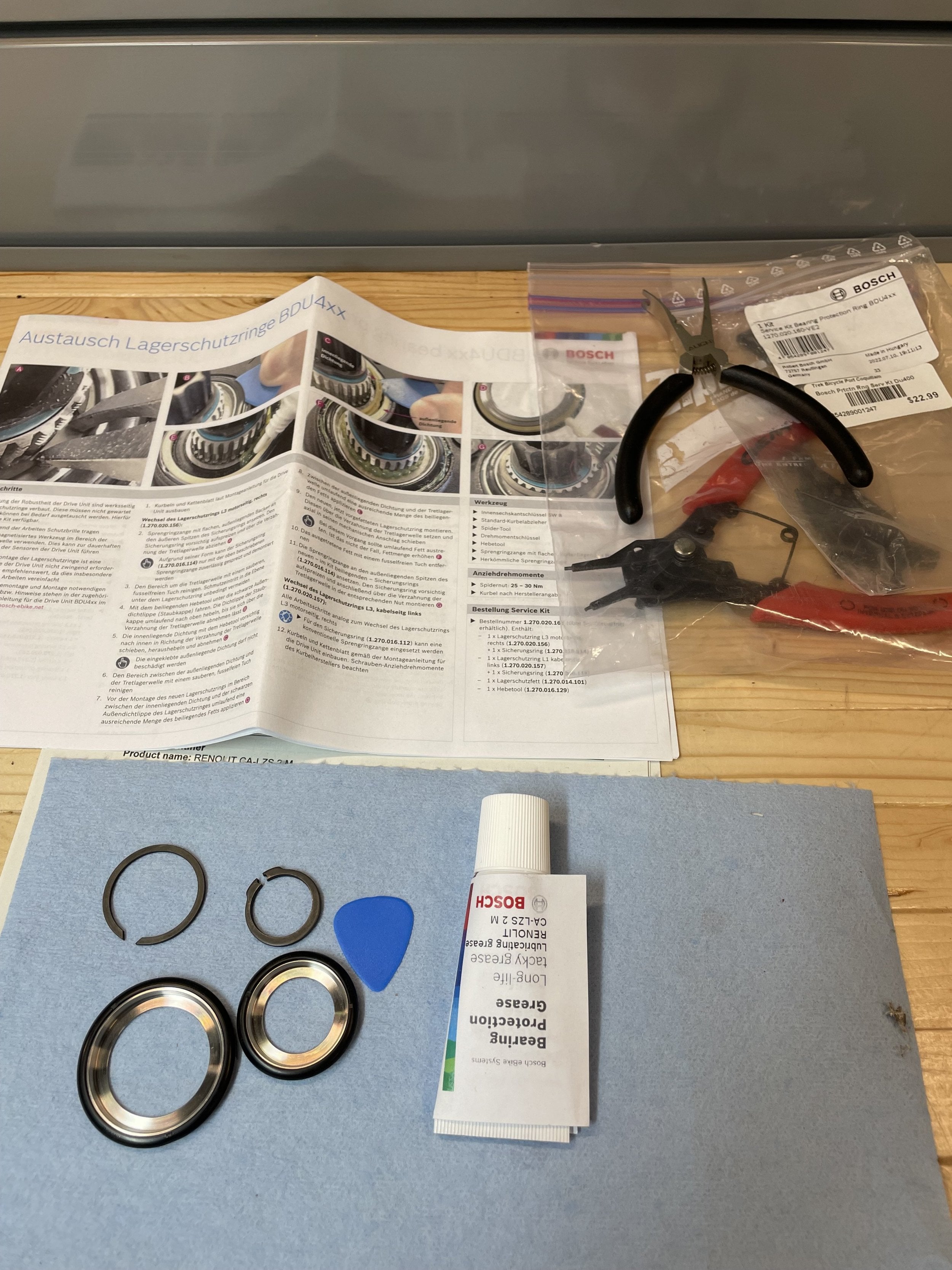

I’ve borrowed this image from a post by Stihldog in the following thread by Rusty MTB;
Bosch Gen4 Seal Service & Grease up
You can see the Bosch Tube of Grease has the details of the manufacturer on it.
RENOLIT CA-LZS 2 M
I had difficulty finding that for sale in the UK.
But the classification is KP2K-30

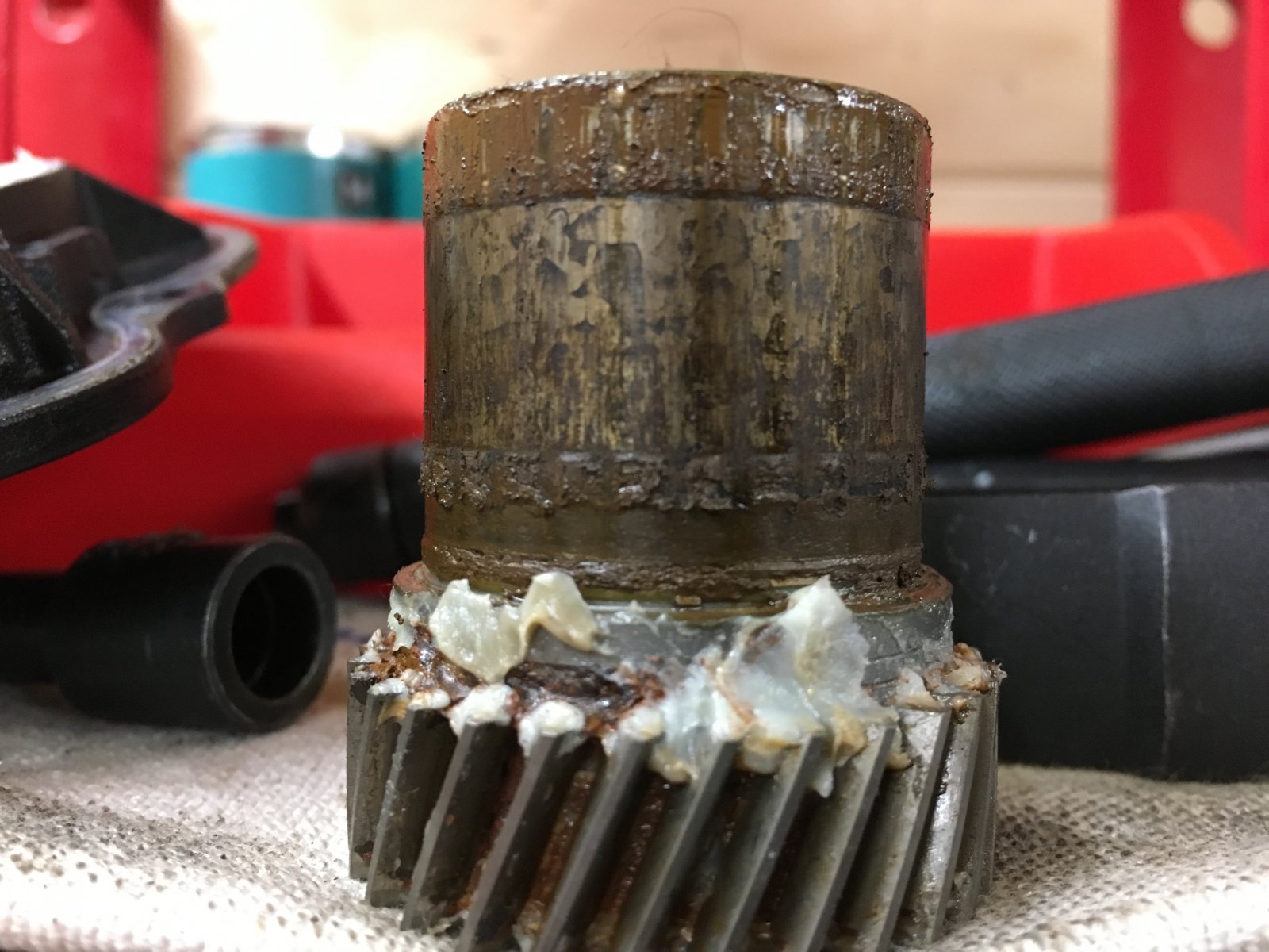

@Bearing Man Hi, Thanksin advance for your help.
I had to lightly clean the freewheel gear and the bearing. Can I apply the same 'Bosch Drive Unit Grease' here? Does this grease go on all parts of CX Gen 2(Plastic-Plastic, Plastic-Metal & Metal-Metal)?
The Bosch motor grease is not the correct grease for the clutch bearing, but it will do the job. And yes, the Bosch grease is good for all gears in the Gen 2 motor.
Just a quick update for anyone reading this thread. Bosch have now released a new type of grease for the bearing seal. It's the same price but half the size! Hopefully it's twice as good (y)
Available here: Bosch bearing seal grease -
