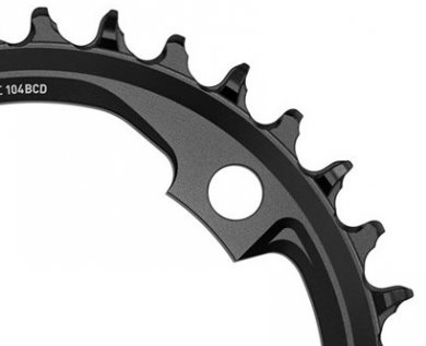

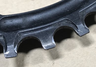

I've had the same issue, took a while to identify it.
See attached video.
Turned out to be the chainring grabbing the inner plates of the chain where the metal at swaged over the tooth, the teeth don't have the classic hooked appearance but closer inspection showed the wear.
Terrible grinding sound amplified by the plastic motor covers.
Replaced with a SRAM Eagle which has lots of relief on the trailing side of the teeth.
See attached video.
