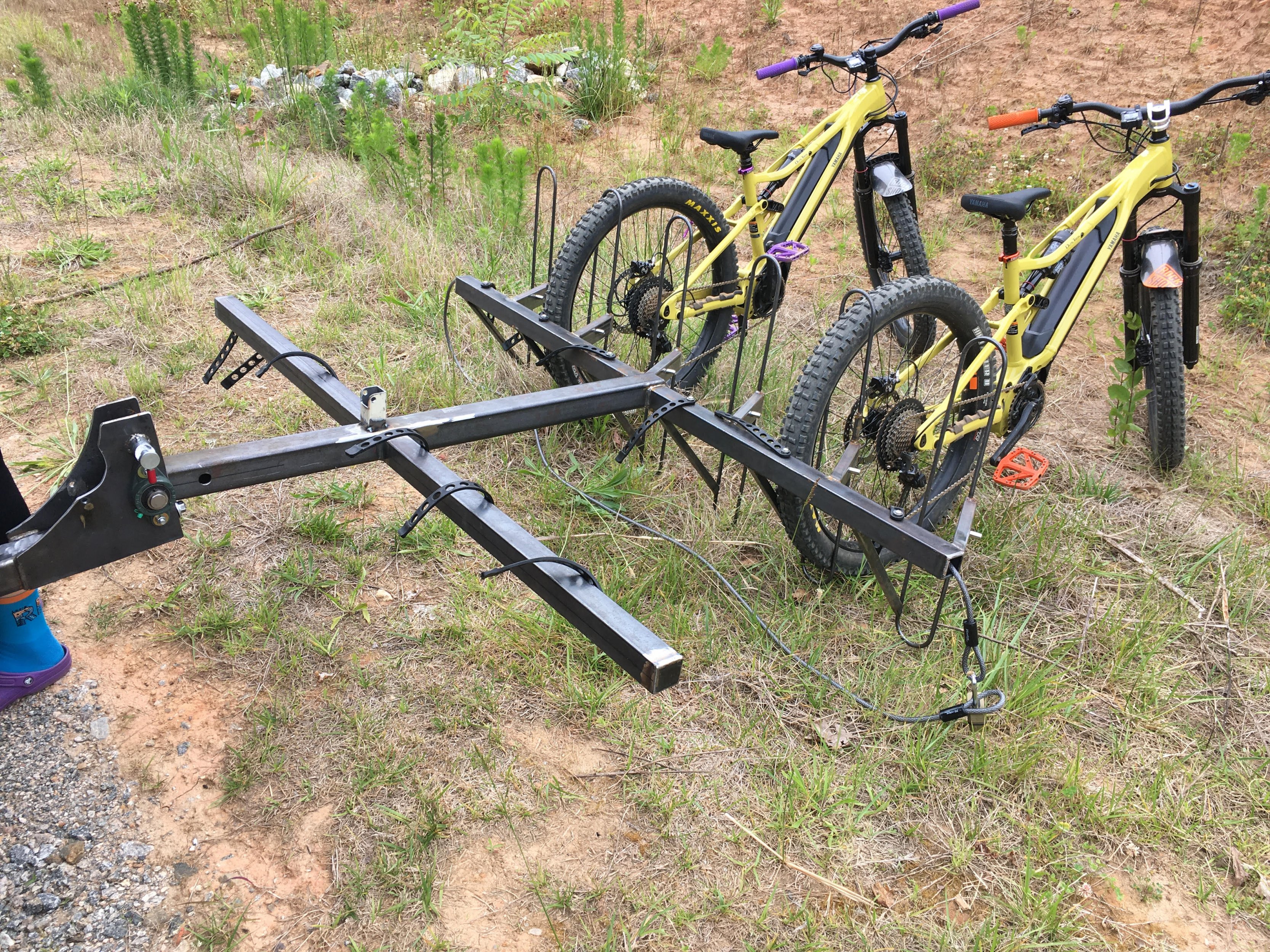

In my instance it was developing a vertical bike rack.
I built a vertical bike rack also! I wanted to make it work with an electric actuator to raise and lower remotely but never could get that worked out. Wound up giving up on the idea. This rack has went 1000's of miles and been trouble free. It was an interesting and stressful project. I haven't made another one, but now that I have an AC tig welder I'm interested in making an aluminum one.
This is it in the testing phase.
