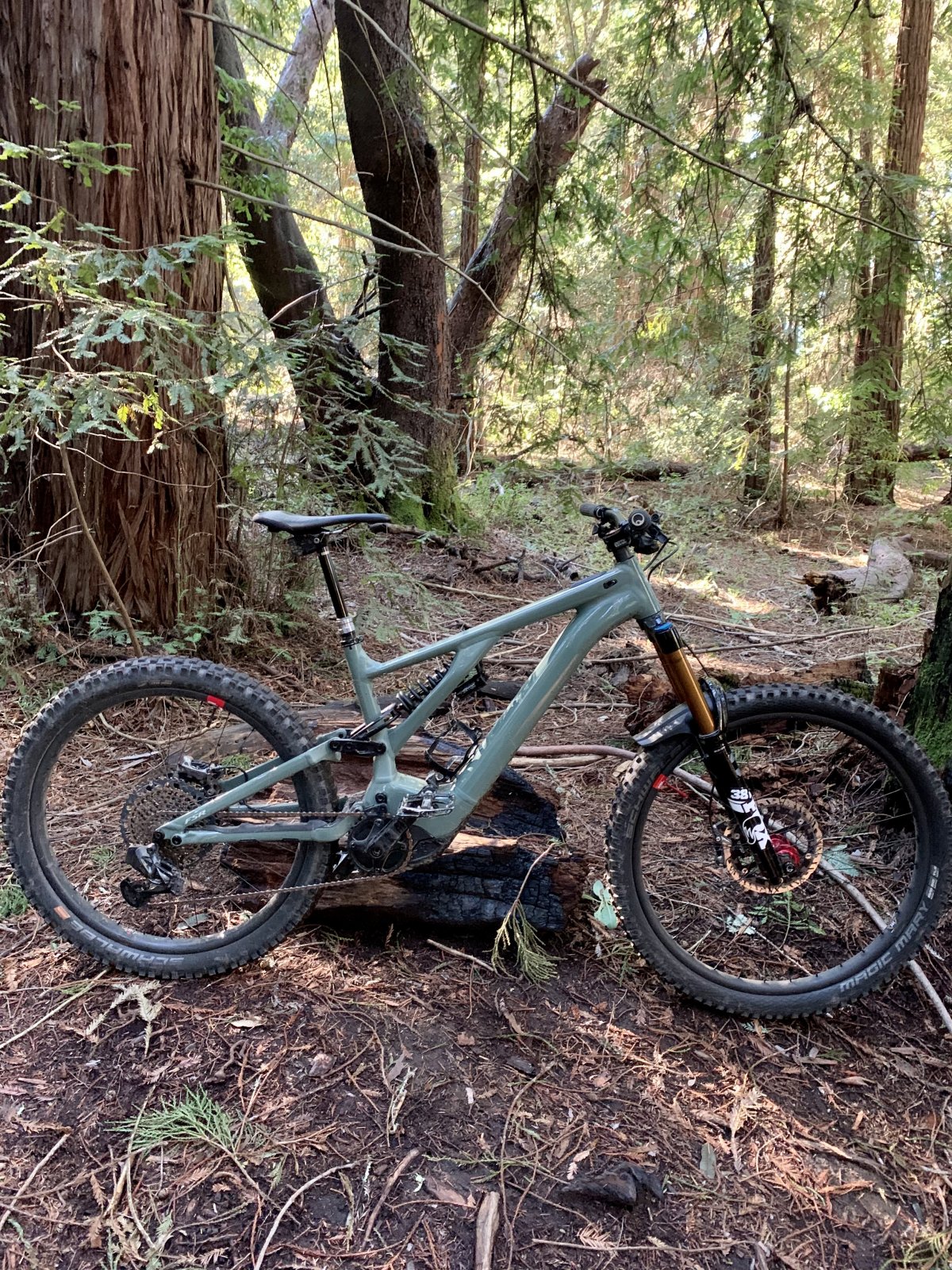

Bumped up the fork travel to 180mm on mullet set up
I was afraid steering would get worse but to my surprise it’s way better
I rode is on some tight flow trails yesterday with the flip chip on high. It performed awesome

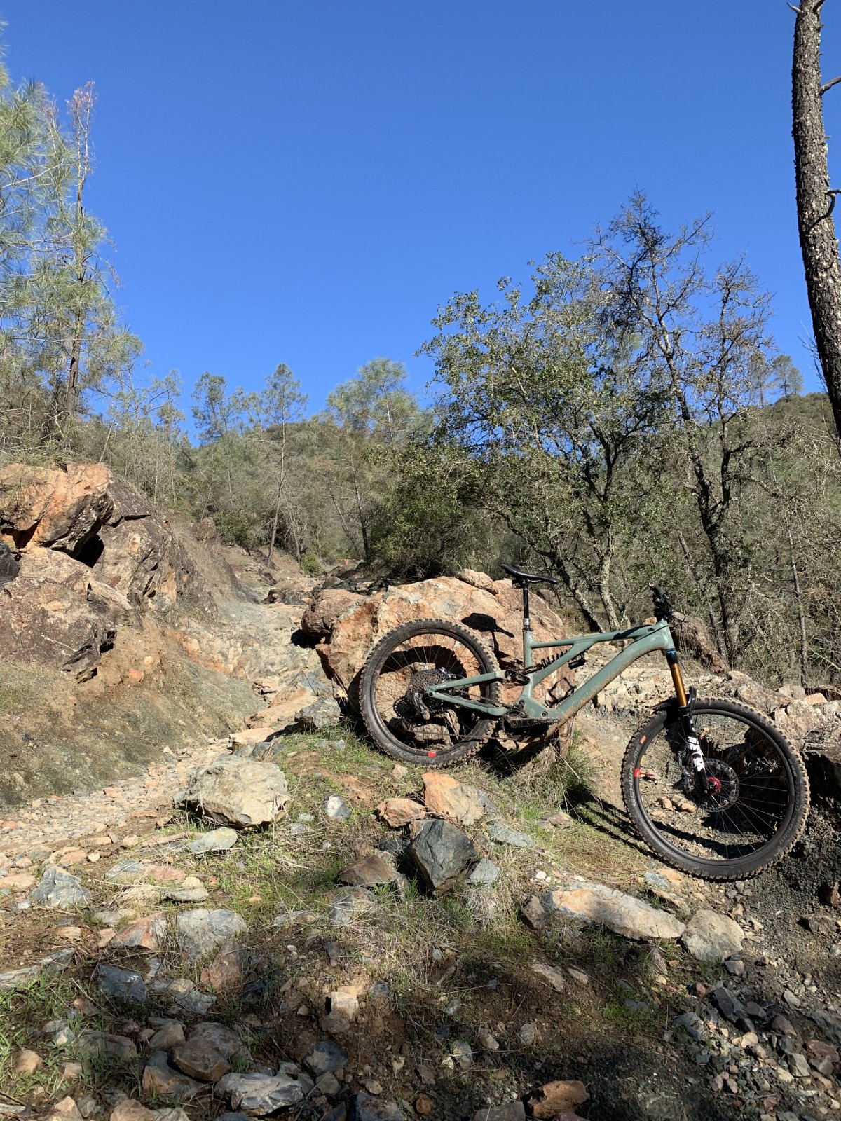

Rode today on steep tech with the flip chip on low and it was awesome too
Now i have to decide which to go with
tomorrow’s ride will have flow, chunky, steep and jumps. I’ll keep it on low and see how it goes. Bringing 1400wh’s with me. Turbo all the way!

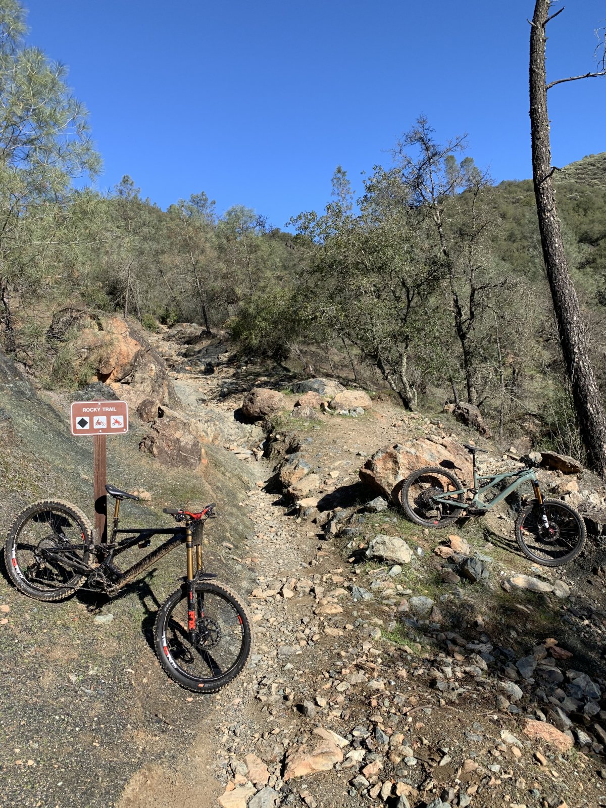

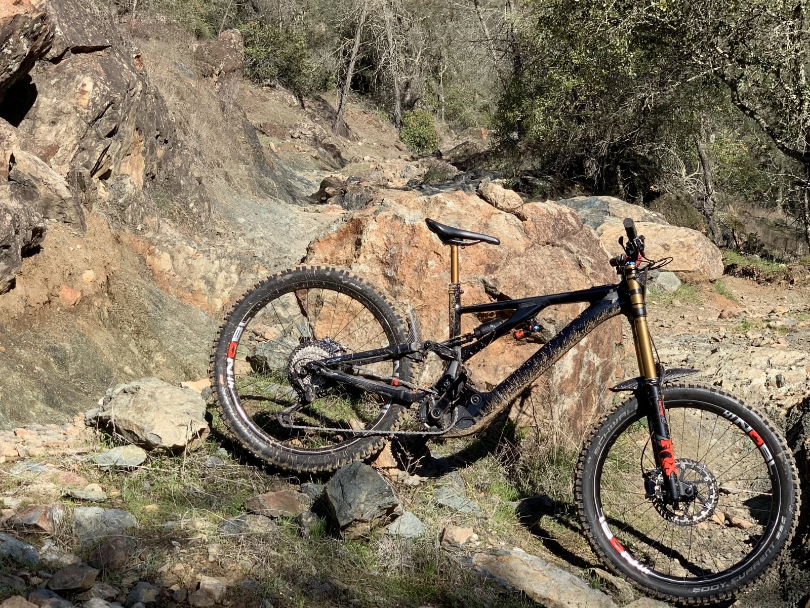

Battery bashguard bashed against a rock on this rocky trail called rocky trail

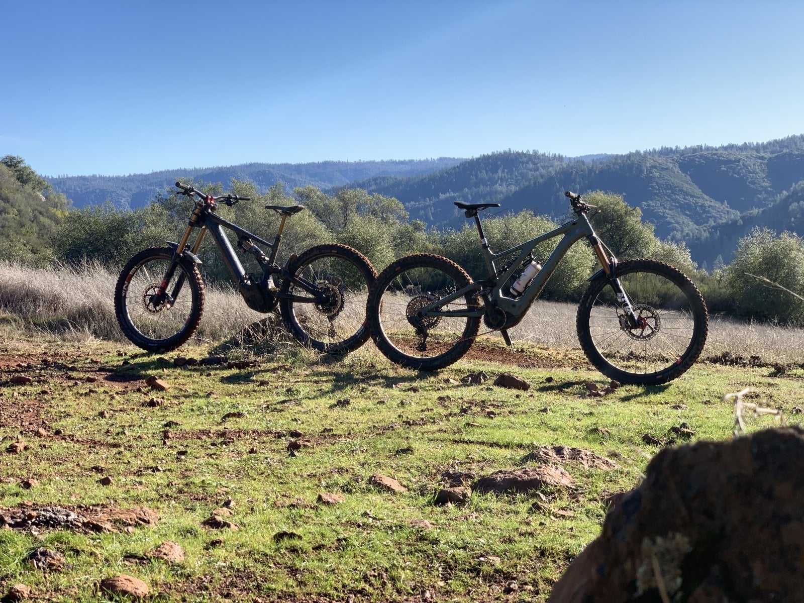

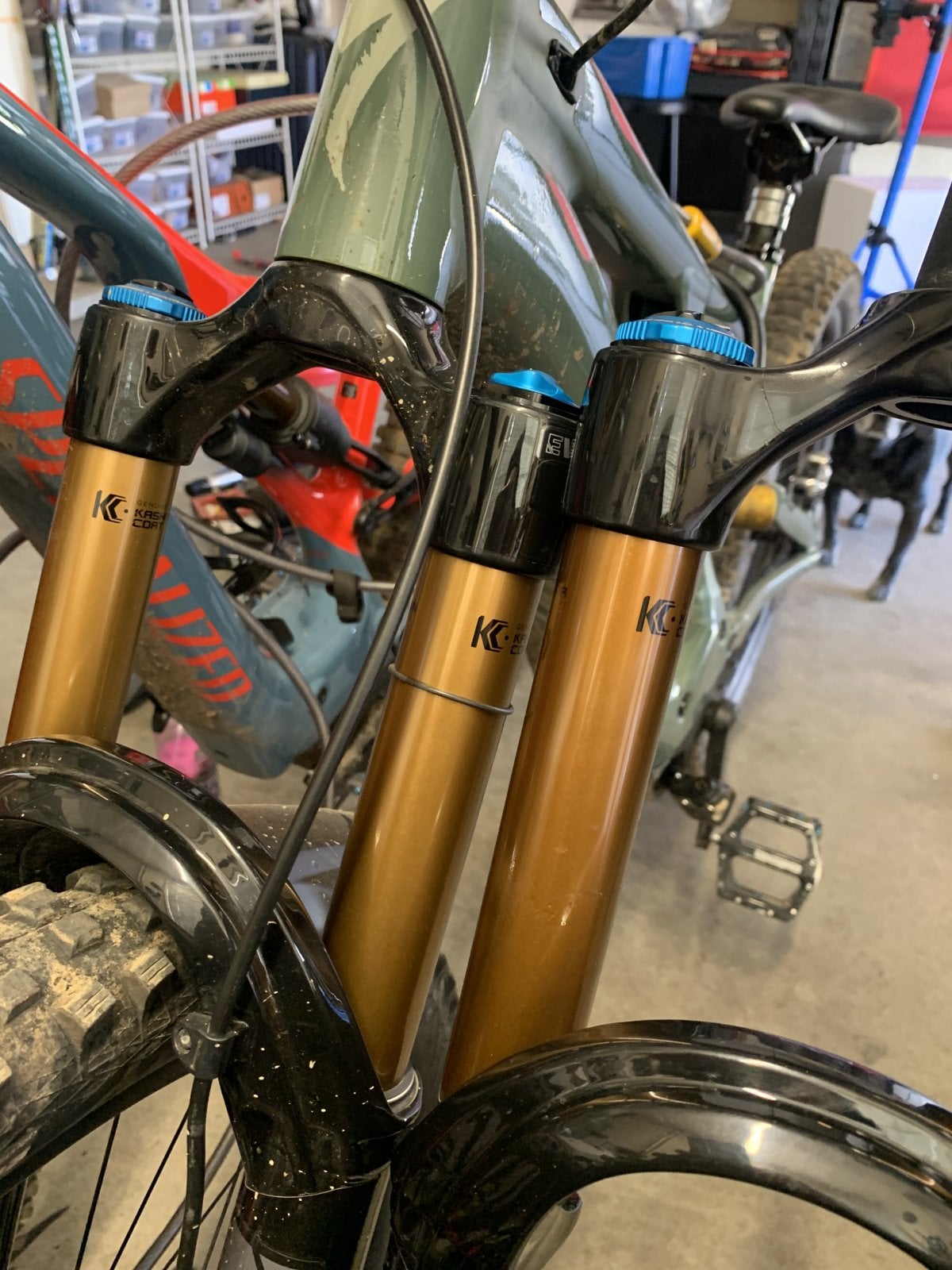

I do like the 180mm better than the 170mm
Pic below shows both 170 180 side by side

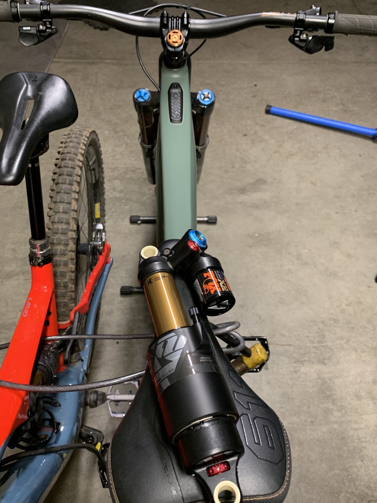

I went with a 65mm stroke on the shock only because I already installed one on my buddies Kenevo and saw no clearance issues
So i said heck why not more travel
Sweet, thanks for the response. Yeah, I‘m leaning towards 180 and the bigger X2. What size frames have you tested the X2 in? I‘ve got an S3 and am worried about rub from the canister.

the black pictured is an s3. no rub on 2021 x2
mine is an s4

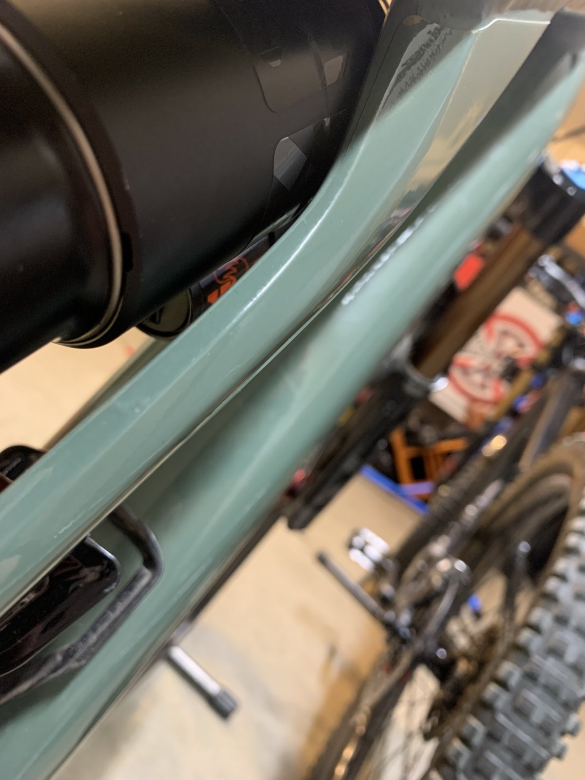

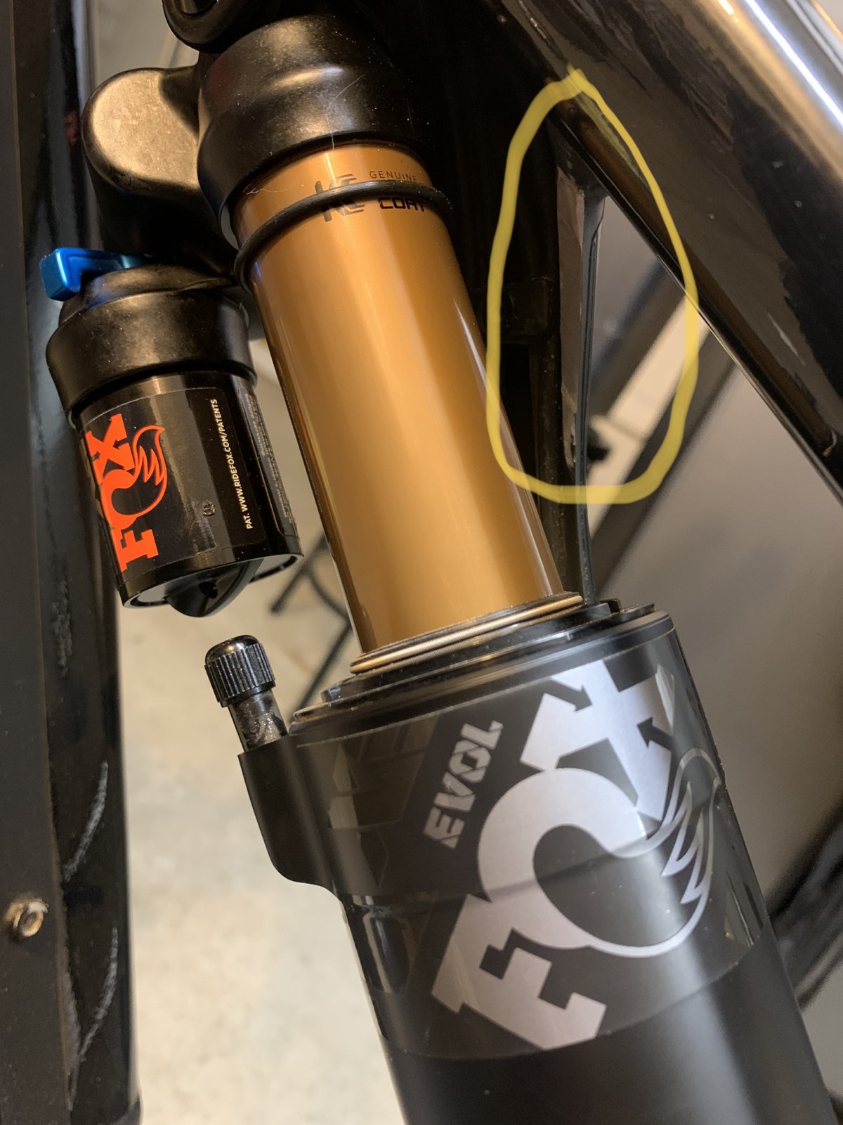

I stand corrected
I stand corrected, i was curious to see if there was actual rub so we took all the air out and fully compressed the shock. It turns out the canister does rub at bottom out. We didn’t notice before because I guess we didn’t fully compress the shock completely
this is for the s3 with 230x65
My friend had to file the frame to clear
He filed a good amount off
sorry for the wrong info earlier
my x2 is a 57.5 and i just sent it in to fox to restroke to 65mm
I will call them first thing tomorrow to maybe go 62.5mm
I stand corrected
Thanks for corrected info (y)
No rub on the S4 but it is really really close
I was able to slide a card through to make sure the shock is not rubbing
I may file a little bit if i really have to. Not sure yet
I’m concerned it may rub if there is flex

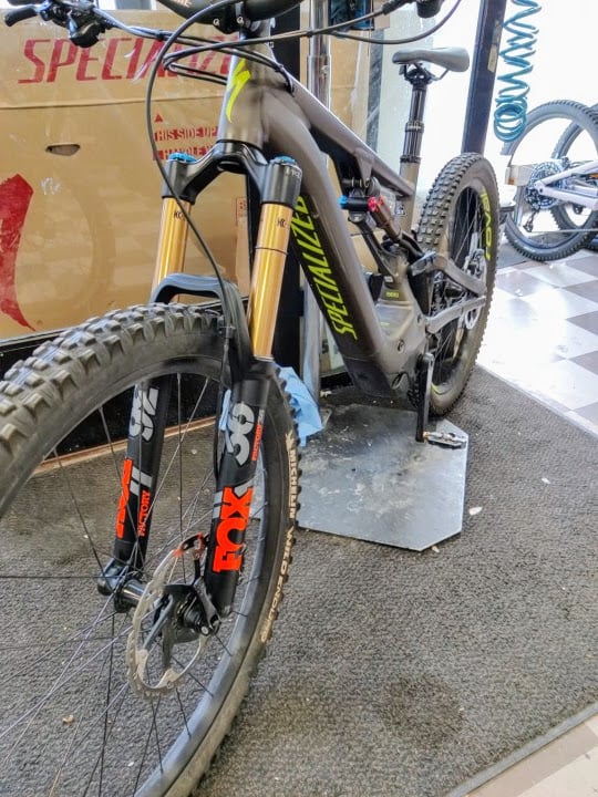

Finally got change to install new fork and shock. Fox Factory 36 170mm and DPX2. Flip chip high mode, front 29 and rear 27,5.
In the summer I will then test rear 29 and flip chip low.
