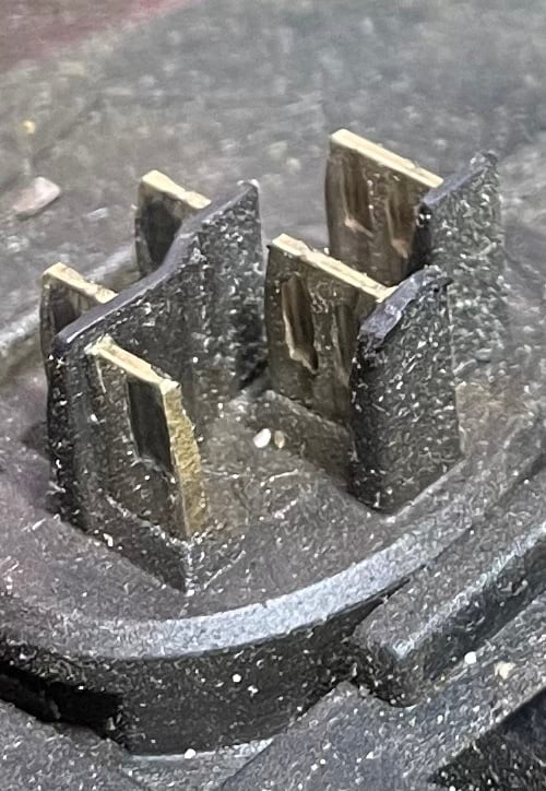

If you connector looks like this , Replace it

I think @Orangie ’s description is the most plausible for this vibration-cutout-issue. The battery rattling is probably adding to the premature wear of the connections.

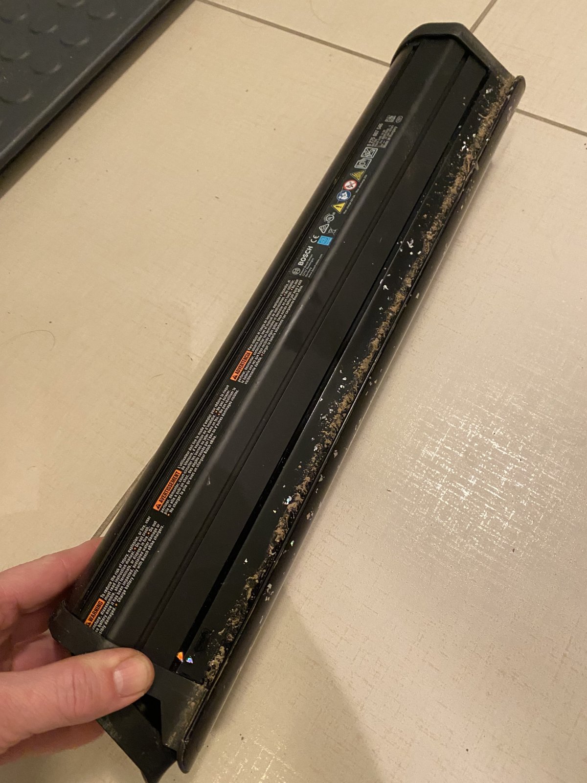

How much crap do you find inside your battery seal after a ride? Just wondering if this some how shows the battery is moving around too much (letting dirt in) and causing the cut outs?
Hmmm? My battery looks the same when I remove it every 3rd or 5th ride. There’s usually no debris or water at the electrical connections either.
It seems there’s not a perfect seal in the battery compartment area but as long as I stopped hearing the battery rattling (pieces of foam) a loose or worn out electrical connection could be the culprit.
I haven’t had my battery pop out on the trail but my neighbor has…once, but he doesn’t have the cutout issue I sometimes get. I usually peddle through the assistant cutoff which only lasts for 5-20 seconds, but it’s on a relatively flat and bumpy section of access road. And what’s weird is that it’s usually the same stretch of bumpy road. (Super natural forces in effect here.) (I’m having some crazy theories 😱).

FYI there is never dirt or debris by the contacts.
