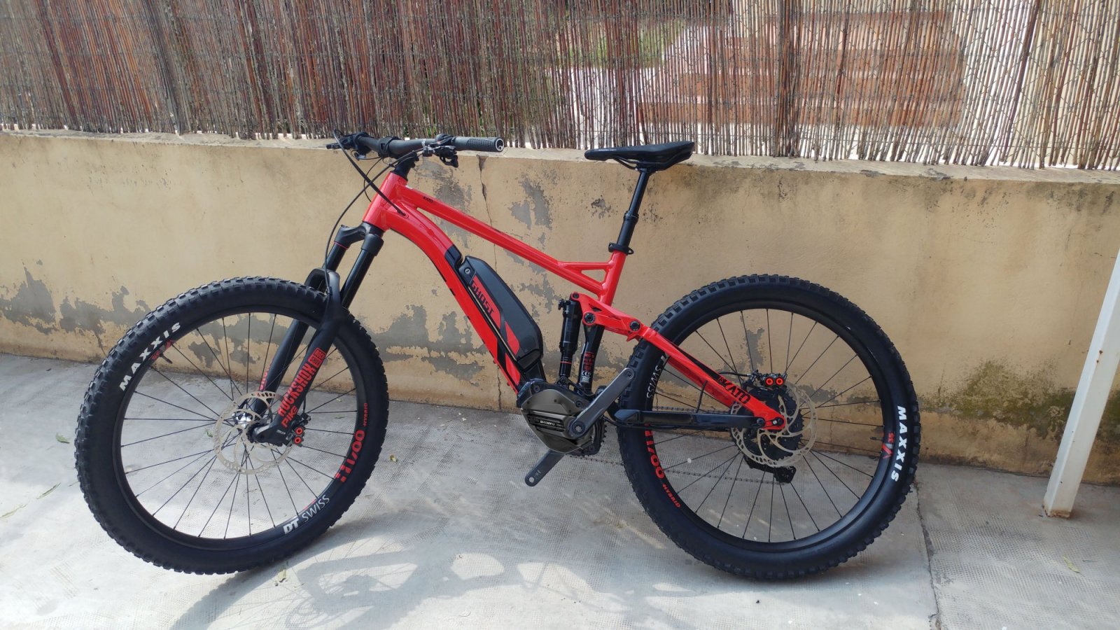

AFAIK it was an updated to the bluetooth stack on the E7000 (there were security vulnerabilities in BLE that were perhaps addressed in this updated).
The FW update for display SC-E7000 makes it compatible with new EP8, among other improvements:
4.1.0
・Adapted for new drive unit (DU-EP800)
・Added last 3 digits of serial number to the device name display when connecting via Bluetooth.
・Improved connectability with Bluetooth.
・Adopted for My Bike connectivity for E-TUBE RIDE. (Actualmente en traducción)
I already updated FW of my SC-E7000, so I am ready to retrofit the EP8, I checked the fit, and it looks goooood!!!
v0rt3x
Mar 27, 2020
24
15
Slovenia
Nice, I'm interested if it's compatible with the external E8010 battery since I have a Merida with the same one.
Spiff
Feb 27, 2019
414
239
Earth
EP8 is compatible with all Shimano batteries, many new bikes with EP8 still use the "old" 504W BT-E8010. If you are asking about displays, they are also compatible with any battery.
