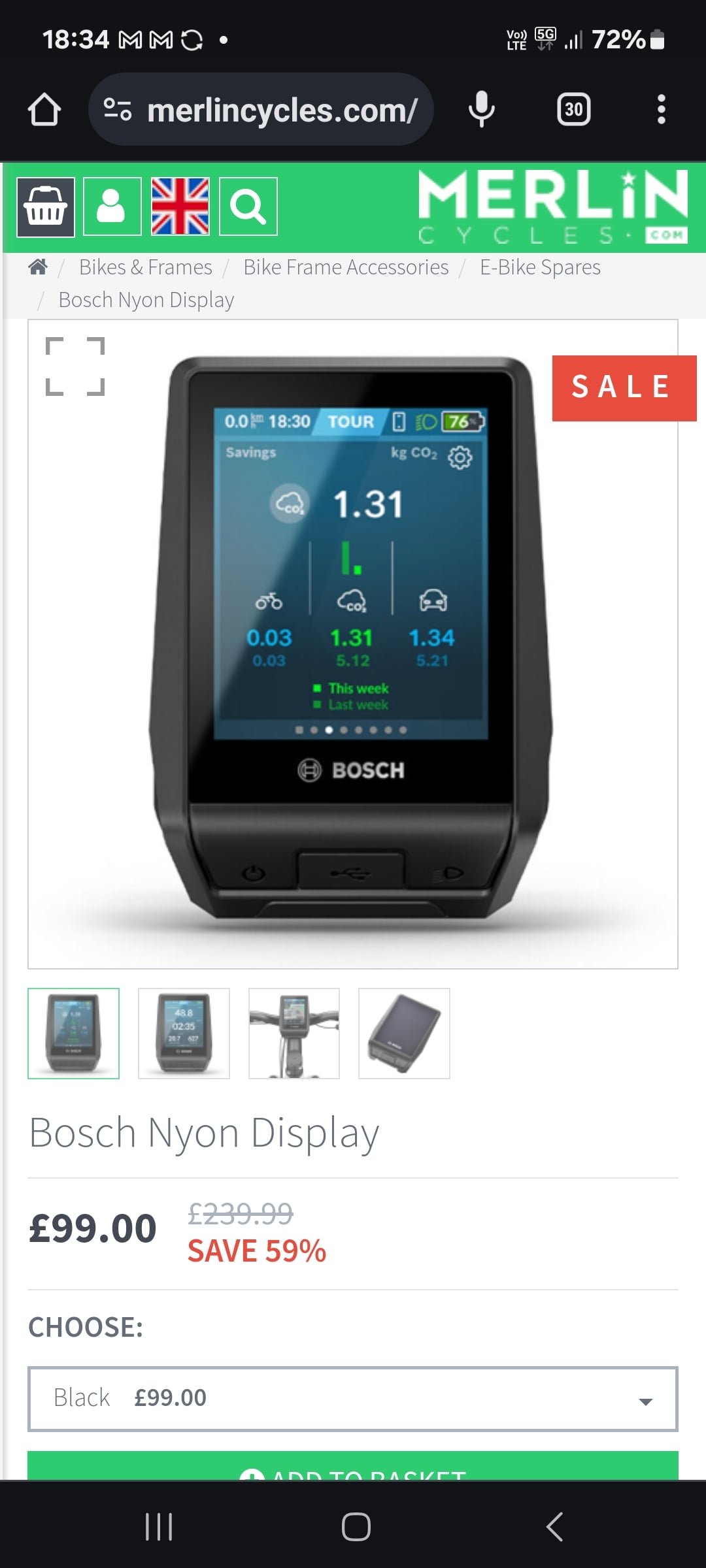

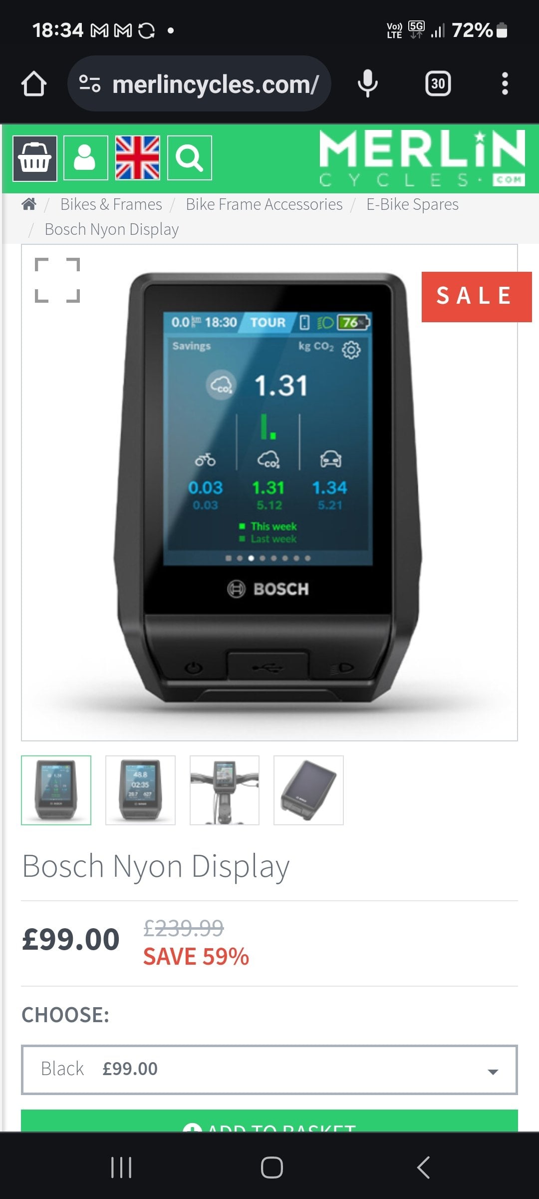

Matter of interest look at the price there selling this
I get the point that it may be similar cost wise as asking LBS to hook up to their PC and would give me ability with connect to download updates. But I had seen somewhere that the motor still.needs to be taken to LBS to get it to recognise a different display. Or is it a straight swap at home?
I think if you already have Kiox ( the original Kiox) the job is at least simpler. If you currently have no display then a cable has to be run from the motor to the Nyon and ( I believe) that is a motor out job. Dont know whether the system would auto recognise the new controller or whether it would need a LBS to do that.
The ridiculously low price you posted a bove also raises some alarm bells for me! Either it is something that simply does not sell or something I think I read on here is true.....that Nyon has had no updates etc by Bosch for well over a year suggesting it may no longer be supported...who knows!!
The Nyon from above is the display only. No mount, no cable and no controller. It could be useful for someone who lost his display but not for an upgrade from a different display..
@Mikerb is right. You would need to swap the existing display cable. I have never worked on a Trek Rail and don’t know how much space there is between the electric connectors on the motor and the way up into the downtube. In many modern bikes there is enough room to route the cable without dropping the motor. You need to check.
Everything else is very simple and you don’t need to go to the LBS. The motor will recognize the Nyon on its own. The Nyon 2 was last updated early August 23. It is still supported and I expect the next yearly update in July/August. I myself have a Nyon 2 on my Simplon, but for the individual ride modes a Nyon would make available I wouldn’t buy one. Those are very simple and in my opinion no benefit for trail riding. They are a commuter thing.
