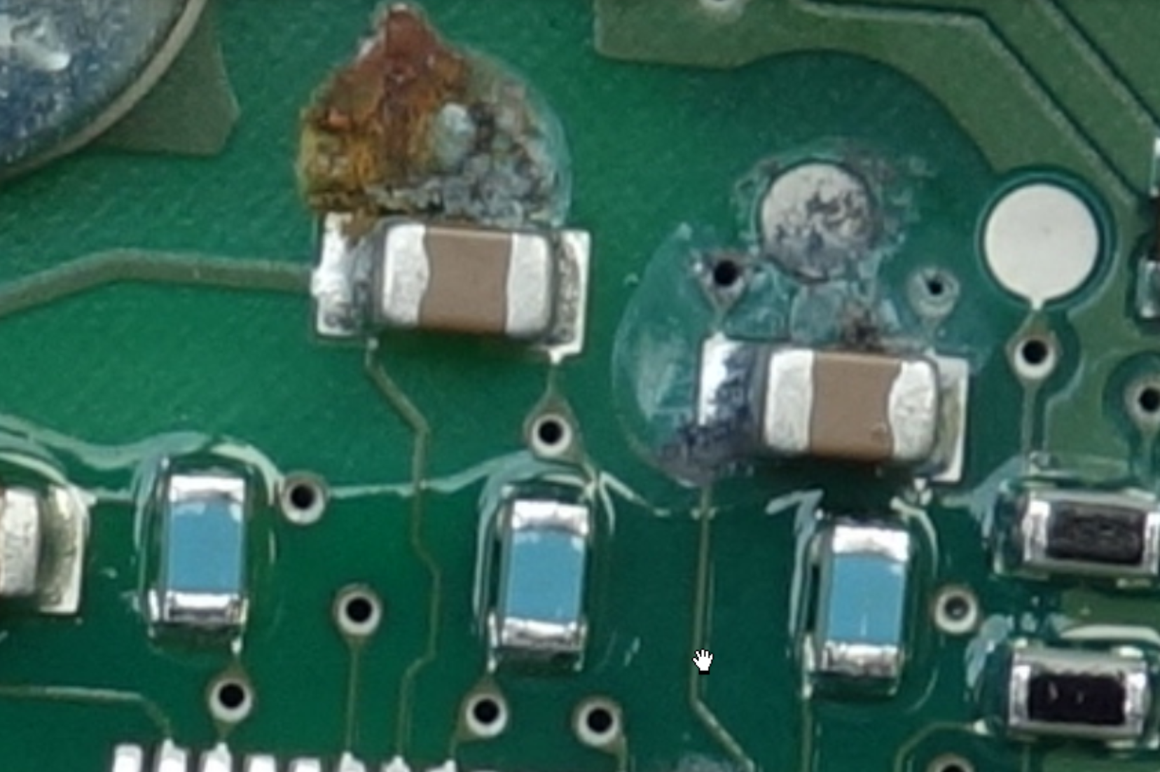

I have a simple solution to this.. .if you are mechanically savy... you can always open up the motor and use dye electric grease on the electrical components.. this is just my hypothesis but it should technically keep moisture and water out from critical electrical components causing them to not short or rust out..
Im wondering if anyone has already tried this???

need a better PCB coating that will rule out closure
I also have a photo of my Bosch 2 engine
Here you can see that everything under the clear lacquer remains intact and where no lacquer closure occurs
Yes it's very simple, Bosch could just make the PCB 'potted' or coat the whole thing with resin like the blue fluid in your pic.
View attachment 143148 View attachment 143149
aww so this is a better solution than dye electric grease.... Im not a electrical engineer or anything... but my guess was that since dye electric grease is hydrophobic and non- conductive... it would be great way to protect PCB boards without shorting them out.. since factory solution does not provide a "better PCB coating" I was wondering if this would be an adequate work around...
and also.. may i ask what that clear lacquer and blue substance is?

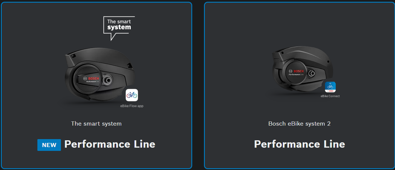

Are you talking about this performance line in the picture or was there another one? I have the non smart one in a 2020 Cube emtb and they're still in the cheapest cube reaction performance 2024.
OK, so this is the Performance Line Gen 3 and is made very different to the Performance Line CX Gen 4. The Gen 3 was primarily designed as a road bike motor, and does not have the strength, power or sealing that you would find on the Gen 4. The low power of the Gen 3 meant great battery range though.
All EMTB's used the Gen 2 CX until 2020 when they all went over to the Gen 4 CX. One manufacturer that I know of in 2020 put them in their "gravel" bikes and this was Cube. Since then, others have tried this too, even putting the Gen 3 in their low end mountain bikes because of the cost saving to the manufacturer. Sadly, the Gen 3's don't do well in water at all. And the reason you don't hear about it, is because 99% of these motors are fitted in road bikes which don't tend to fail like the offroad bikes.
This being said, the Gen 3 Performance Line is the strongest of the gen 3's and ha a large steel drive gear instead of the plastic one fitted to the Active Line and Active Line Plus. This allows the Performance Line to take bigger pedal strikes and hits better. And, if you stick to the gravel, it will do the job.

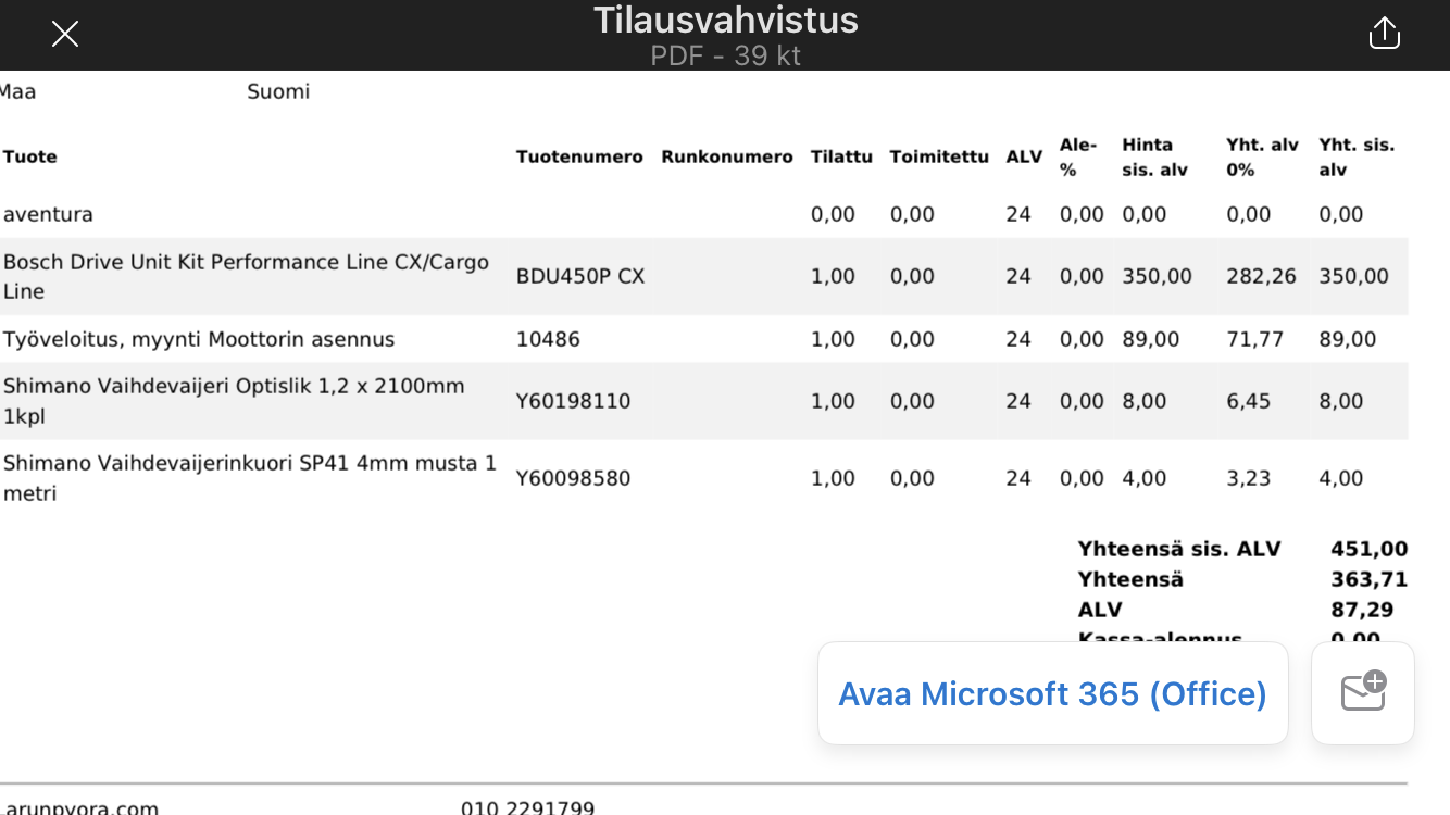

So update to my motor replacement, gonna pick up my bike today. 350€ for motor and 89€ for the replacement. I don`t think it`s bad at all. Of course it could have been little faster operation 😀. I asked to replace also my sifter cable while the engine was away.
