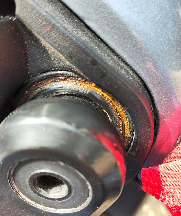

THANK YOU FOR POSTING THE PHOTOS.... NOW I CAN BE ALMOST CERTAIN THAT MY ENGINE HAS ALSO BEEN BREAK DOWN THIS WAY
IN MY PHOTO YOU CAN SEE A BROWN EDGE AROUND THE BEARING (LEFT SIDE BEARING) THIS BROWN EDGE WAS THERE FOR A FEW HUNDRED KM UNTIL IT WON'T START (WITHOUT AN ERROR CODE...) IN YOUR PHOTO IT APPEARS THAT
IT APPEARS THAT THE PAINT LAYER IS COMING LOOSE THROUGH THE WATER
WHICH MAY CAUSE CLOSURE
SORRY FOR THE BAD TRANSLATION VANUIT HET NEDRLANDS
This is normally caused by rust (corrosion) coming out of the bearing.
