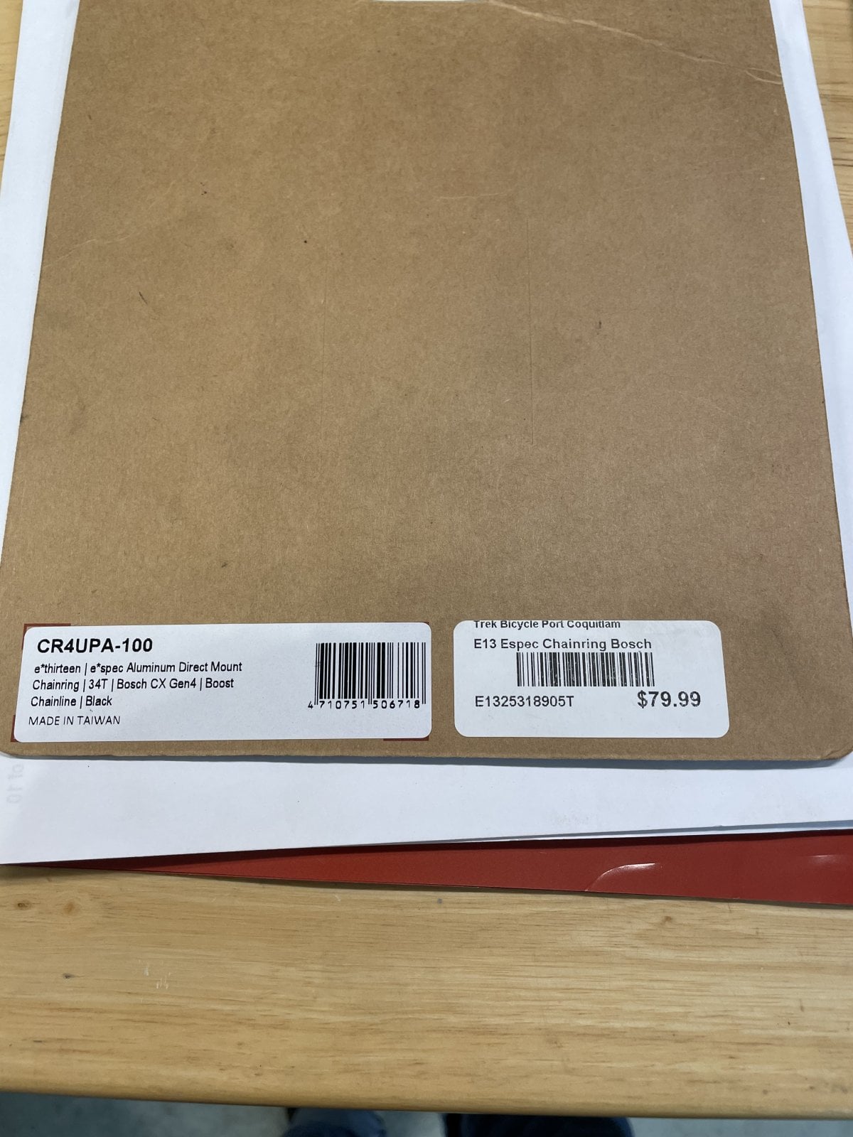

I just ordered another E thirteenth 34t chainring as a spare. There was no install instructions but if you have the crank removal tool and spider socket, it’s pretty straight forward. The “o” ring metal spacer wasn’t necessary because the new E thirteenth chainring has integrated that into the new part. (Seems to work fine). But the teeth are friggen close to the chain stay (carbon bike here). 30F16BDF-81A2-4AF0-BF89-3FE799D15045.jpeg
I didn’t pay that much for it. Canadian prices though. ($54?).
