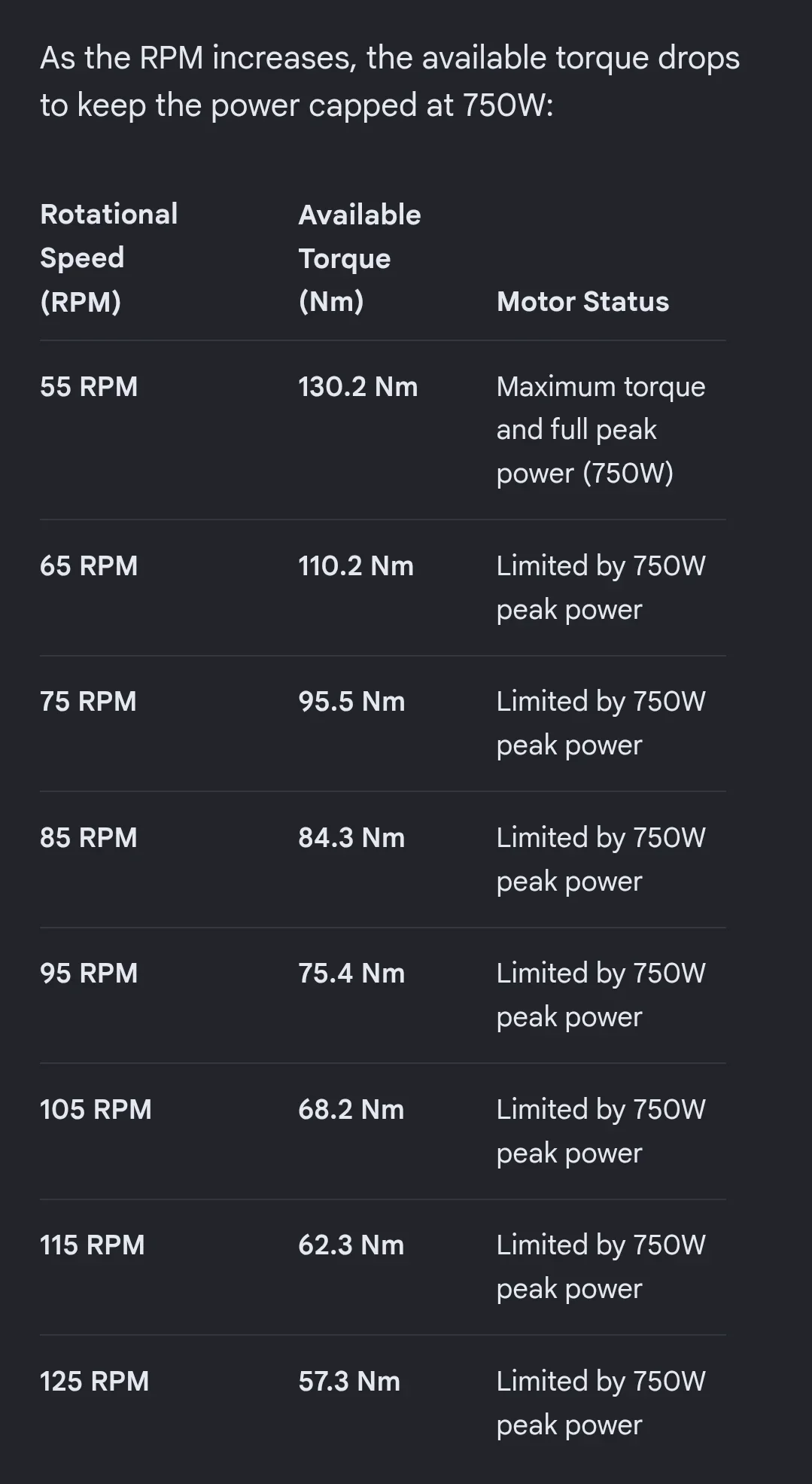

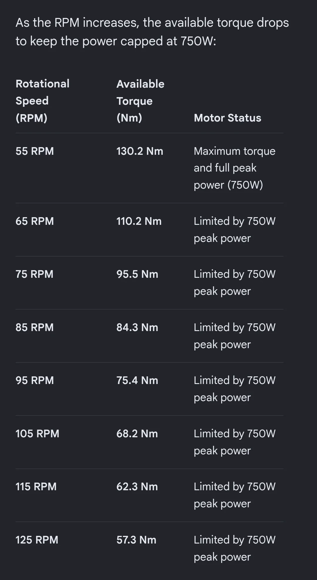

A technical bit about the RS Tune 750W peak and 130Nm, how does that work out. I think someone asked about this. There is a simple formula that we can use...
Power (W) = Torque (Nm) × RPM / 9,549
What is 9,549?
The number 9.549 is a mathematical constant (conversion factor) that connects rotational speed in minutes (RPM) with angular velocity in radians per second (rad/s). It is used so that torque and power can be calculated directly from revolutions per minute (RPM), which are the most practical in engineering.
If we take the peak power number 750W and peak 130Nm and throw that into the formula we get 55 RPM.
RPM = 750W x 9,549 / 130Nm = 55
That tells us that with the RS tune the motor is capable of delivering 130Nm already at 55 RPM.
The maximum current draw here is at cca 21 Amps.
But being capped at 750W peak that also means that increasing the RPM automatically reduces the torque.
Below is a chart what is to be expected at different RPM(cadence). Of course you don't always reach peak power, that happens momentarily, depends on the terrain and gear you are using at each moment. So during the ride the motor torque varies between the max 130Nm and cca 60Nm. The torque you get on the back wheel of course depends heavily on your gearing.

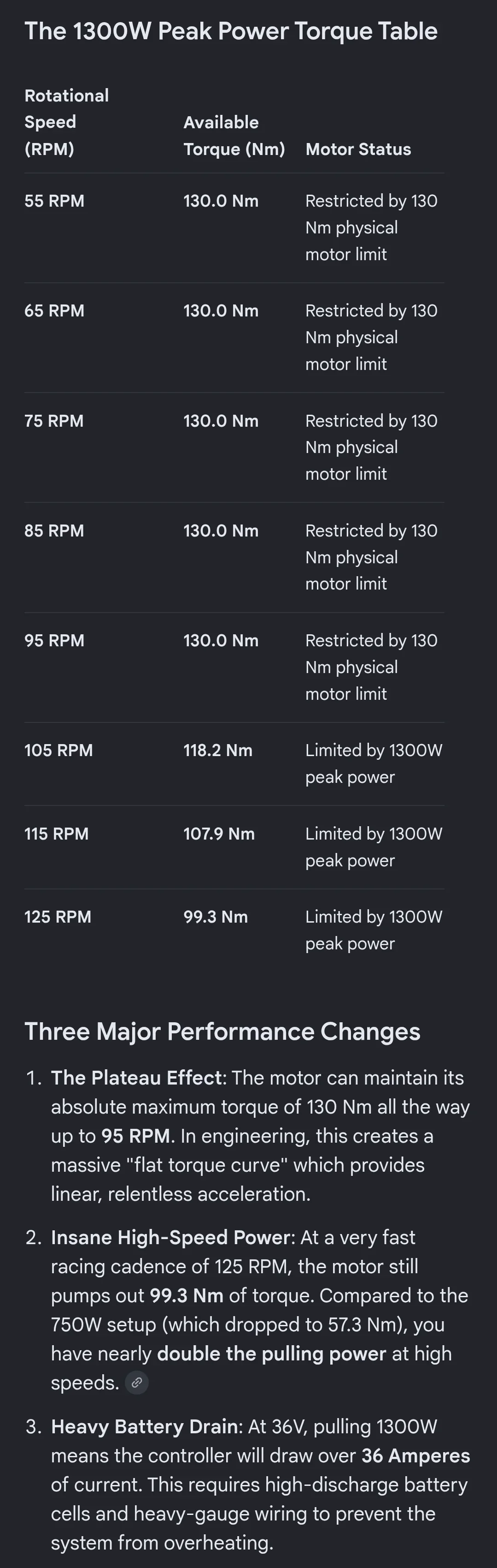

With the same formula we can calculate the difference between 750W peak or 1300W peak, it's pretty interesting.
So the RS Tune should in theory reduce battery consumption to a degree but it will probably also feel less powerful at higher cadences.
Hope this clears things a bit about the performance difference of peak power numbers, and why the Avinox feels so powerful on the trails.✌️

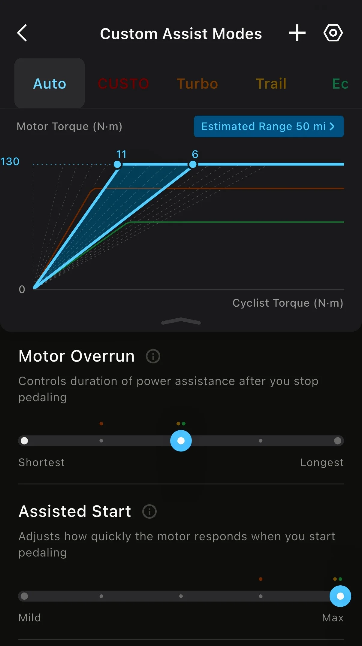

Is the new Wild’s “QuickStart” option in the power-limited RS mode really anything special? The standard Avinox M2S already offers six tuning options for all power assist levels (Eco, Trail, Turbo, Auto, Custom). The options include max torque, max power, max acceleration, motor overrun, Assisted Start, and continued assist. The screenshot below shows some settings I use in the Auto mode on my Pivot Amp’d. In the quickest of 5 Assisted Start settings it’s not at all “gradual”. Has Orbea somehow accessed something special that Avinox chose not to, or is “QuickStart” just the standard Assisted Start made available in the power-limited RS mode?
Edit: OK, here’s what Dario over on Pinkbike had to say:
“Those tuning parameters, for those curious: Pedal angle, 5x more sensitive. Pedal torque, 2x more sensitive. Pedal speed, 3x more sensitive. Assist start curve, 3.2x faster yield versus stock. All those increases might sound daunting, until you learn that the peak power has been reigned in to 750W at peak output.”
What is 9,549?
