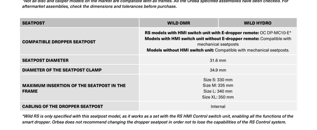

5) I'm 5'10" and run a 200mm AXS dropper or I could run a 210 OneUp. Sorry, but this isn't getting better. In fact with a 210 OneUp my rear tire hits my seat. That's just AI garbage.
