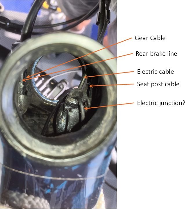

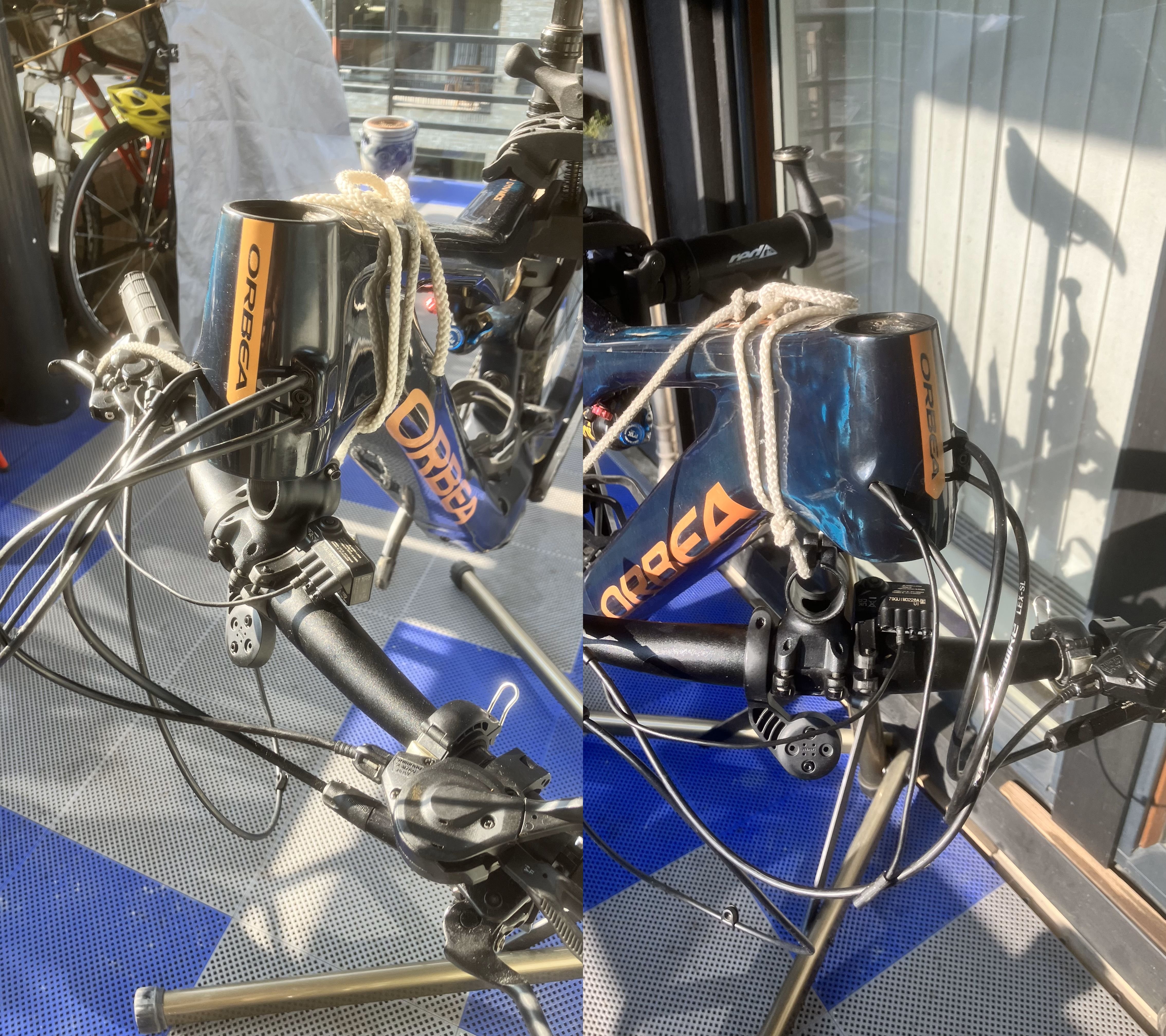

The headset bearings on my Orbea Rise M20 (2021) feels a bit rough, I tried to tighten them slightly yesterday, but this caused it to be very rough, so I suspected corrosion. Inspired by this thread i decided to have a go at it today.
  1. Before dropping the fork I removed the handlebar and suspended it on the frame (first picture(s)).
  2. I also removed the brake caliper and the clip that holds the brake line to the fork and tucked the caliper onto the handlebar
  3. Regarding the cables, I only disconnected the electrical cable coming out of the frame from the display (if no display then disconnect from the EW-EN100 Junction).
  4. I dropped the fork (had to tap it gently with a rubber mallet to get i through the upper bearing) and used a small piece of wood to tap the lower bearing out of the tube.
  5. As suspected, the lower bearing was badly corroded. I tried to regrease it (I actually took it apart and cleaned every ball), but still not very good, so it will be replaced. The upper bearing feels OK, but will be replaced as well.
  6. I could see that I had pulled the electrical couplings for the switch/display slightly out of the downtube (picture 2), but I was able to push it back in with help of the seat post cable cable. Since the fork it tapered, there is fairly good space for the cables inside the headtube.
  7. When remounting the fork, I placed the lower bearing on the fork (rounded profile up) and pushed it carefully through, then while holding the fork in place with one hand I pushed the upper bearing in place (quite tigth, so the fork stays in place when it is fitted.
  8. Mounted the handlebar, tightened the bearings and finally tightened the clamp bolts to the correct(ish) torque:)

Good job
I think those photo's will be really useful for people with the 21-22 models
unfortunately it seems Orbea went and put the cables through the headset and not around the headset on the later model.
I'll bear your tips in mind when I swap the bearings though.

I am not quite sure what you mean? On my 2021 model the following cables all go through the headset:
Right hand side: Seat post cable and Electrical cable. Left hand side: Rear brake line and Gear cable.
(It was the seat post cable I pushed in to relocate the electrical junction into the down tube, corrected in the reply above)
through the centre of the headset bearing - there are no ports in the side of the head tube
But your photograph of the work quite clearly shows cable ports at the side of the head tube, not going into the headset cover. What your arrangemt looks like is every home mechanics dream…I think you meant to reply to gunnar
I think you meant to reply to Gunnar - it's probably a language thing - headset and headtube are pretty similar...
