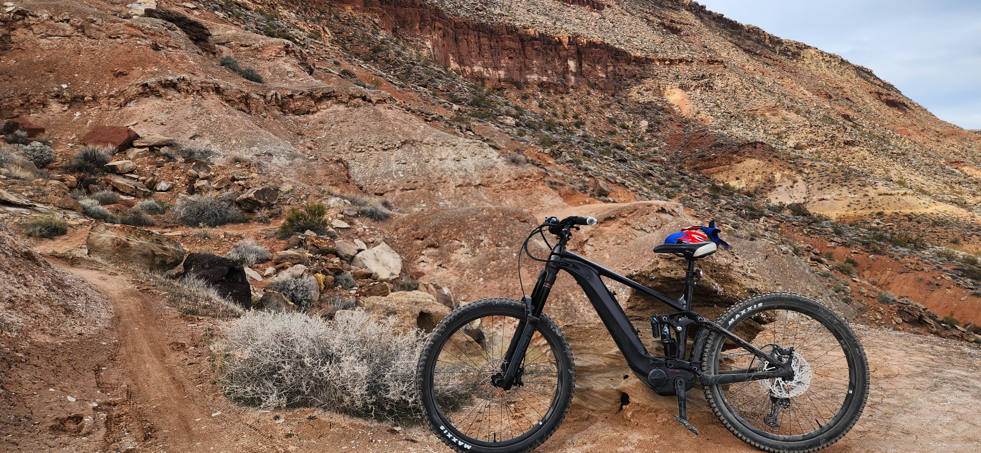

Finally picked up the e+2 today. Looks great. Heading south next week to give it a couple of weeks of abuse.
Great looking bike, any chance you weighed the bike out of curiosity?
What are those things either side of the bottle mounts?
Range extender fits perfectly and the cord plugs in perfectly with room to spare. Having 1050wh this summer is going to be awesome for really long days.
I haven't weighed it as I don't have a decent scale and bathroom scales don't count. It does feel slightly lighter than my 2020 reign but I have pretty heavy tires on the '20. Very scientific:rolleyes:

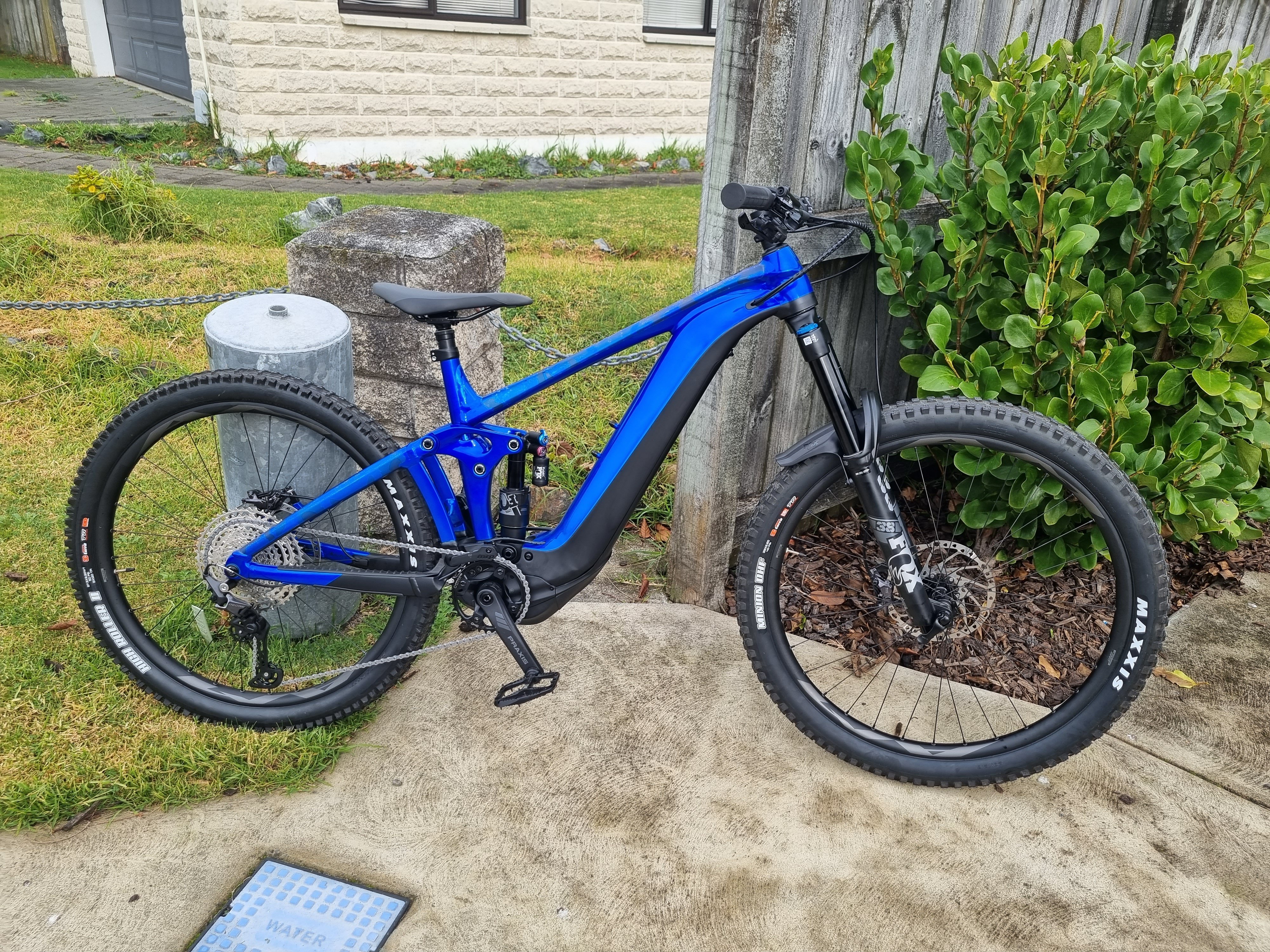

Picked up a 2023 Reign e+ 2, I had setup the Fox Float X2 to 30% sag, but seems like I am blowing through that on chill stuff, should I increase the psi? Currently @ 210psi for 95kg rider with gear. Rebound set to 5. Any suggestions?
I have just got a reign e+ 3 and put fox performance elite suspension front and rear. Noticed the same thing on my first ride yesterday, currently have 2x tokens in my float x2 so am going to add a 3rd and see if the travel usage is more balanced.
It's a float X not X2.
For 95kg, you should put 225 psi at least.
With 215psi and 85kg, i had to put a bigger volume spacer for a better middle stroke support.
0.4mm from factory, i went to 0.6mm
Volume spacers
