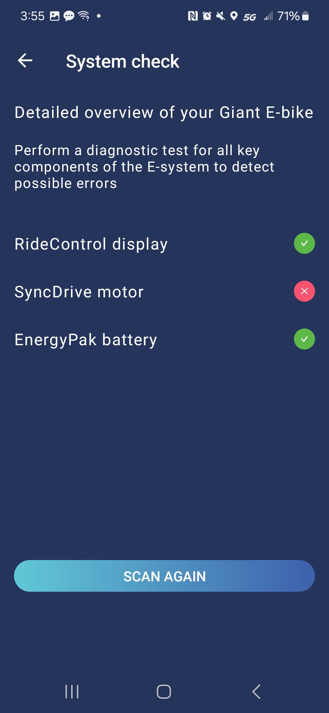

Less than 30 mins into a ride this past Tuesday my bike cut out and would NOT reset after powering off. I attempted to power it off and on at least 15 times, 3-4 times it would clear until I put any pressure on the pedals and then go into r2 fault.
The other times as soon as it powered on it went into the r2 fault. I pushed, pedaled and hiked my 60lb behemoth back to the car. It actually reset on power up at the car so I pedaled around the block and it once again went into the r2 fault about half way. I connected my phone app and ran the diagnostics which indicated that the motor failed the test. I loaded it onto the rack, called the bike shop and drove home.
The next day I took it to the shop and they hooked it up to their dongle to read it off the computer but the technician didn't know what he was doing and it ended up being a fruitless endeavor. He did contact Giant and they gave him some better instructions on how to use the software. So the following day, Thursday, I brought it back to the bike shop but this time I peddled it furiously for about 20 minutes until it went into fault mode, and then it again went into continuous r2 fault mode so I was able to laboriously pedal it back to the shop while still in r2 fault mode and they were able to hook up their dongle, read off the computer and generate a report.
The report indicated that it had gone into the fault 31 times, and that it was experiencing motor failure, which corresponded with what my app had told me 2 days prior.
Friday I was informed that a R/A had been generated, and a replacement motor had already shipped and should be at the shop this coming Monday or Tuesday and installed by Thursday.
Another thing I would like to add is that it seems that my motor makes an additional noise after it is warmed up just prior to going into the R2 fault. It makes the normal electric motor noise but at times, as the motor is disengaging when I stop pedaling, there's an additional chafing sound that comes out of the motor. Not a grinding noise, but maybe like the noise it would make before it started grinding. Chafing is about the best word I can come up with to describe it.
479 miles on the bike.
@dimitrin interesting. My motor makes a similar sound but since I’ve gotten it back from having those harnesses replaced I had no issues with it. I thought it was normal as this is the first full power eMTB I’ve had.
Do let us know if the noise goes away after replacing the motor!
Ok, I picked up my bike Thursday with a new motor installed. 1 week turn around from day of diagnosis is commendable imo. I've only rode it about 1/2 mile on pavement but I immediately noticed how much quieter it was vs the original motor. It is much quieter, with no additional chafing noises or lurching when I stop pedaling.
I have a pretty aggressive ride planned on it for tomorrow with the tech that installed it, so hopefully I will have a favorable experience to report back.
I will also try to compare battery usage, as I know what it normally consumed on the route we plan on taking.
