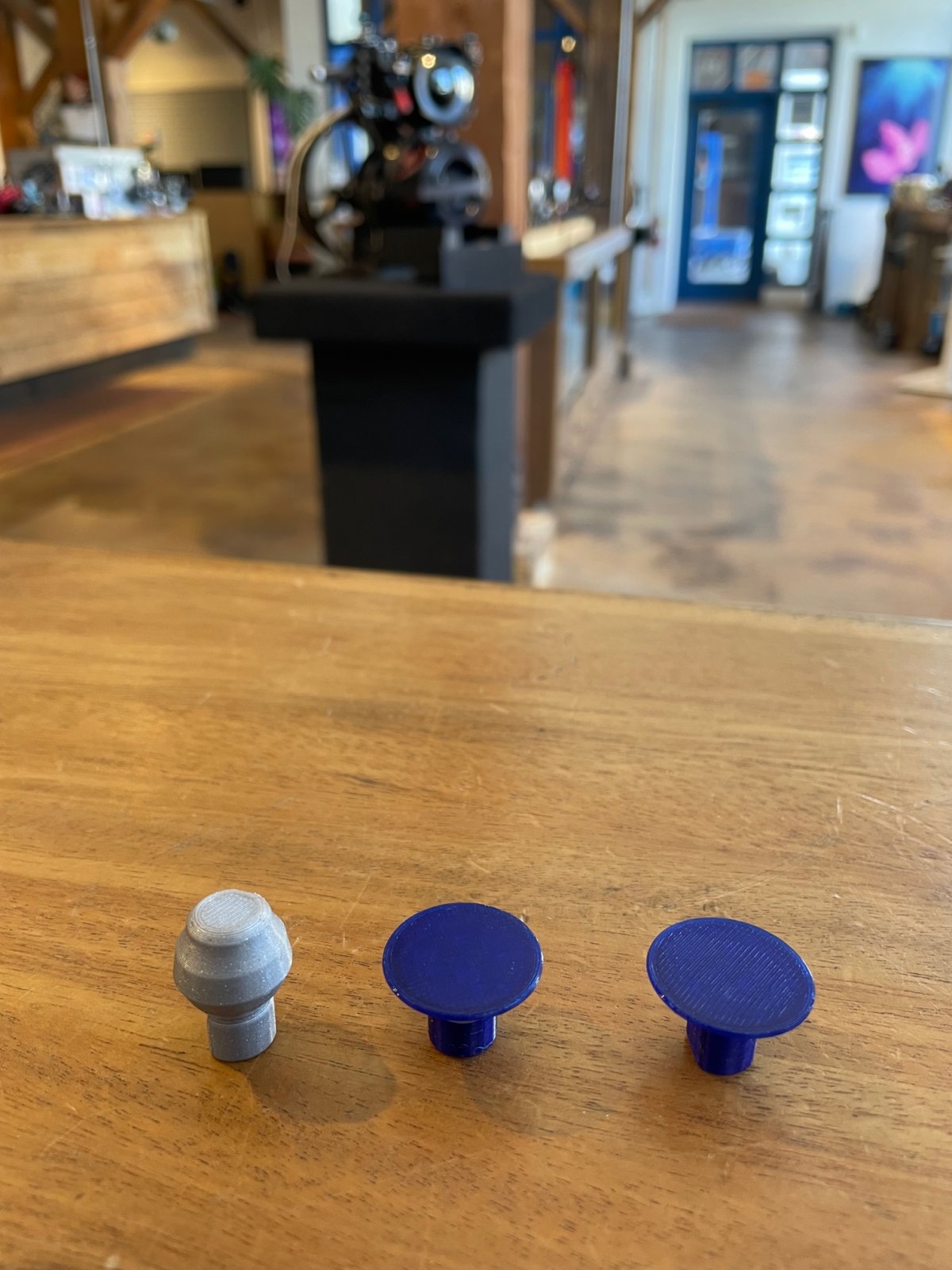

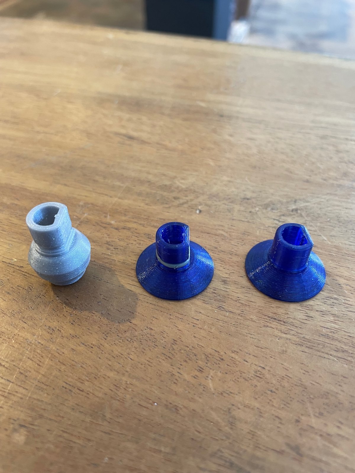

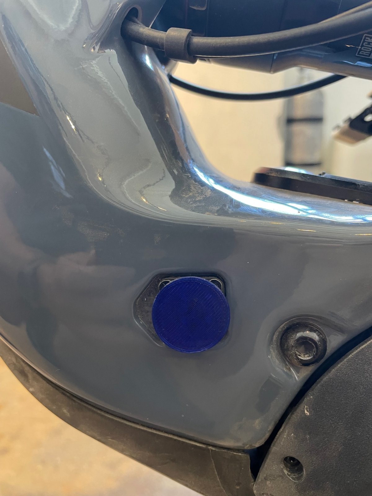

Printed some covers today, The grey one sticks out too far. The second one has an o-ring and pushes in and seals, should be totally waterproof but the material is a little thin where the o ring goes and could be a potential failure point if someone was not careful when removing and twisted the head. The one on the far right with no o ring pushes and seals very snugly yet is easy to remove. I think its probably water tight, not sure if you were to submerge it in a river and if thats a concern then the o ring would be the better option. Going to make another version with thicker material and an o ring.

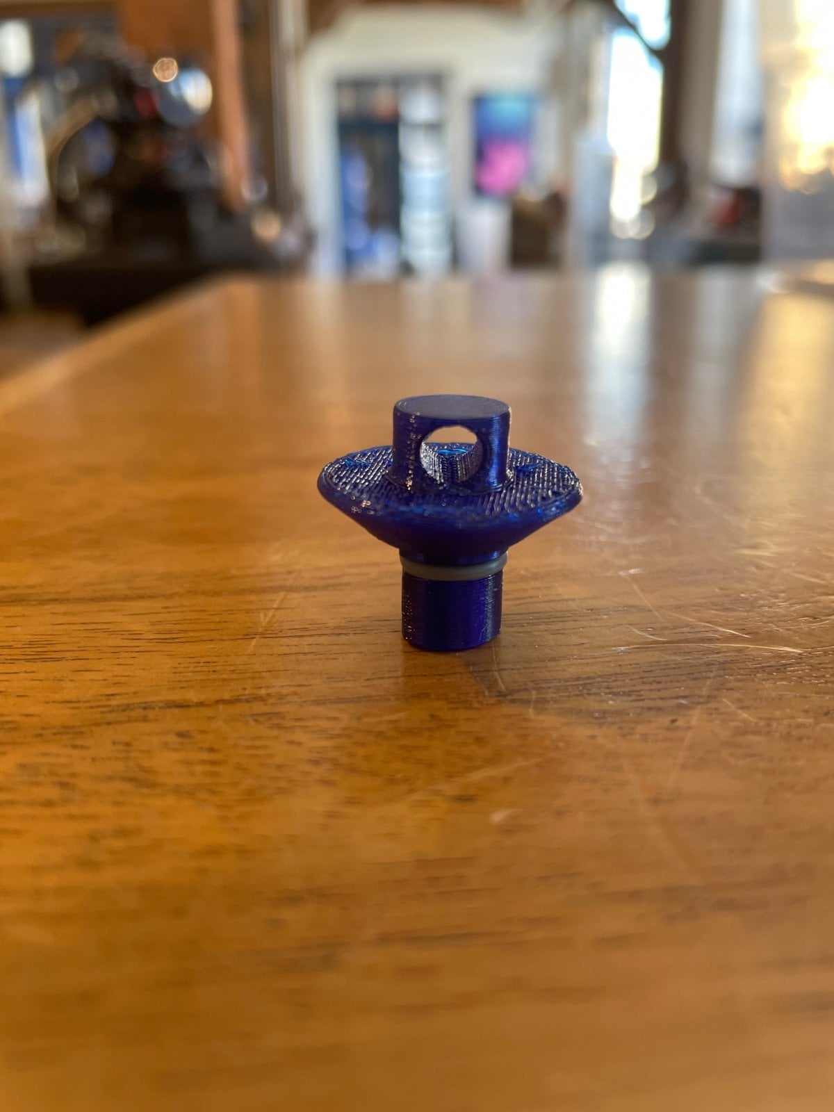

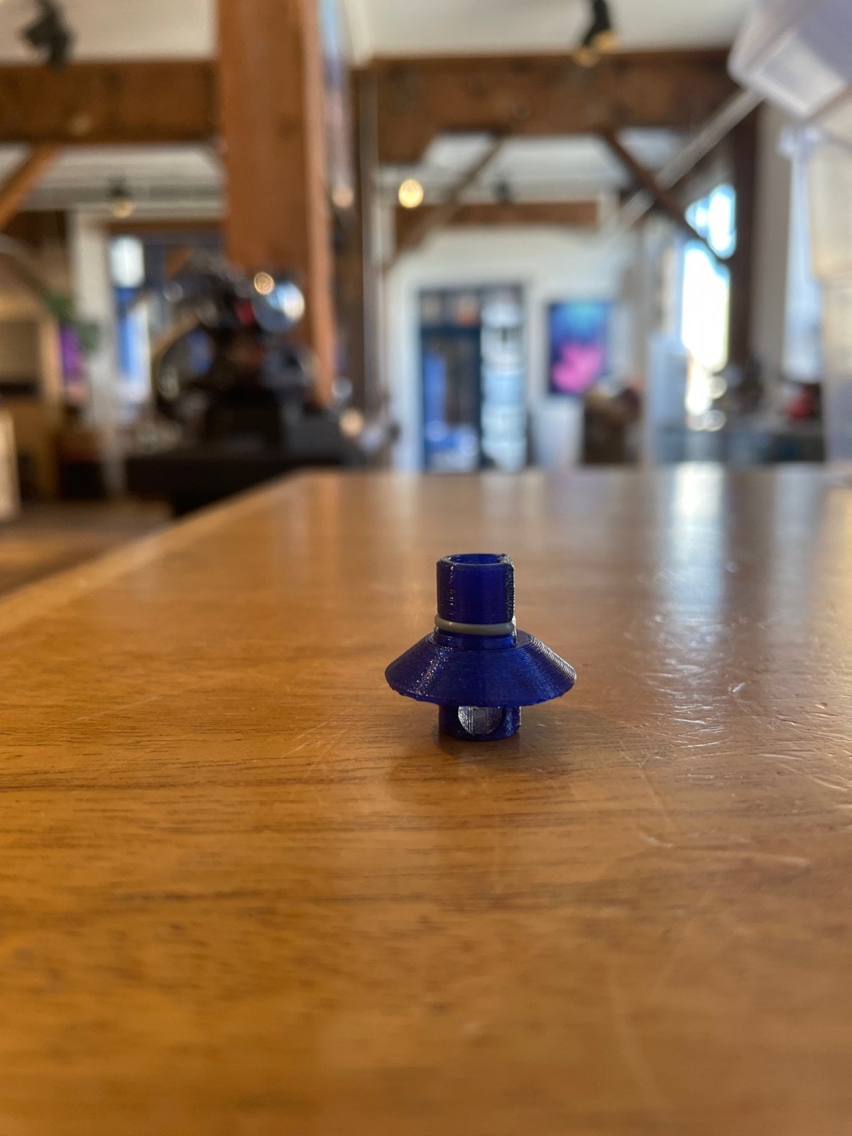

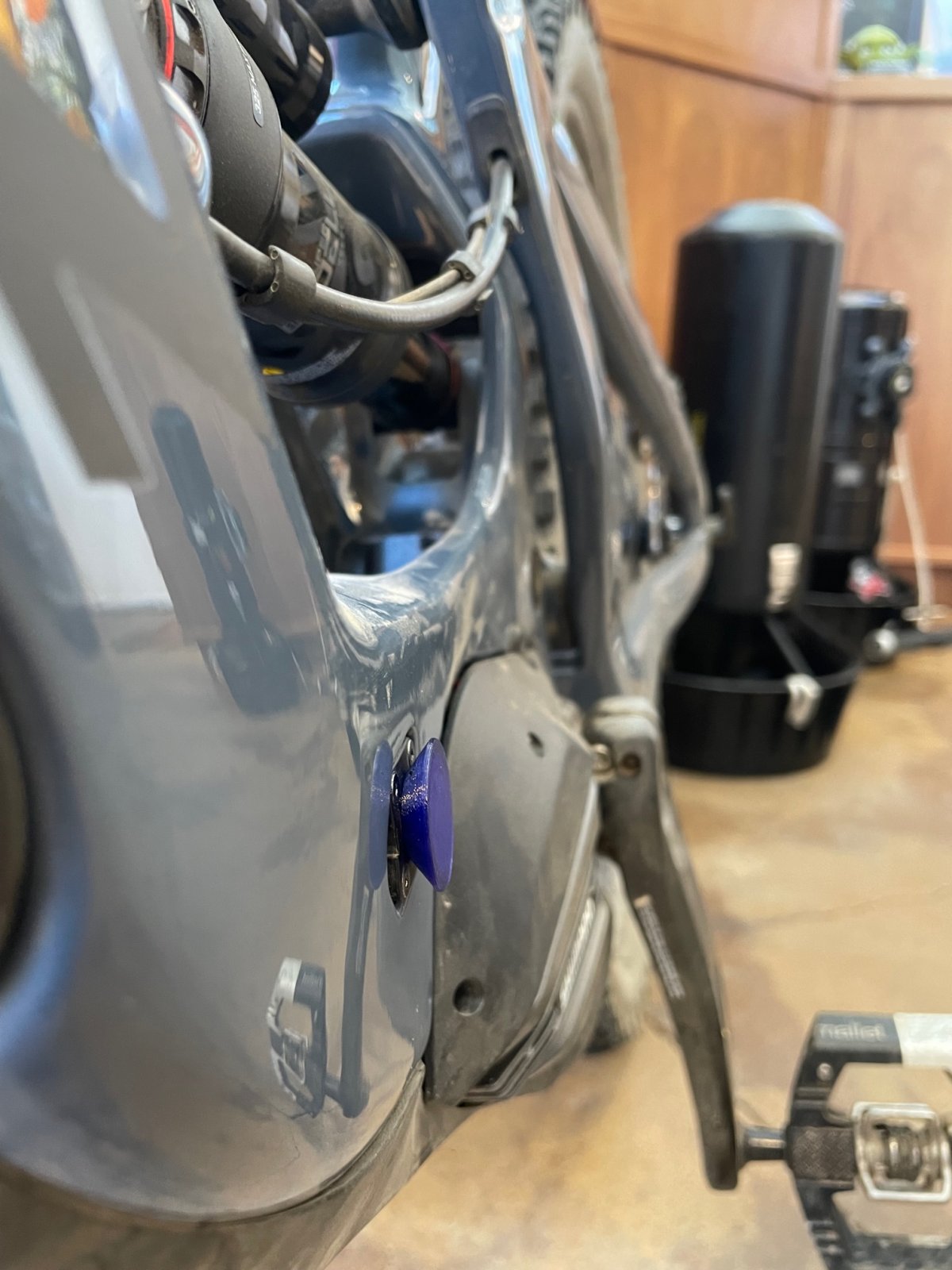

This might be a winner, added a small nub you can put an allen wrench through but its easy enough to pull it out without it. Also thicker where the o ring is and seals tightly.

Awesome!
I'd definitely want water tight. I live in the mountains of Colorado and do stream crossings often.
Happy to compensate you for your time and for shipping mate (paypal?)
thinking out loud: Could it be made "round head" instead of cone head?
Random internet photo of round head plug to show what I mean :) :
I'm thinking about worse case situations where you catch branches or what not in the pickies; worried about catching that protrusion and potentially breaking the charge port?
The last few rides we got into canyons full of tumbleweeds and I suspect a protrusion could snag things.
