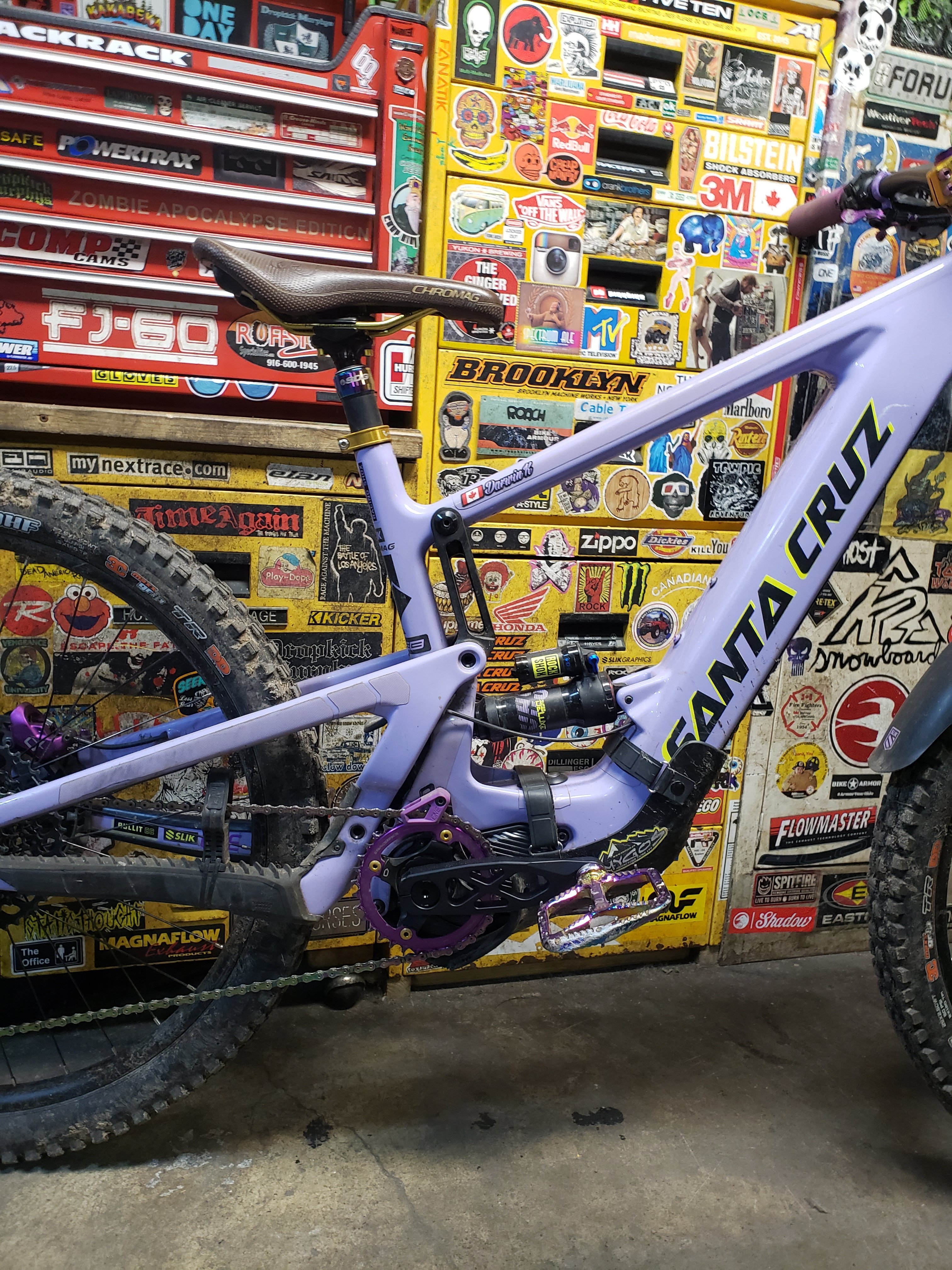

2022 Bullit build
Great writeup on the emtb Bullit. As an owner of the original SC Bullit and later an '03 Bullit, I've always appreciated SC and their products...also have an '08 Nomad. In fact I turned the '03 Bullit into a home build, mid-drive, Bafang BBSHD off road rig that I rode for 3 years.
I recently went with a Gen 2 Trek Rail 7 because I wanted to go with the Bosch motor. I can really appreciate your preference of going with a coil rear shock. I did the same with my Rail with a Fox DHX2. I also went with a Marz Bomber coil fork. I think it's almost criminal that the suspension manufactures have little to no coil options out there. These bigger hit bikes love coil suspension, and with them being emtb there really isn't a weight penalty to speak of.
In your case I'd be tempted to go with one of the coil conversion setups that are available for the ZEB, but that's just my preference. Obviously you've given a great deal of thought to your mods, and like most of us, you're probably not through yet. 😄
My Bullit is still brand new but I'm tossing around the idea of going with a coil shock at some point.
Its a good idea to have 2 rear shocks if youre gonna ride a bunch. I prefer the coil to the air shock but every time the coil needs a rebuild and I throw the air shock on it feels better than I remembered it.
D
Good advice for sure. I do the same thing with my Toyota when I rebuild the coilovers. I'll probably stick with the Rockshox coil to keep thi ga simple, but I am an Ohlins fan boy for my motorcycles.
Started out with 70/140psi in the fork/runt, wasn't getting full travel so I dropped it down to 60/120. Feels better and I was using more travel on the short little test rip in the neighborhood. Have to remember to bring the shock pump with me next ride so I can mess with it some more.
D
I'd like to hear what u think of the cascade link u put on. Big ride difference?
Honestly, I can't really tell.. The bike rides pretty mint as a whole and I would throw the link on again but you'd have to do a side by side comparison to try and discern the subtle changes it made.
In my opinion, a good coil shock with bearings on the link end made the biggest difference in ride quality. It honestly feels like there's something loose in the rear end (in a good way?) its so supple if that makes any sense.
D
D
Thanks for the feedback! I just ordered a Enduro bearing for the coil(rock shox super deluxe) rear eyelet. I've been chasing a creak somewhere in the rear pivots. Other than that I share much of your opinion s on the bike. It's a keeper!
Try taking off the rear wheel and universal derailleur hanger, clean and grease the hanger where it meets the frame and grease the rear axle as well. That area is where I had my mystery creaks.
D

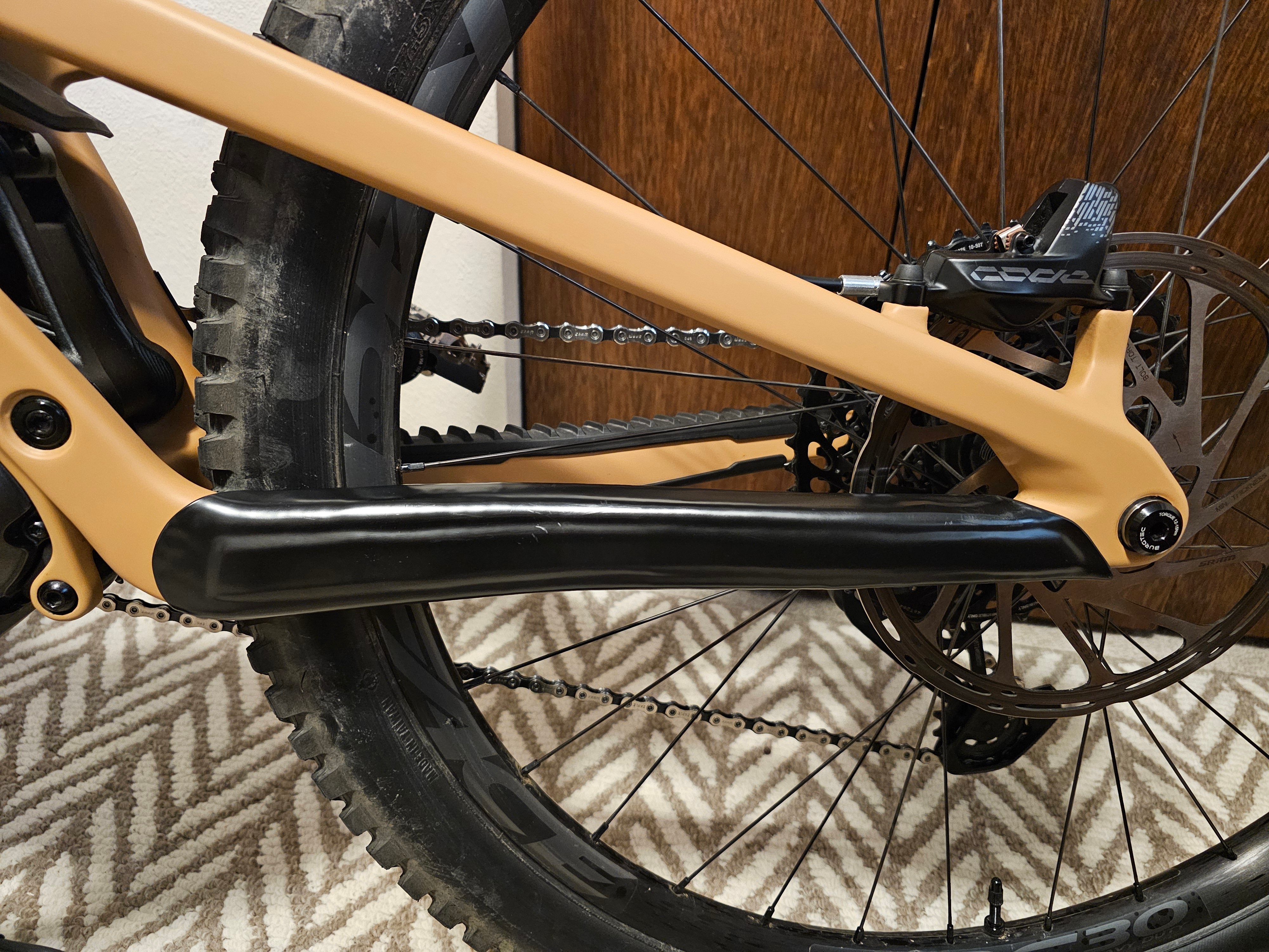

The Amygos chainstay guard arrived today! I wrapped the stay with some 3M heavy duty electrical tape for a little paint protection before I snapped it on. It fits perfectly and feels bombproof. It was worth the wait and shipping cost! Thanks again for the tip!
Right on, glad you like it man!

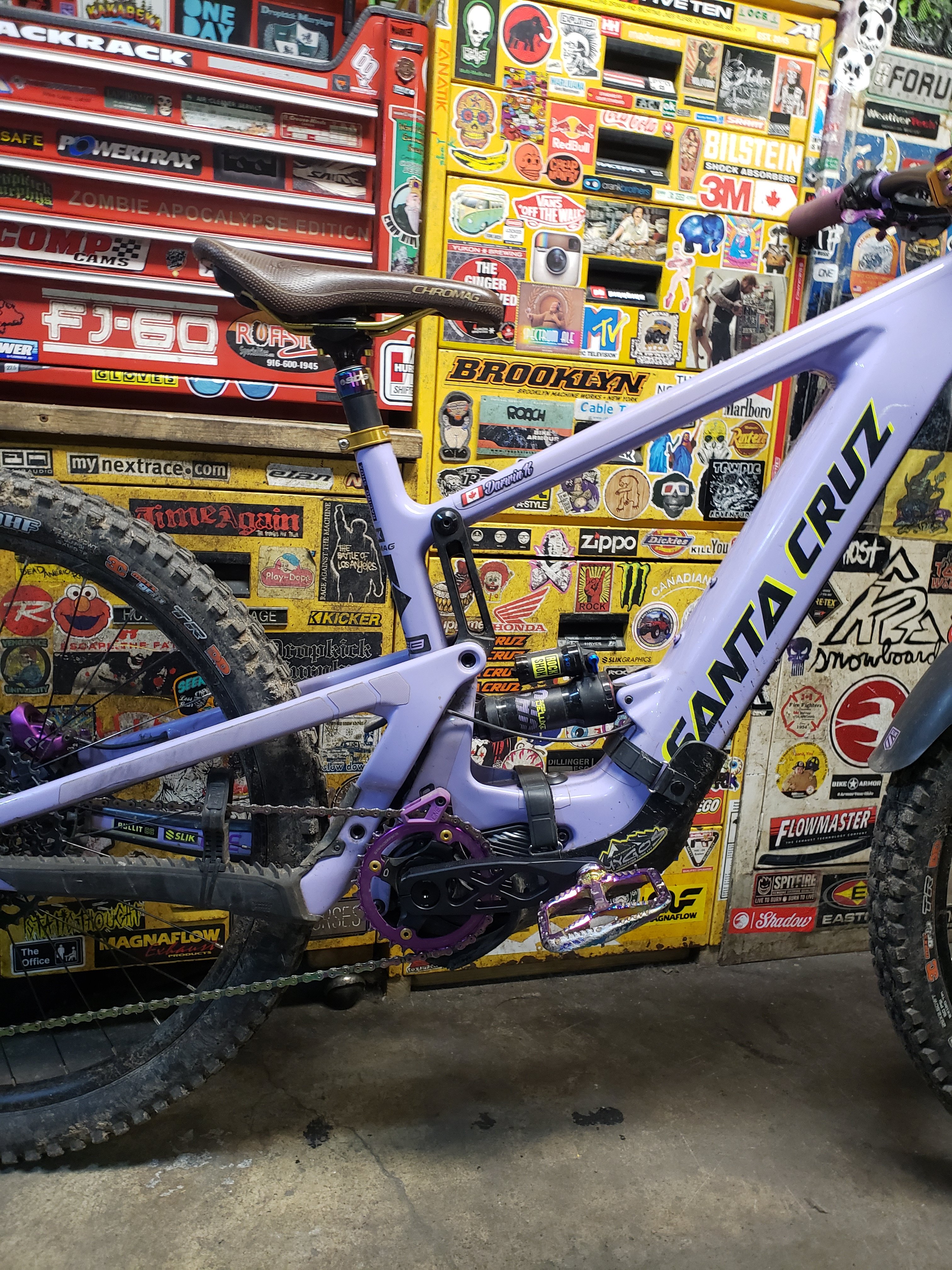

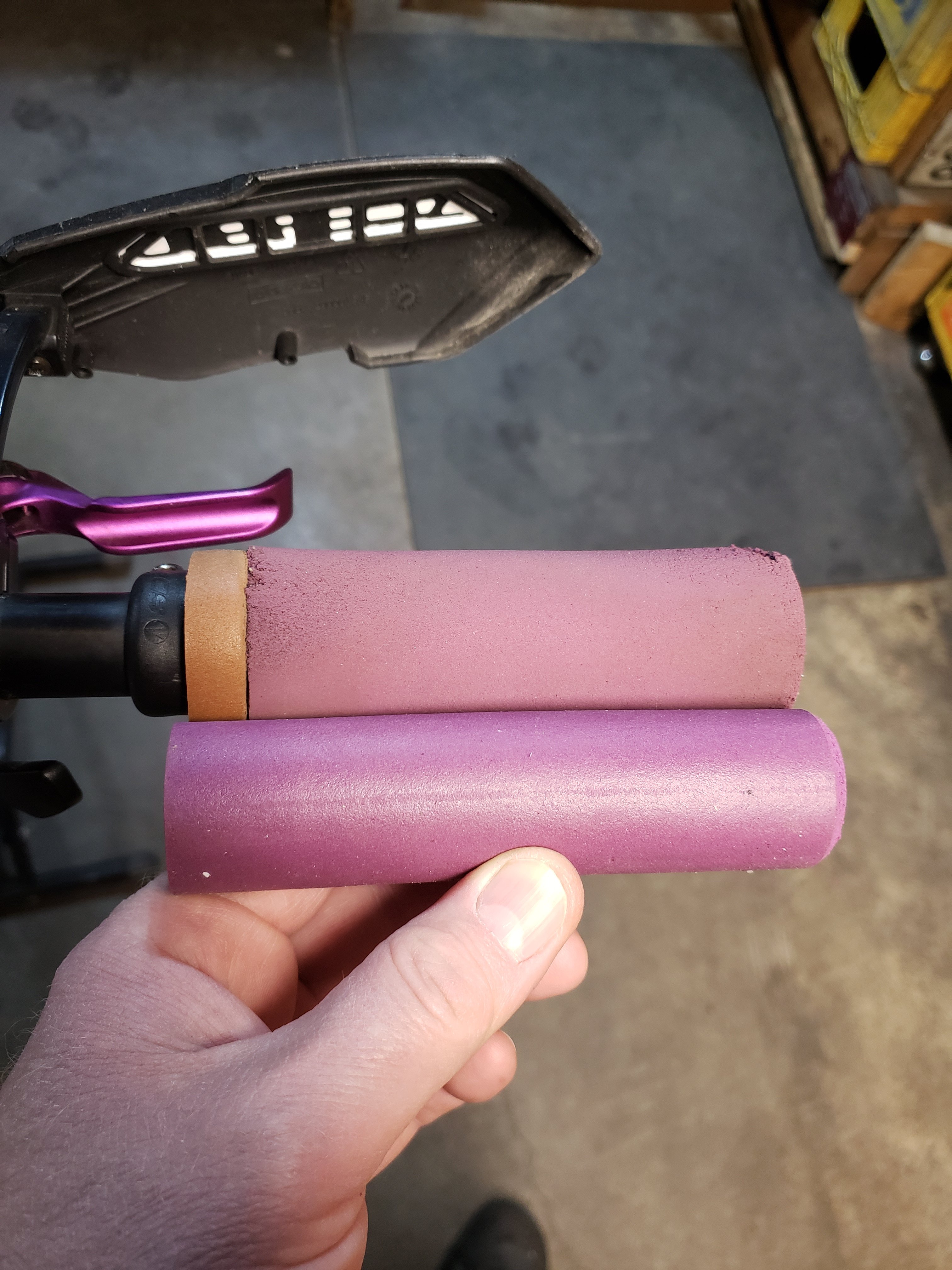

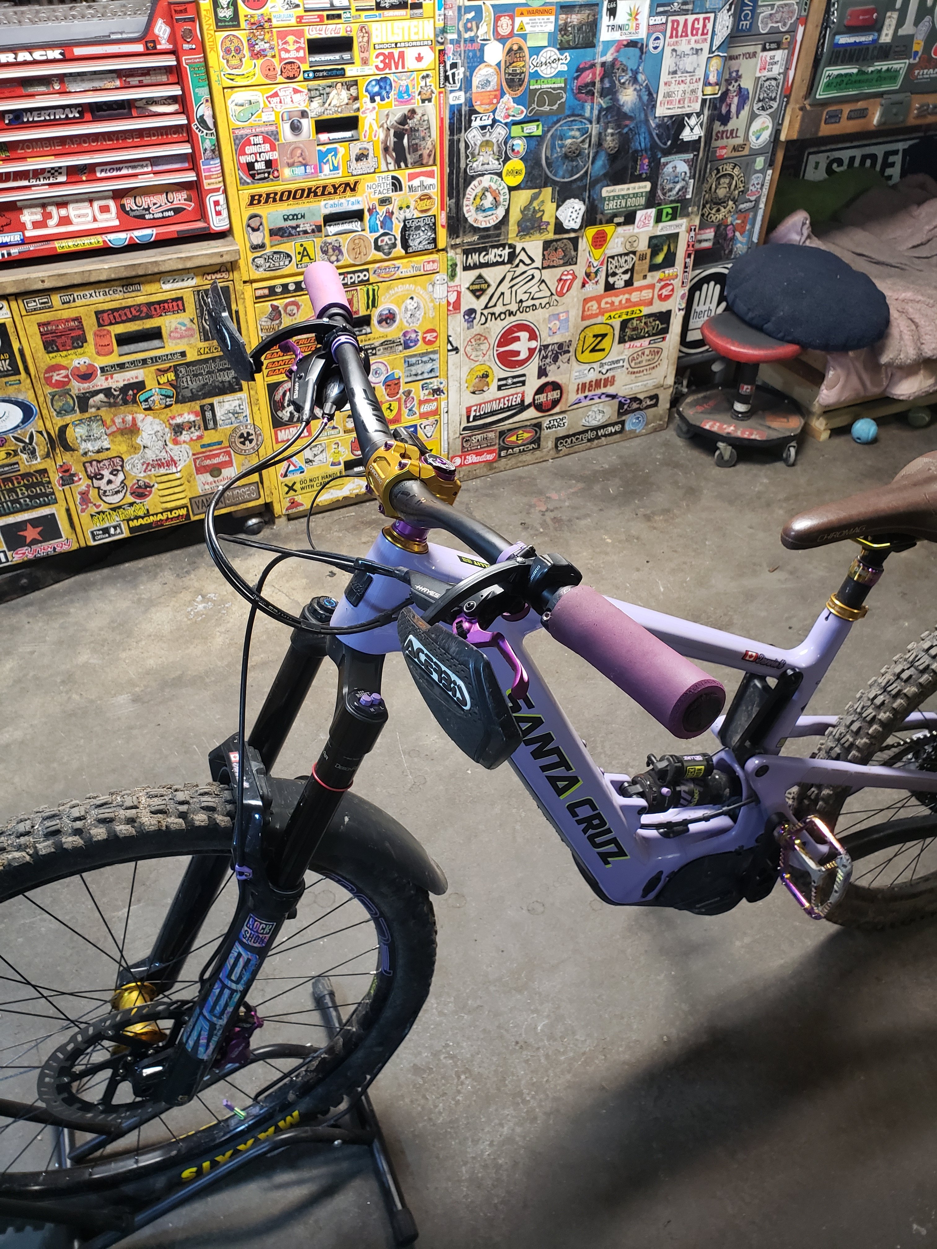

Finished the spring refresh the other day. Got some new wolftooth fat foamies slid over the old sdg lock on grips. Almost went with a stink/pink combo but decided on straight pink in the end.

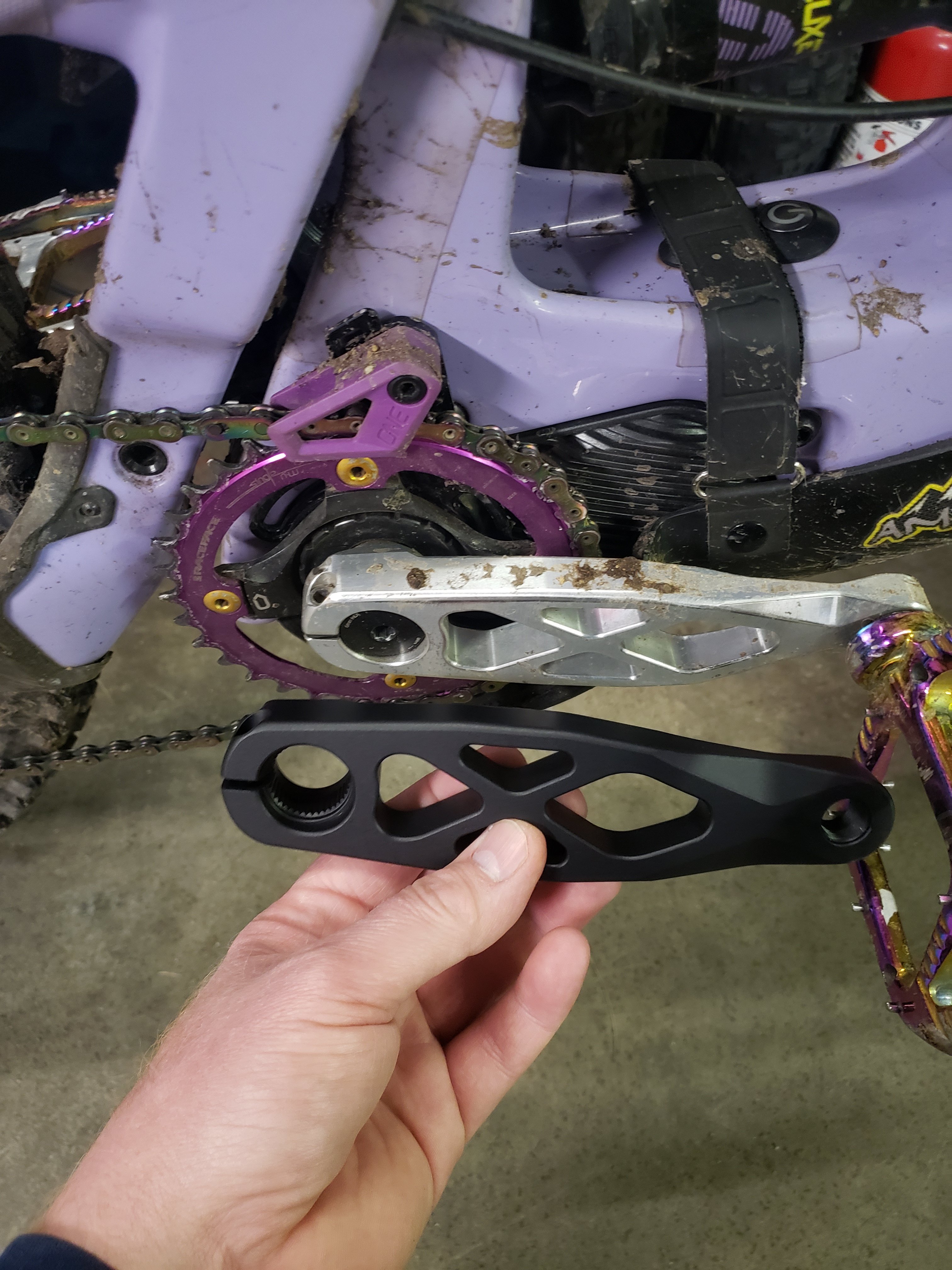

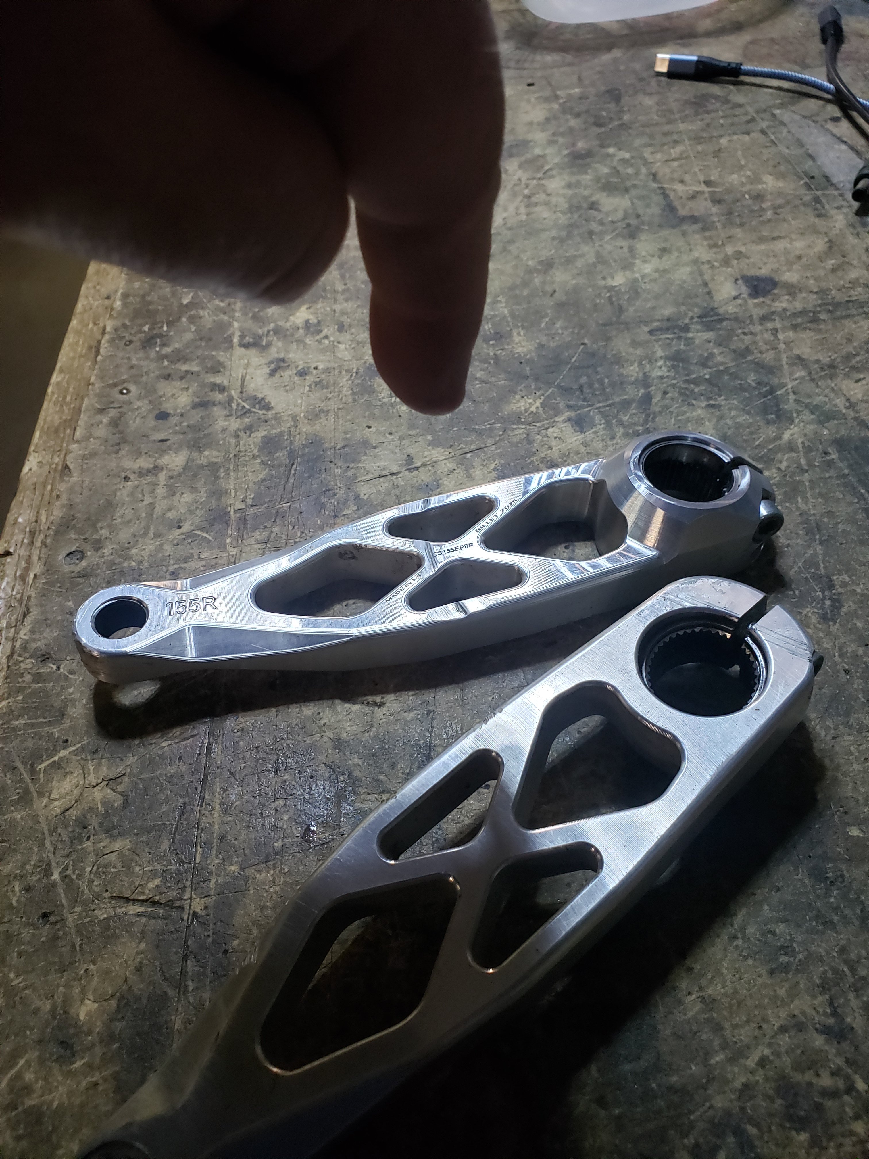

I then righted a wrong thats been bugging me by getting some black cranks back on there. 155mm black 5dev units replaced the raw ones that had some good wear marks where they were rubbing the amygos diaper. I've since trimmed the diaper down but some of the gouges are deep enough to cause concern... At least thats what I told myself.
Just an observation but the new crank arms are subtly beefier than the old ones and have different cutouts. You have to look close but when you do its obvious.

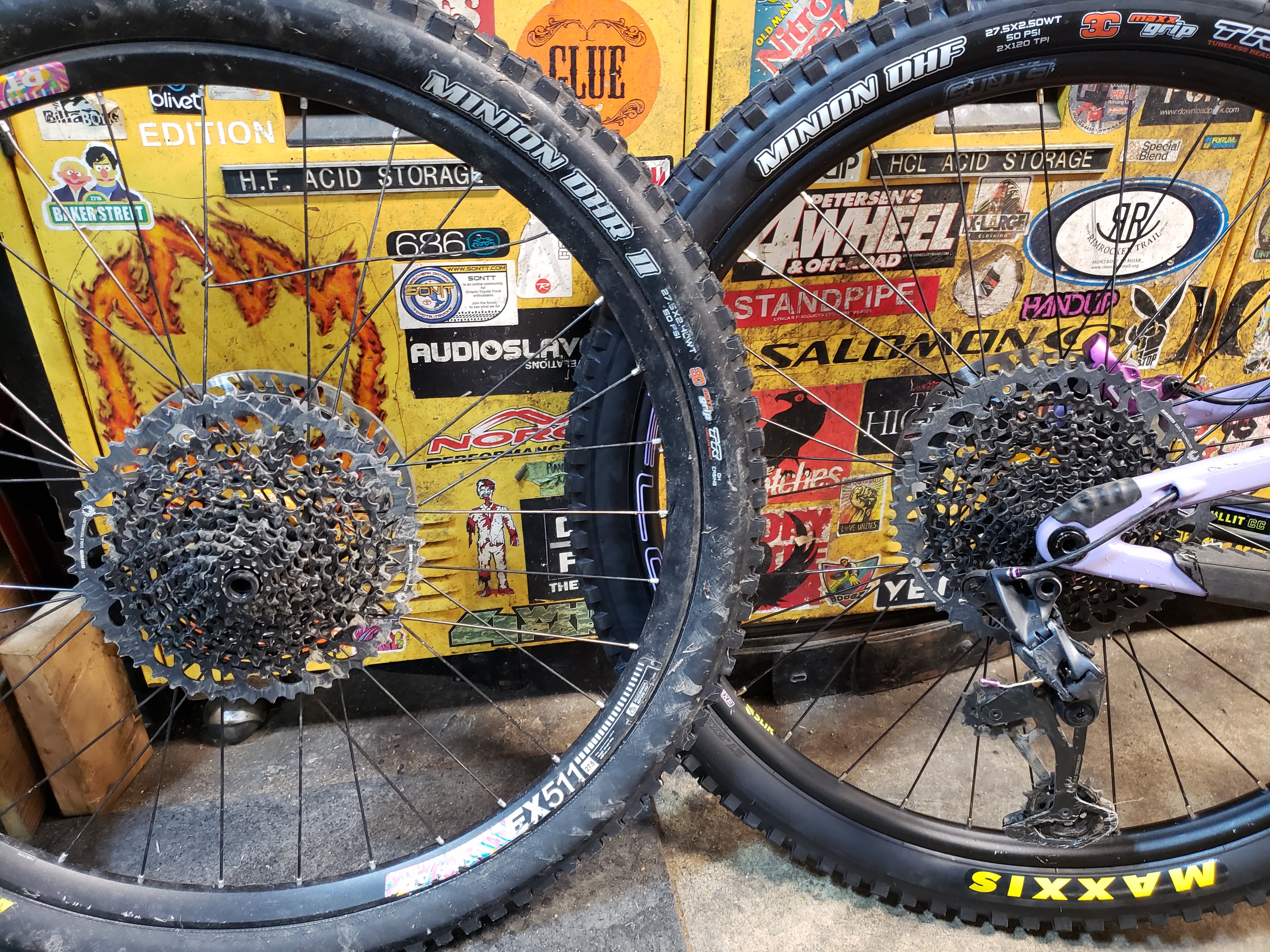

I also had to throw a new derailleur on and switch to my spare wheelset since a rock decided that my spokes and derailleur needed to share the same space. Got the wheel locked up right away but it had already broken a spoke and twisted the derailleur pretty good. As a bonus the spoke poked the rim tape and the tire went flat lol. Bent the derailleur back enough so it shifted half assed and rode er out on the cushcore.

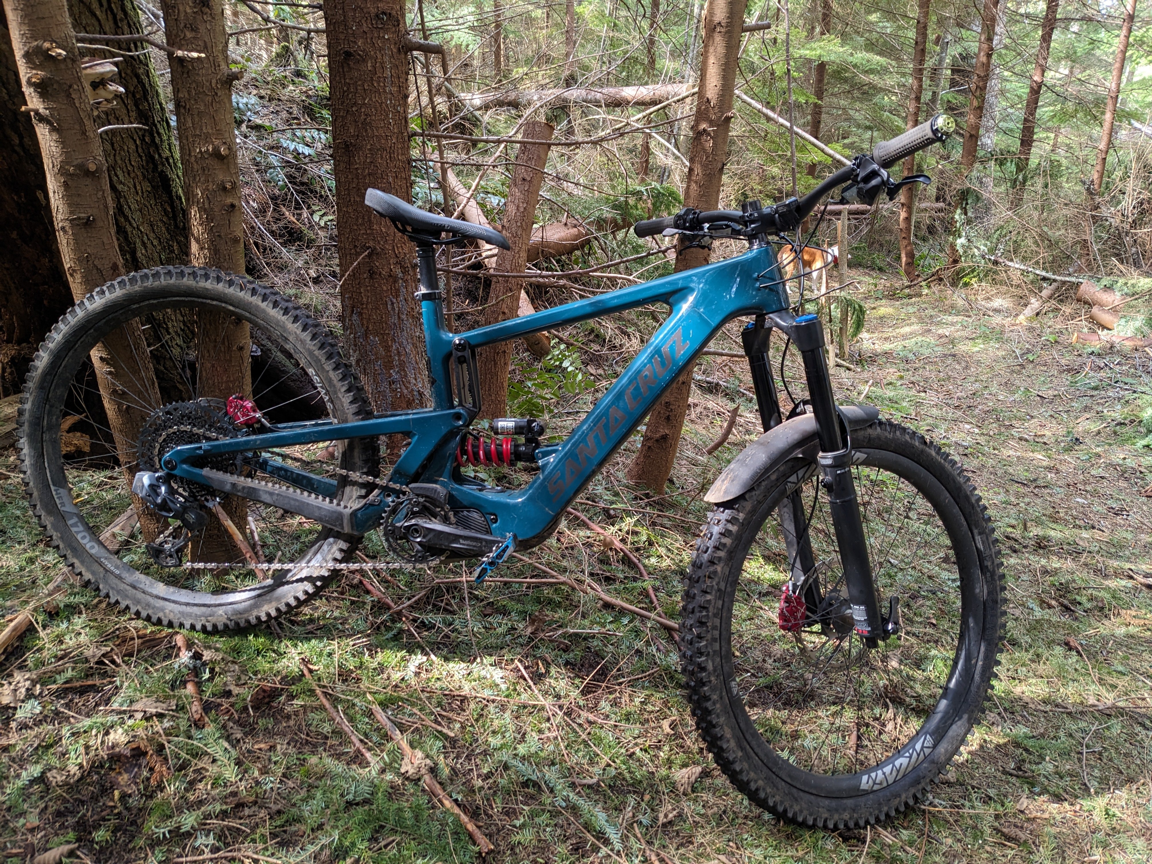

For my Bullit in early Dec and have been dialing it in. Really like how it handles and quality of the frame. Got the low end build and have pretty much updated everything.
The reason I bought this bike was my canyon tourqe on broke a rear suspension pivot and after 5 plus month the bolt was still backordered. During that time I picked this rig up on sale so I wouldn't be without a ride and glad I did. Canyon final refunded my $$ last week. I'm gonna miss it's 900 watt battery and it was a best on the dh but I'm digging the sc more.
