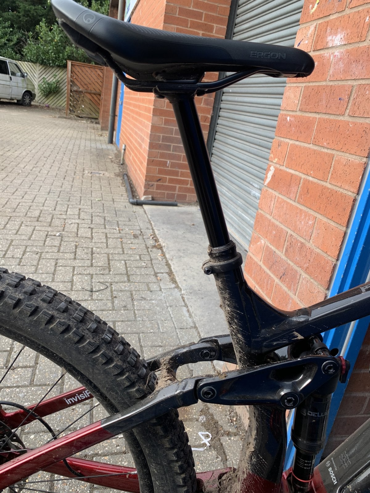

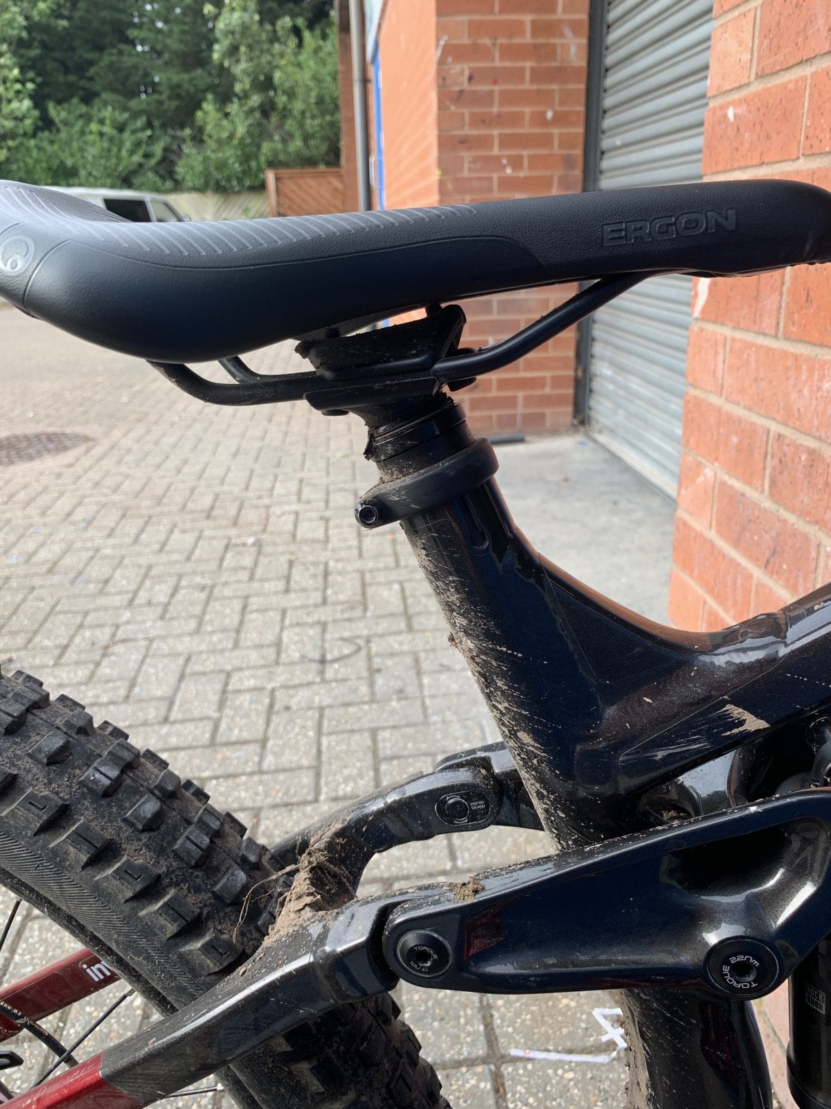

Can the dropper post be slide all the way down the seat tube?
I mean could you fit a 170mm dropper post all the way down the seat tube?
I have a 180mm dropper, it slams all the way down to the seat tube
