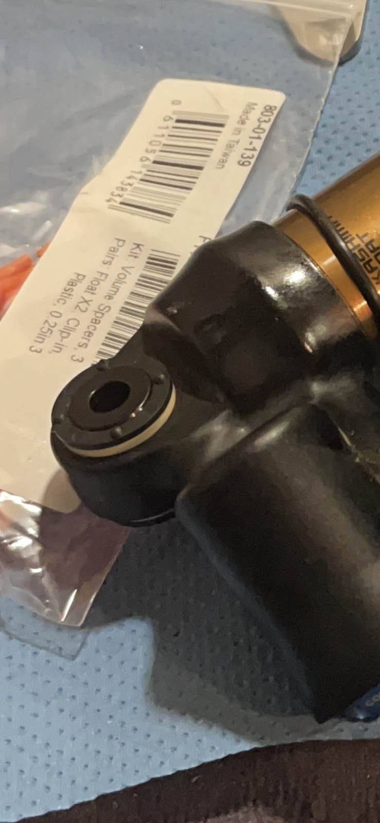

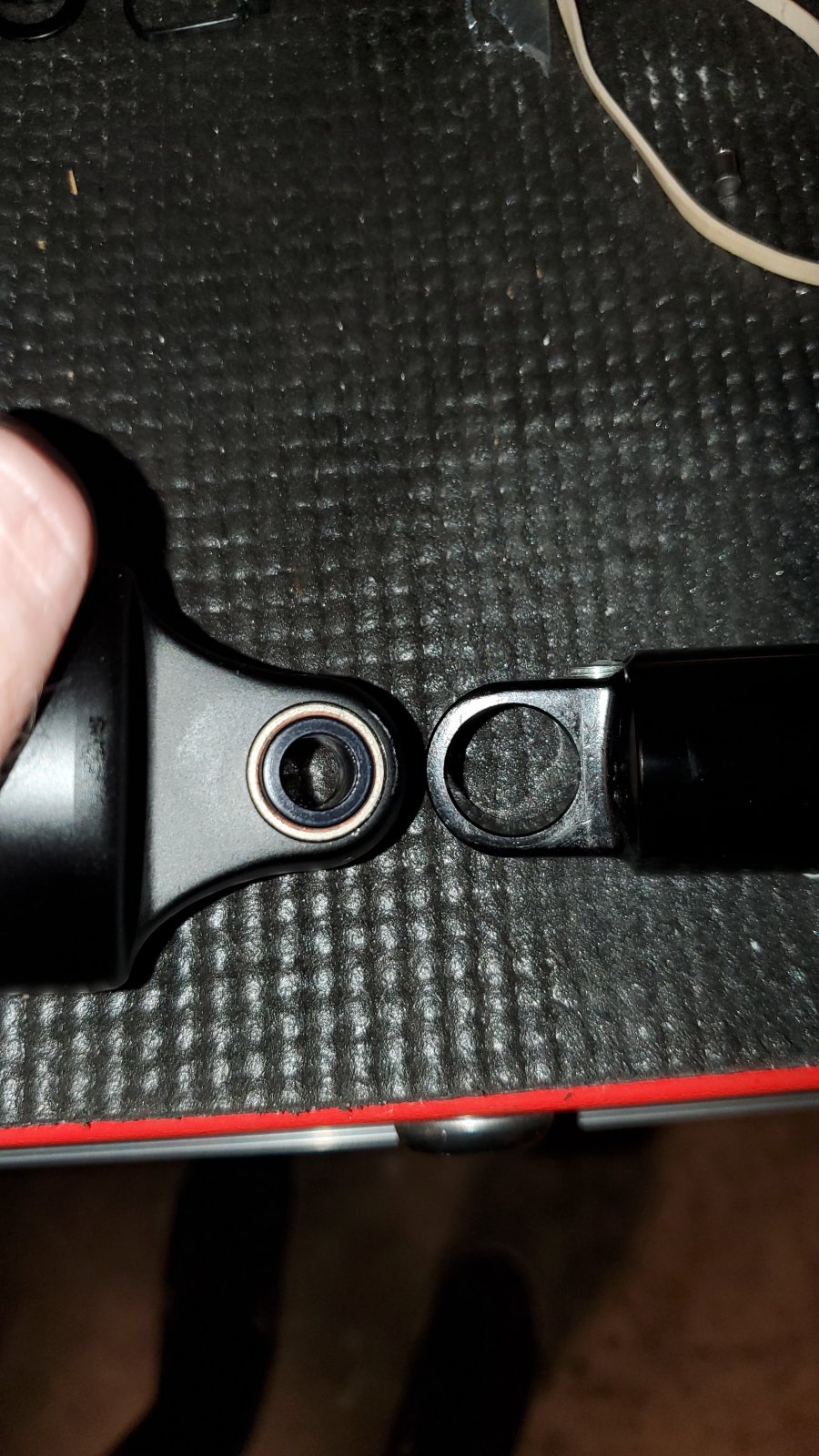

New here. I picked up my 2021 Levo Comp in September. I'm wanting to upgrade the shock to a fox float x2. Based on what I learned here it seemed like buying a takeoff shock from an Ibis Ripmo would work well. It's a 2020 model 210x55. I went ahead and ordered the shock and received it yesterday. I noticed that the X2 has a DU bushing pressed into the eyelet on the aircan side that needs to have the flip chip installed in that eyelet. Before I remove the DU bushing I want to be certain that the eyelet diameter will be the correct size to fit the flip chip. Does anyone know if this eyelet size is standard for fox across their product line? When I compare to my current DPS shock it seems like the eyelet diameter could be smaller on the X2. Maybe it's an optical illusion? Pic attached. Any insight would be much appreciated!

I've just put an x2 float on my levo, all I did was remove the du Bush and it fitted a treat ??

I called Fox and spoke to someone and they explained to me that all of their shock eyelets have the same diameter. Problem solved.

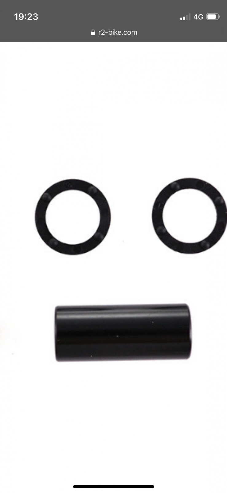

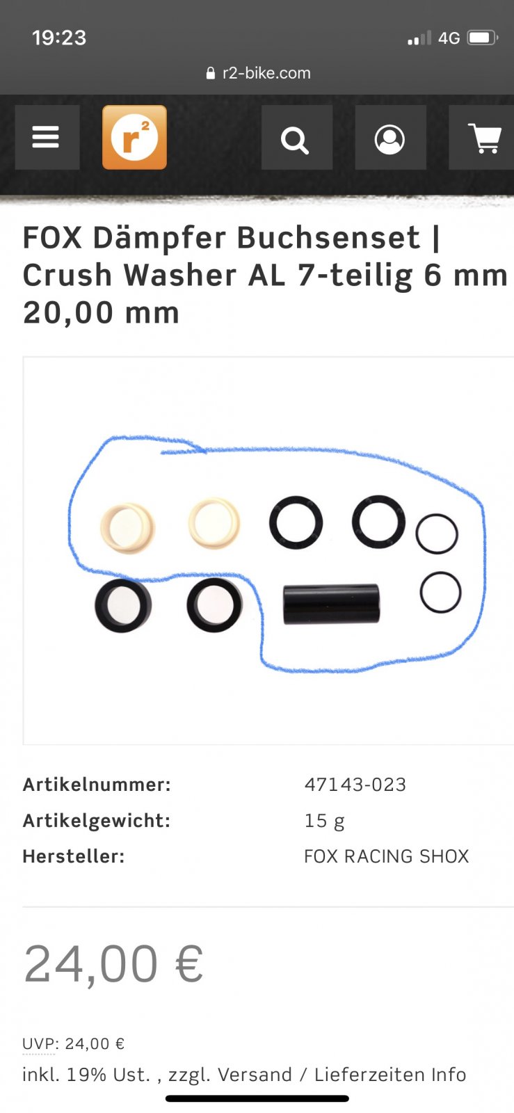

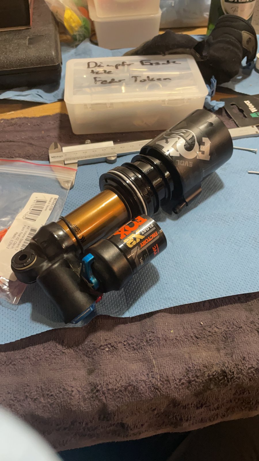

Hi Kombo, I installed previously like you but I was a bit scared cause all other bikes I have seen were installed with the new bushing sets. I installed it that way.
