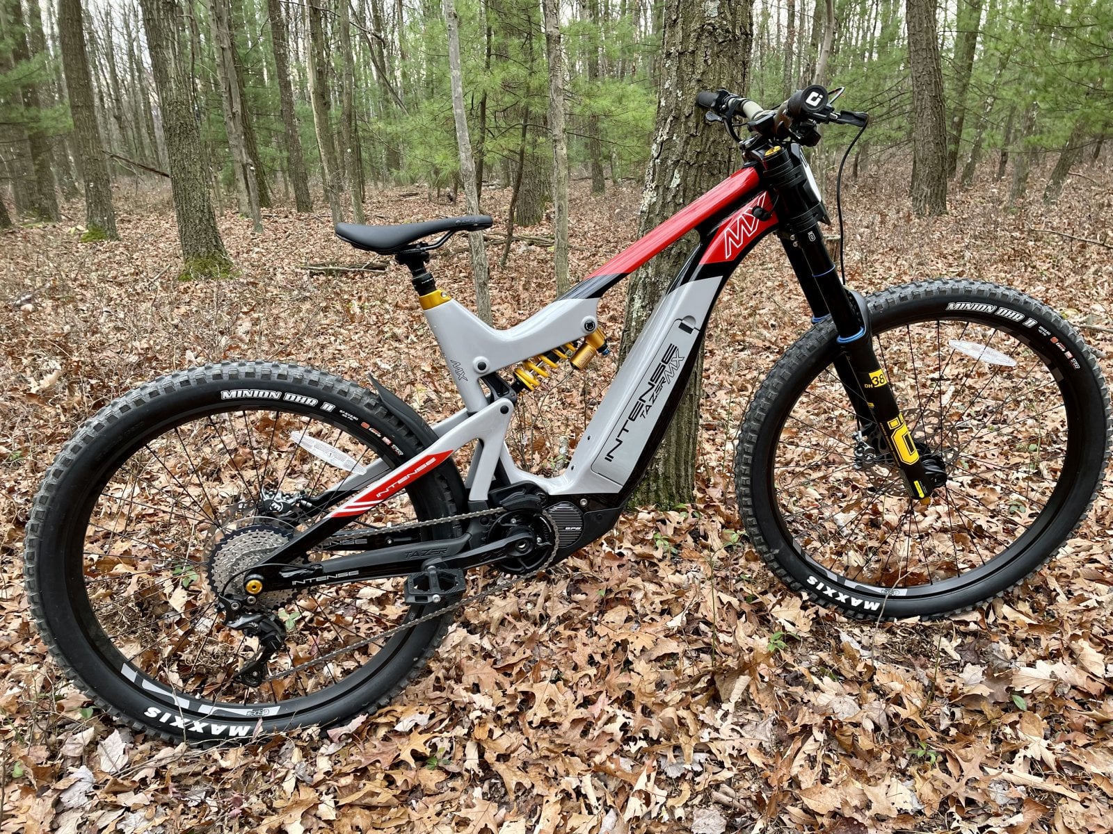

The Bike:
Manufacturer: Intense
Model: Tazer MX Pro
Model Year: 2021
Price Paid: $7999
New/Used: Brand New
Score (out of 10): 9
Review: I now have a couple rides on my Intense Tazer MX Pro and starting to get a feel for the bike. For background I am 6' 2" tall and 190 lbs and ride motocross most of the time and e-MTB's have been a fun off road riding option for me the past few years. I picked up an Intense Tazer Expert this fall but had my eyes on the Tazer MX models. I like how the MX Pro model comes with Renthal handlebar, ODI grips, Magura brakes, and Ohlins suspension. Every time I test rode a Tazer the bike just felt right while standing and cornering which gave me confidence while riding. The Ohlins suspension on the Tazer MX Pro I test rode also really stood out to me.
I bought the Tazer MX Pro model (MSRP $7999) which includes a full carbon frame and rear triangle, Ohlins DH38 dual crown race fork and Ohlins TTX22M coil spring shock, Shimano Deore XT drive train, Magura brakes, and Ethirteen wheels with Maxxis Minion DHR tires. The Tazer MX Pro has the Shimano EP8 motor which is rated at 85Nm peak torque and comes with a removable 504Wh battery. My first ride was a cold (45F) day on some rocky trails on a mountain in Pennsylvania and I have now ridden the Tazer on some tight trails in Ohio. The Ohlins suspension stands out with such a fluid and friction free feel that absorbs the bumps and gives the bike a planted and plush feel on the trails. The forks are very adjustable with a ramp up air chamber on the bottom and upper air chamber both can be tuned to dial in the desired fork feel. I am now running a lower pressure up top with the recommended ramp up pressure and the forks are supple at the top of the stroke and still have great bottoming resistance. The geometry and layout on this size L/XL MX Pro distributes my body weight at the handlebars and pedals perfectly. The handling is confidence inspiring especially on downhill sections. For a 51 lb bike the MX Pro feels surprisingly lightweight in motion though I feel it when lifting the bike into my van. I like the Mullet layout with the big 29" front wheel rolling over the trail junk and the smaller 27.5" rear wheel helping the bike feel smaller in the tight corners. I regularly ride 90Nm rated Brose motor powered e-MTB ('22 Levo Expert) and the Brose motor has a lot of power and torque feel, especially at low pedal RPM. I have some miles riding on a Shimano 7000 motor and the Shimano EP8 in the Tazer MX Pro feels similar only with more power. While the Shimano EP8 motor does have a little less torque feel (mostly felt at very low pedal RPM) than the Brose 2.2 motor the assist from the Shimano EP8 motor feels strong enough. The Tazer's Shimano EP8 motor has (3) modes to choose from (Eco, Trail, Boost) with Trail providing a very natural feeling assist level and Boost (my favorite) giving full assist which is helpful on steep technical climbs. The Shimano e-TUBE tuning app does allow for motor power character tuning though I have not made any changes to the stock settings so far since the power feel in each of the (3) modes feels very good. The Shimano motor feels stronger at higher pedal cadence as the assist seems to increase with higher pedal RPM's. The Shimano motor also feels almost friction free as the speed goes past 20mph and the assist drops out.
Negatives: As many ride reviews have noted the Shimano EP8 motor does have rattle noise, mostly while coasting over over sharp bumps. Not so noticeable on the smooth trails. The smaller 504Wh battery has more than enough range for my rides but may lack the range needed for some riders though a spare battery is an option for longer rides. The dual crown on the Ohlins DH38 forks limits turning radius. Not an issue on wide open trails but I did hit the turn stops on some slow speed tight turns.
Overall : The Tazer MX Pro is targeted at moto riders and looks the part with Renthal handlebars, ODI grips, and Ohlins suspension (especially the dual crown forks). For a moto rider like me jumping onto an e-MTB like the Pro MX Tazer "just feels right" - like I am riding my dirtbike. Now I have a MTB that feels like a dirt bike and a dirt bike (KTM 125XC) that feels like a MTB!

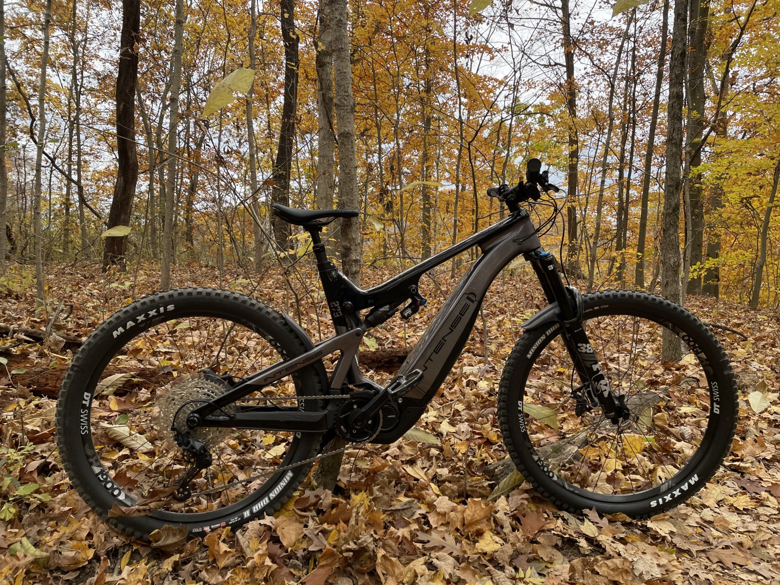

Yes a darker color does help hide the wide downtube....my Tazer Expert
