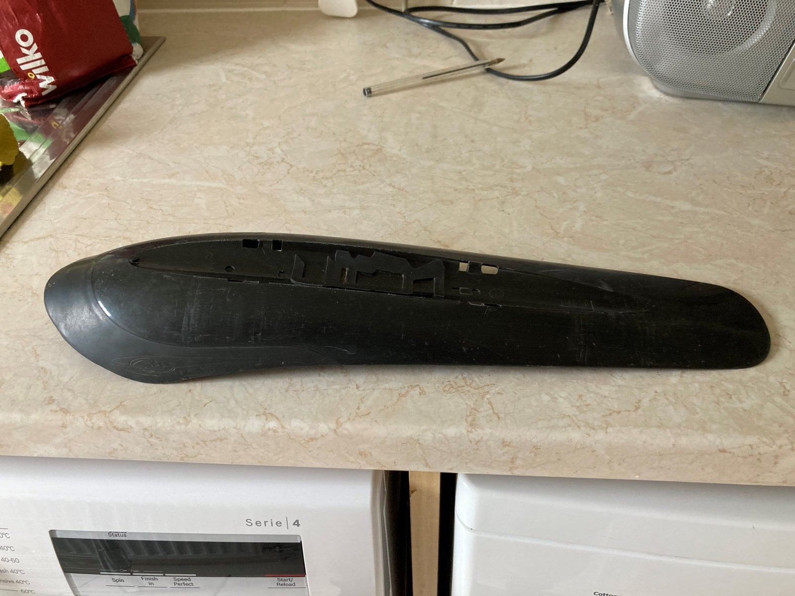

You will have a wait of several weeks, so you will need to protect the battery in the meantime, as all the crap from the front wheel goes straight onto the battery area. I used a front mudguard [ the type that fits onto the downtube], cable ties, and some gorilla tape. it doesn't look great , but keeps the crap out.

This is the type of mudguard that I used

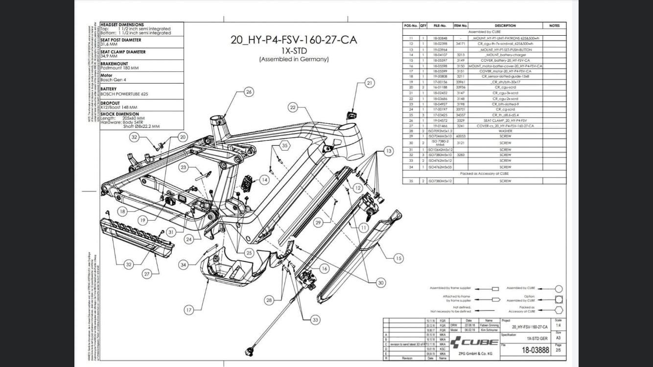

Sorry, replied without reading the post with the diagram. So it would be no13 on the list.
billwarwick
Oct 1, 2018
607
1,297
warwick
And of course no15
15 is the plastic cover. Think he was only after the latch. But thanks, the diagram will be really helpful for folks??Think the latch will be for all models (120, 140, 160) but the 120 has a different part no for the cover.
