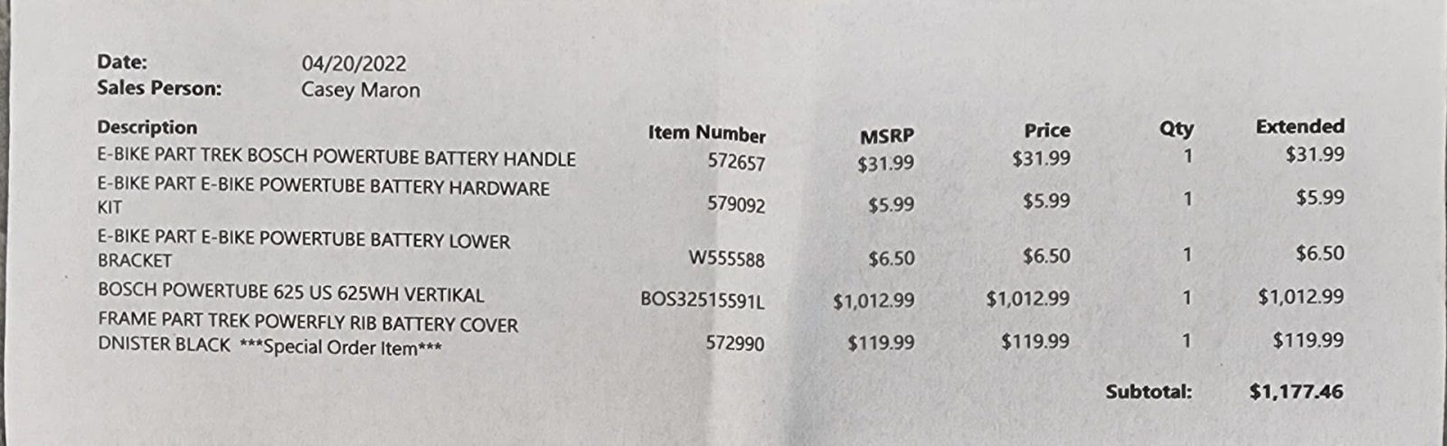

I'm doing a 200 mile ride in May and am thinking if I get an identical second battery I can charge one while I ride the other.
I see my 625Wh battery is vertical and has part number 0275007546. Does anyone have a listing of parts needed to complete the entire build of a spare and pricing. Best I can see so far for just the battery is $944.
I'm even hoping to buy a purple phase cover just like my original. Any help/advice would be appreciated. I noticed Atlas did a great post on another similar thread. Hoping you guys can chime in on the best place to source a second identical battery to the original for double range.

2021 625Wh entire spare battery parts that are needed. I couldn't get a matching purple phaze cover. They are 12 months special order!! I went with the only cover I could get within 10 days.
1. Powertube battery handle #572657
2. Battery hardware kit #579092
3. Battery lower bracket #W555588
4. Powertube 625Wh Vertical #BOS32515591L
5. Battery cover of your choice #572990
