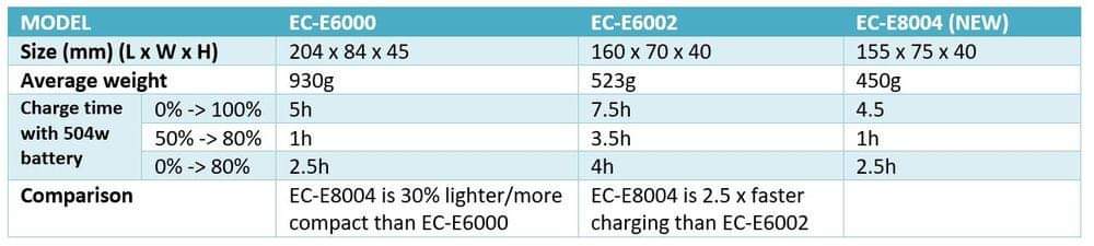

I won't be rushing to buy the new charger for 30 minutes advertised faster charging.

Personally i'd rather have the charger run slow from 80-100 to protect the life of the battery. What is most desirable is a small lighter charger for those carrying it around with them, I suppose they are thinking portable here hence the faster charge rate that would be more desirable in this use case.
