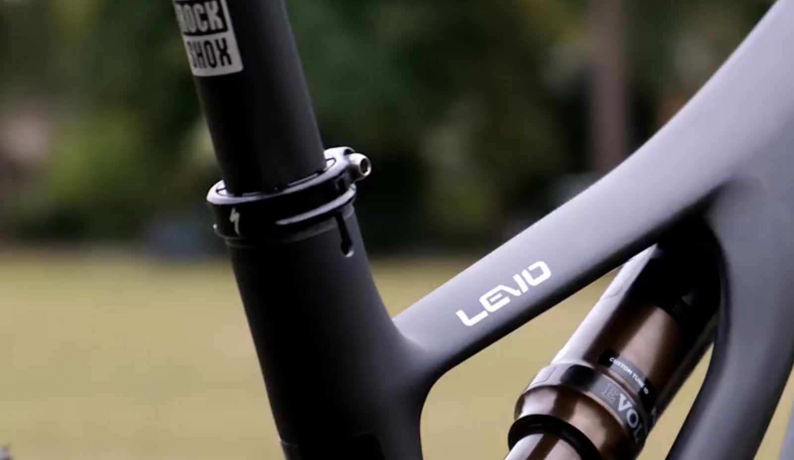

Seems there is a shim:
screenshot from (end of) video:

It does indeed look like it... Wonder why they would do that rather than using 34.9 straight in like the others...
I could imagine that they ordered a one size stock that they can use for the Levo and Stumpjumper and Epic .etc...some of the other frames only allow 31.9 size .

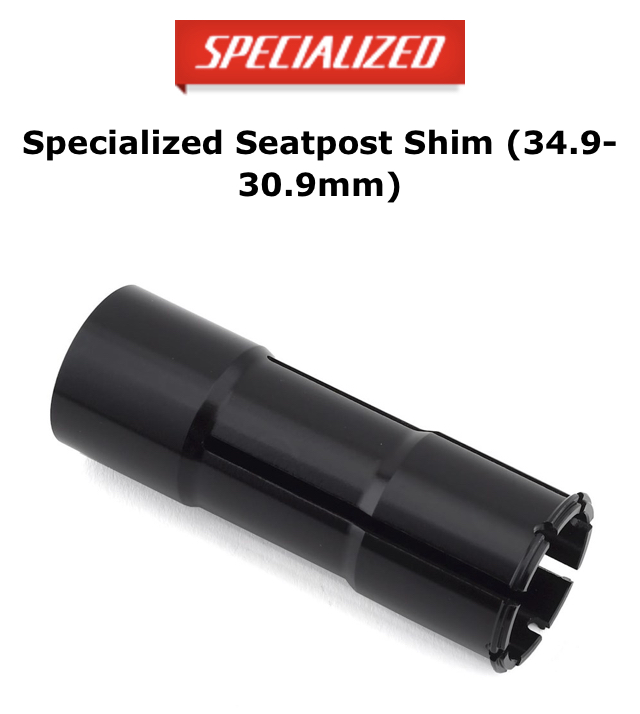

All Enduros 2019, Stumpjumper S-works 2020 and Levo S-works 2020 have shims. Dont know why but it seems perfectly normal for Specialized to drop a seatpost reducer shim on their carbon bikes.
And yes, you can run a 34.9 dropper on a Levo S-Works

As a Specialized dealer, we see tons of these 34.9 to 30.9 shims. They started doing them back in 2018 or so. It allows you to run a longer and stiffer 34.9 dropper if you want, or a easier to source 30.9 post.
And many many models came with a 30.9 dropper and this mentioned shim. My guess would be that when they started producing the 2020 Levos, there was no 34.9 AXS dropper available and so they simply spec'd a 30.9 with the shim.. No big deal. I have run these shims in 3 different Enduro frames and my wife has one in her Levo to accommodate a 30.9 dropper that I had sitting around.

My rep is standing beside me and confirmed that all the Levos are 34.9 seat posts.. Just the Sworks comes with the shim and a 30.9 AXS post..
We are guessing that when they started making the 2020 Sworks bikes last year, the 34.9 AXS was not available yet. So they speced what was available and they are not going to break brand new bikes out of the box and buy new posts and replace perfectly functional 30.9 posts with 34.9 posts when the shim works just fine.

Your frame will come as a 34.9. I understand not wanting to use the shim on a principal basis on your 10k bike.. But from a practical standpoint, I seat bounce my 215lb fatass over 30+ ft jumps on my downhill bikes with a shim in a seat post.. And I have a 170mm dropper post on my aggressive hardtail and beat the shit out of that bike with a shimmed dropper and have had no issue.. But I get the principal of not wanting to use it.
And all the carbon Levos we have on the floor run 34.9 droppers and they share the same frame as the Sworks.
