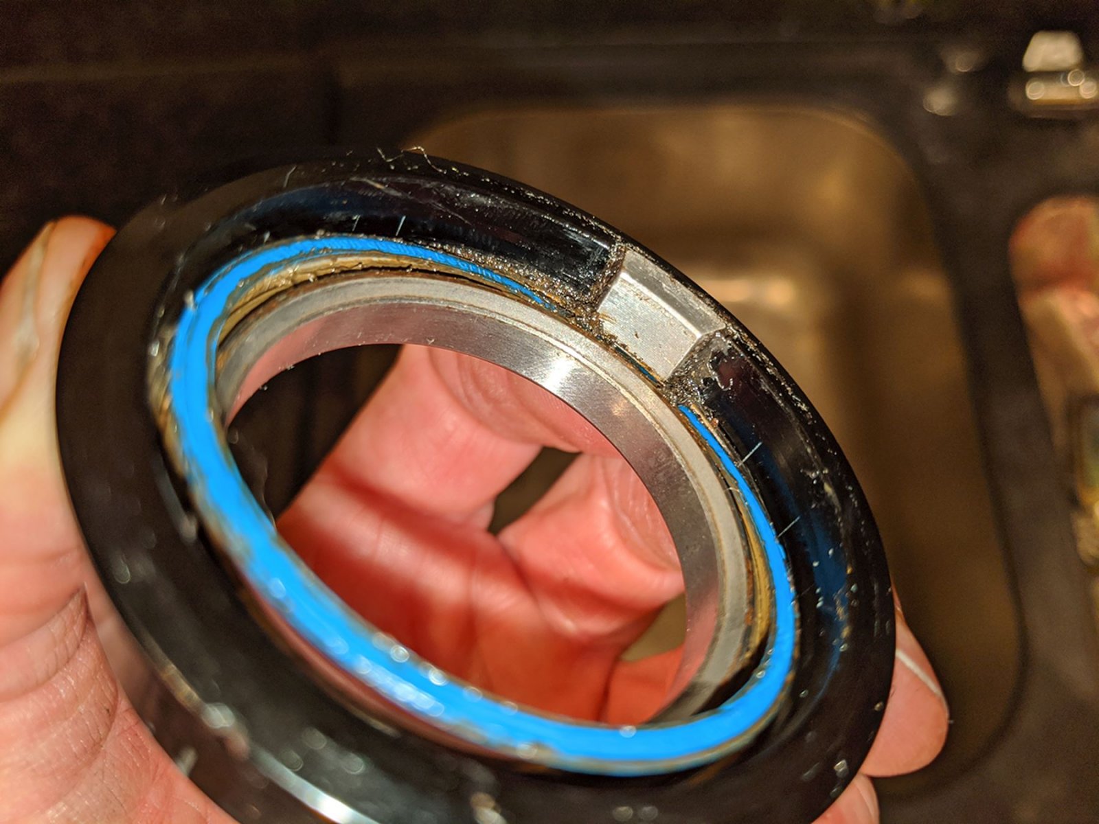

Moral of this story: if you're dumb you can kill bearings really fast.

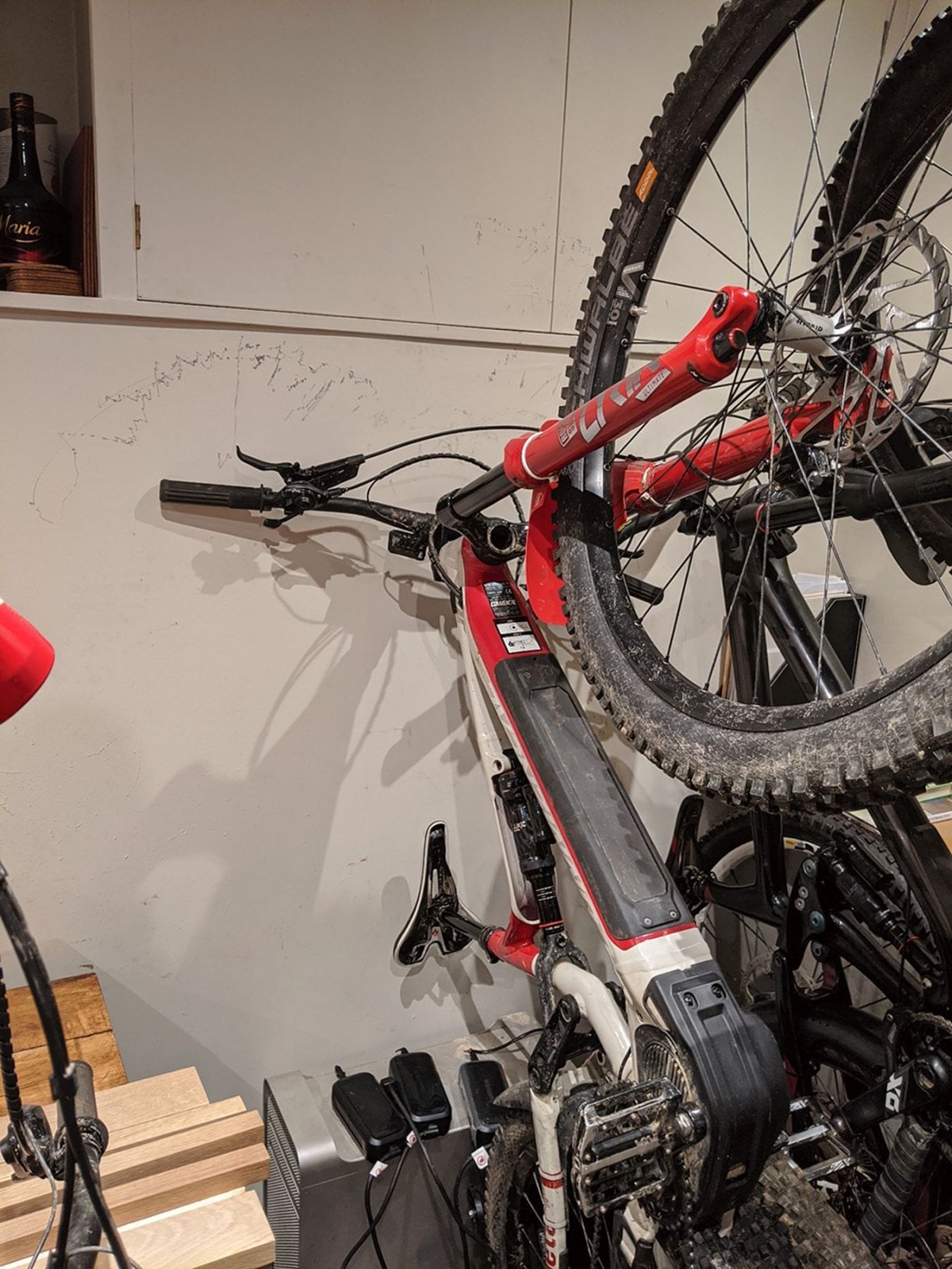

I store my Meta Power standing up on its back wheel with the back wheel in a rack.
The headset lower cup has a deeply recessed bearing because of the steering limiting block...
If you wash your bike and then store it upright as shown without the water getting a chance to drain out of the headset area, water pools in the headset directly over the seal. The bearing is underwater. The bearing seizes. This happened within one month/10 rides/300km/~6 washes.
My other bikes have never had a problem with this because the bottom bearings aren't recessed like they are with the steering limited headset.
Just a quick warning for those of you with wet climates or obsessive bike washing habits.

Weird. That's usually an unevenly cut steerer tube which the Hope would also be having to deal with.
I'm happy to replace mine. My levers are flat so won't hit anything.
The standard fit headset isn't something you can service easily with new bearings. If it was worth saving and I could service it with new bearings, I'd lift the seals on the new bearings and get a good marine grease in there. I'd still expect eventual problems from the recessed bearing location.
I've fed back to Commencal that I don't think it is a good component and the purpose of my post here was for people to hopefully get a bit more life out of the standard part.
