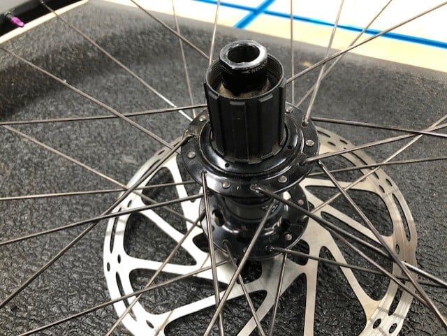

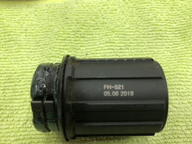

Referring to a 2020 Levo Comp. Several owners have had issues with the hub stripping, so I would like to do a preemptive strike. Are you guys replacing the whole hub assembly and re-lacing the wheel or can you just change the free hub itself to a more durable unit? I know this has been discussed in other threads but...... I'm a little confused since some refer to a hub as the freehub or hub interchangeably. If the freehub can be changed only, what are you using to replace the FH-521?

Its the same design as the 2019 comp and I have not seen any failure reports. What do you mean by "stripping"?. Mine has been fine....just serviced it once so far.

While it’s the same design as the 2019 hub, there are different spec numbers in the metals used and there were refinements in its manufacturing. It’s a Formula free hub body, other brands are using the same hub body and the entire hub shell. Haibike uses it and it’s called the hub and it’s the same hub sram rebrands and sell as their hub. You can pick up the sram hub for $50 and get a complete freehub and axle to rebuild it for cheap if the need arises

To be honest if you use a pressure washer on the rear wheel neither hub bearing or freehub bearings and pawl system will last very long. The freehub needs fairly regular maintenance to avoid the pawls getting clogged with dust etc. A 4 pawl freehub is only marginally stronger and faster in terms of grab but weaker in terms of torsion since the diameter of the face in which the pawls seat is the same and more metal is cut away to seat 4 rather than 3 pawls. The adjuster nut needs to be checked occasionally to ensure no play on the freehub/cassette. The one critisism I would have for the freehub and hub is that neither is well sealed. That just means more regular servicing....basically just cleaning

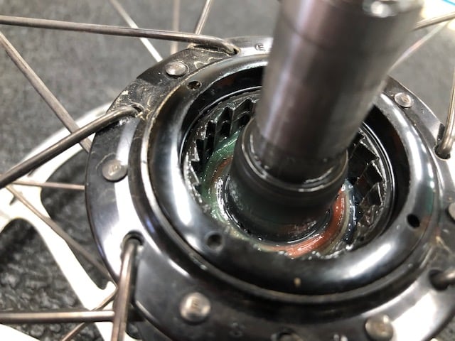

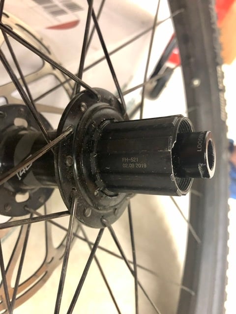

Jimtonicc
Jul 8, 2020
9
Riehen
My freehub broke after 100 miles, see attached.
How can I find out which ones are compatible with my Levo Comp 2020?
And how do I get the formula hub off? Can’t figure out the mechanism.

I think you have to remove the axle.

I tried to turn the axle in the indicated „loose“ direction and hold the other end - but it didn’t come off.

The lock nut on the drive side is reverse thread. Hold the lock nut on the non drive side and remove the drive side locknut. The freehub should then slide off. Its a Shimano 3 pawl freehub.

10 sp? On a 11 speed cassette? The reference number for the freehub is printed on it on the photo....Shimano 501.
Given the damage on it I would check whether that was caused by a collapsed freehub bearing or the cassette. (SRAM PG1130 11-42
If you have no visible lock nut on the non-drive side, then pull off the end cap (if it doesn't come off with good pull by hand, grip "lightly" with a set of pliers to pull off). Underneath the cap you should find some way to keep the axle in place while you loosen the nut on the drive side. On my Creo, which uses a similar formula hub, there is a set of holes in the axle that you can put a small screwdriver in between to hold the axle in place while you loosen the nut.

If it is the same as my my2019 Levo Comp there is a nut and locknut on the non drive side. They secure the axle in the hub. I have a single nut (no lock nut) which is reverse thread, which holds the freehub onto the axle. To have damaged the outer edge of the freehub as per the picture either the freehub or the cassette has come loose or a freehub bearing has collapsed. The latter seems unlikely since there are 2 cartridge bearings in the freehub.

I managed to get the nut off with a 9mm socket thingy - finally! Hard to find a tool that is thin enough to fit into the hole (the one that is covered by the cap).
