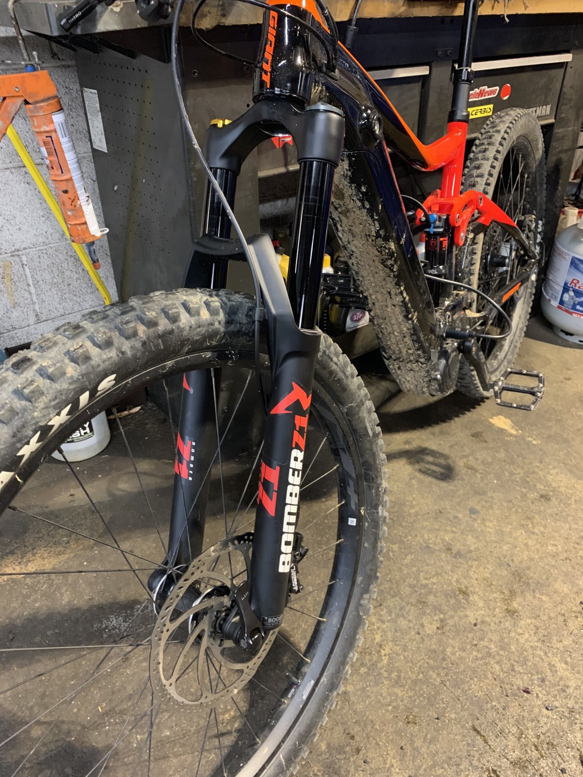

Tough call there Steve. They are close in what they both offer (sort of). Same chain stay length but the Reign does have that slacker front end (64.5 vs 66.5) which makes it more Enduro friendly. Better component spec & longer travel front & rear. FYI / Ive pretty much converted by Trance to an Enduro set up w/a full Marzocchi coil susp (170 front & 150 rear coil).
Dont think youll be disappointed w/either. If it were me, id likely go Trance w/the $$$ savings & up-spec the suspension straight away

Go ahead and order a 160mm Bomber for the big stuff. It will make that Trance a true do it all bike. But not as awesome as the Reign of course, but we tried to tell you that earlier. ?
