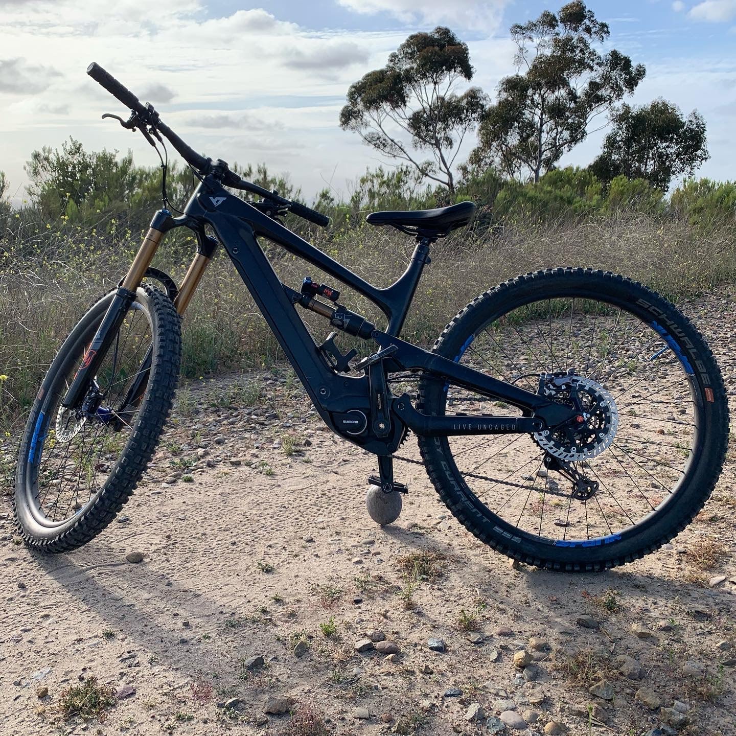

fox 38 forks 170mm
fox x2 shocks 230x65
yt decoy base 29
feels very similar to the yt capra 29 very capable uphill much more fun downhill

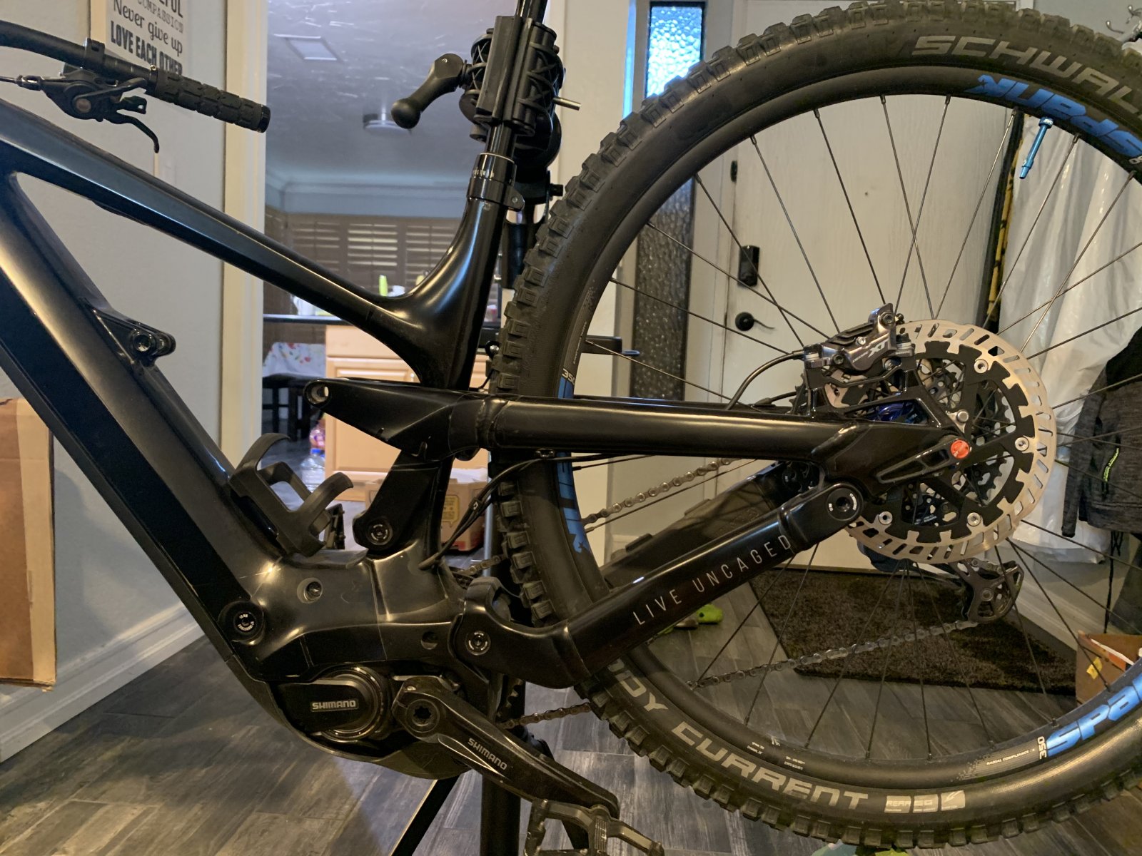

before setting the air pressure up i did a rough measurement its minimum 165mm might be even closer to 170mm i ordered a sturdy stand from feedback so i can get a better measurement

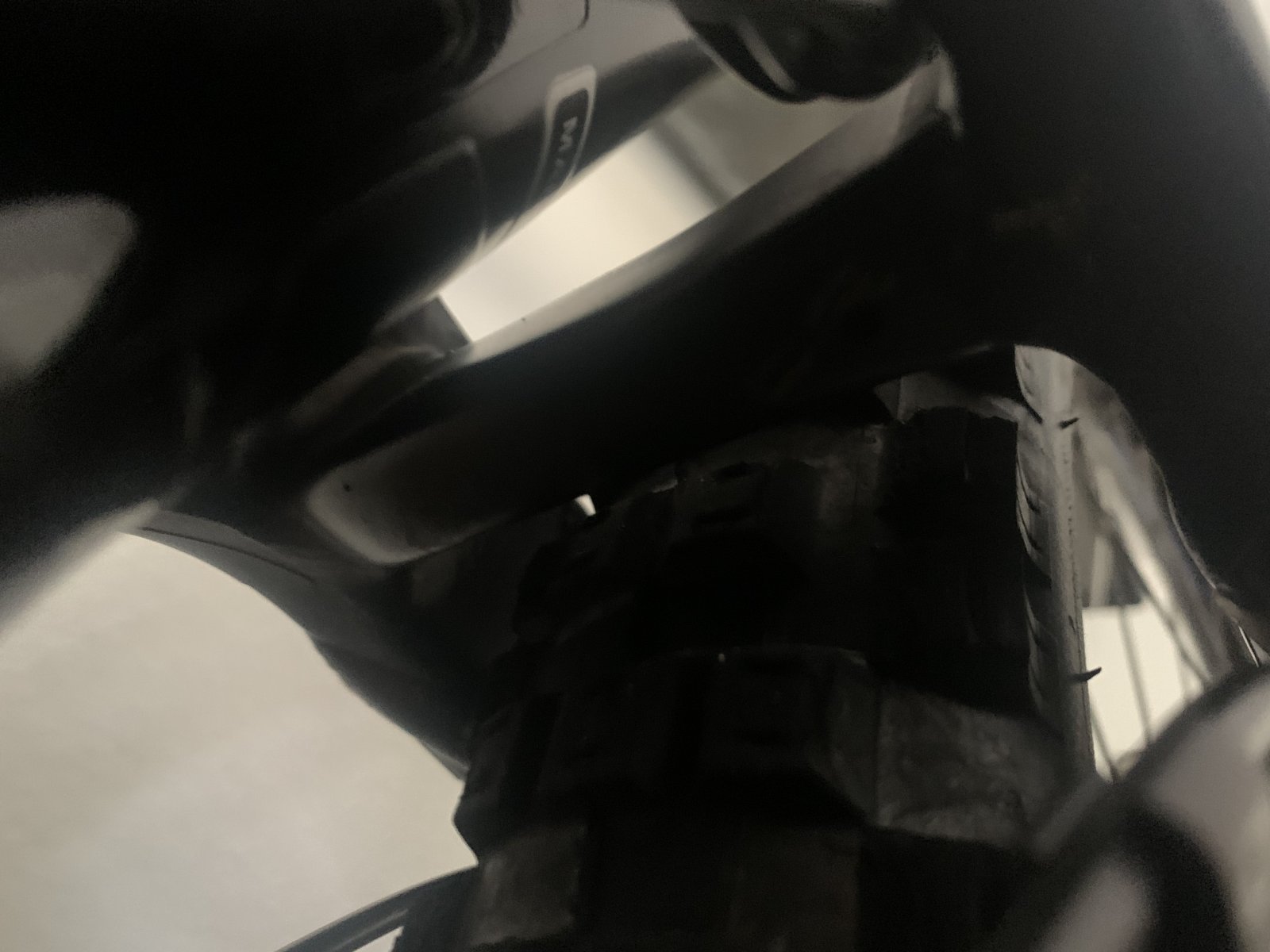

Any luck measuring that rear travel? I am so close to pull the trigger on 29er :D
did a more stable measurement. 6.25 in = 158.75mm thats with the 230x65 foxX2 shock. i dont know how much the bump stop/buffer give. its safe to say 160mm rear. not an engineer whatsoever so take it with a grain of salt. good luck

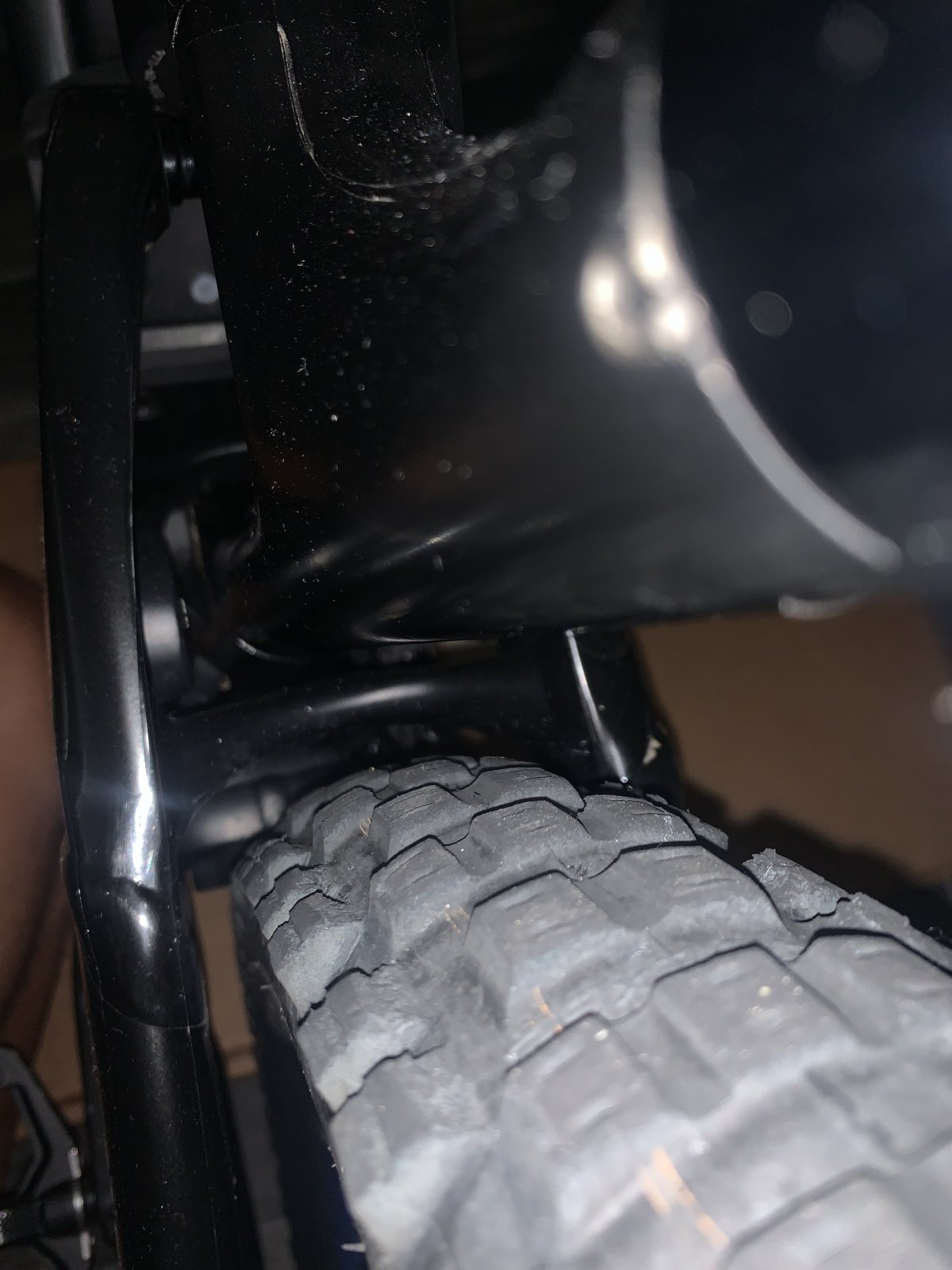

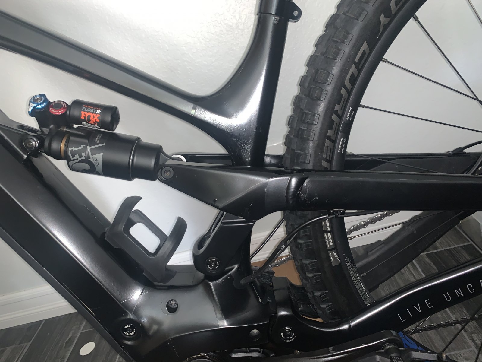

still didn’t get to measure. but here’s a pic of the rear suspension at full compression. no rubs View attachment 59925
any chance you could take a picture from above showing what clearence you have with the shock fitted and fully defalted, reason I ask is if I remove the shock as per the picture with the bike on the ground the linkage touches the seat tube, thanks in advance.

I've uppped the air spring to 160mm and looking at having the 5mm travel spacer removed from the dpx2 to have 65 stroke so I'm keen to see the clearance

8mm should be plenty. Sweet mod. Wish there was a 230 x 70 or 67.5. I would up stroke my mullet decoy. 225 x 70 with offset bushings reversed but 225's are all trunion mounts i think

Tried a 230x65 dpx2 on my 29pro as per the original post and when it's fully deflated and your sat on the bike you have no more than 1mm clearance between the the seat stay bridge and the seat post now maybe the bridge is thicker on the CF models over the Ali base models, but call me a chicken but that's to close for comfort you could use a 230x62.5 Stoke and you would have around 4-5mm clearance. Looking at the pictures above it looks like even though the shock is deflated it is not under load and I would imagine he doesn't have the clearance he thinks.
you’re right the carbon rear or pro model shouldnt try this out that piece is waay thicker on a carbon. for us base model alu rear can benefit on this set up. hucked and dropped on this set up so far no where near from fully compressing internal bump stop. havent felt any bottom outs. again take this info with a couple pinches of salt
