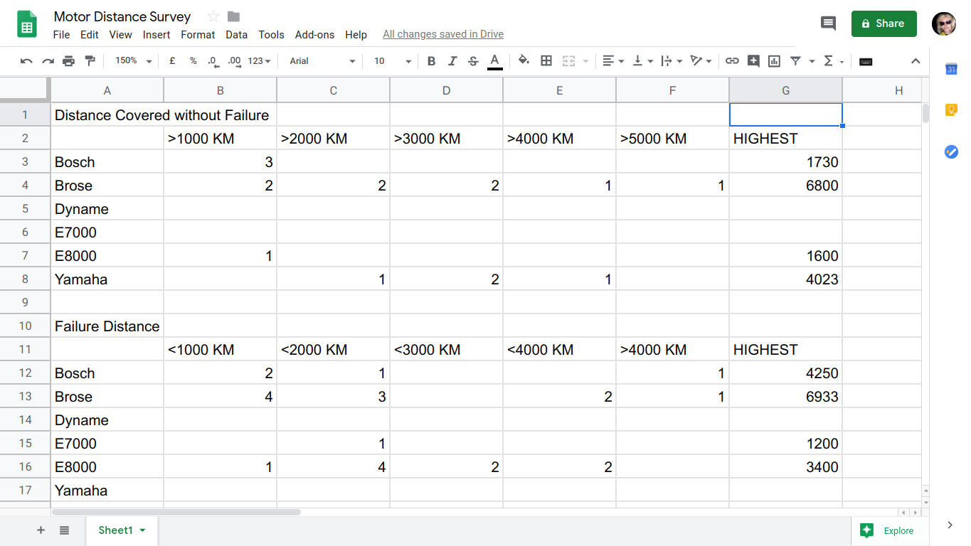

2019 Motor Distance/Failure Survey
High Rock Ruti
Ode to ZImmerframe for at least trying to quantify Brose failures.
Kudos to Specialized for standing behind their products.
Shame on Brose for not working to reduce failures. (3 belt failures 1 Sprague clutch failure)

I can't do this as a poll, so I'll have to update the first post manually, so either put your information in the thread or PM me if you don't want it on the main thread..
This isn't a competition so there's no need to make anything up and there's so many other possible variables that it won't be conclusive but it should give some general ideas of what the motors are capable of life wise - in ideal circumstances (the ones with the highest distances presumably were made without defects and looked after perfectly).
When I say other possible variables, for instance, it might be that 80% of yamaha type buyers only ride up gnarly steep stuff and only ride once a month, so they don't cover huge distances. This information hopefully will just give an overall guide for comparison and it's upto you how you interpret the information.
I'll work it in KM's (just because), so if you have miles either divide it by 5 and multiply by 8 to get KM's or put it in Miles and say Miles and I'll convert it.
This is only for Mountain bike orientated motors. If you accurately (not made up over a beer) know of other distances of friends/family and likewise - failures include that also.
In the Failure section, also include failures caused by physical incident. Whilst every circumstance is different, at some point we will all be throwing our bike down a mountain or hitting a rock and ideally you'd like the motor to survive.
If I've missed a motor off or a motor type you think should be listed separately, just name it as such and I'll edit the list.
For distance covered, I won't bother with anything less than 1000km or I'll be spending all my time updating it :) It won't include any of the new 2020 motors like the new Yamaha or Bosch. These can go on next years and the information from this year can be compared.

Nope sorry, your magical ability to go through motors like bambam goes through ladies was not noted on the fails. Only ones reported in the thread were.
I did a parallel private survey where I took all the failures reported on the whole forum over a year and used that to work out what % of motors actually failed. Have deleted it all now though as there was quite a lot of information on people which wasn't fair to keep. I stuck the stats up here somewhere .. can't remember where though ! :)
From what I recall, at the time you were winning, the next highest was only 3. There was obviously an incompatibility with certain people's riding styles/environments which just didn't work with the brose 2.1 motors. Might be fixed now ... who knows ! :-) Maybe next time try your pedals/cranks at 180 degrees to each other rather than parallel -it will be far easier to pedal !! o_O :ROFLMAO:
Are you going to try another one ?
Wasn't it at the top of page 1?
No .. that was just the stats from this thread which relied on people reporting failures - which most people didn't.
I did a separate one which was based on me farming the information from threads as people had failures - so the numbers were all considerably higher, but gave a much better idea of failures. At the same time I logged all users and what bikes/motors they had to get an indication of % of failures for how many motors were in use.
