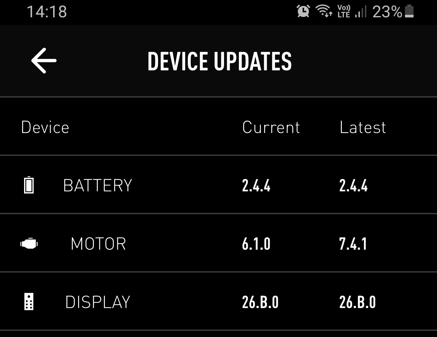

The second issue is potentially Bluetooth related. I'm assuming BT connectivity is via the TCU. Connectivity takes an age to pair with my Blackview 6000 which is only used with my Levo. Odly enough the when it does pair with the BV6000 it intermittently only connects to the Bike and not the Motor. To fix this I have to remove the Levo and repair it with the phone. Annoying, but not a deal breaker.... I've not been able to use the OTA update service which may be related to the above issue. Give's me the option to update and the stops around 10-20% and says 'Nah' not happening mate.

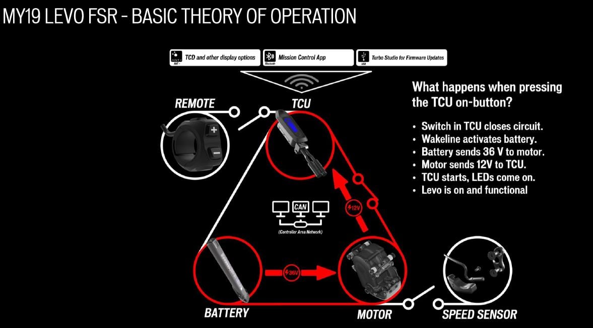

See attached pic of the Levo CAN. On the red circuit at 3 oclock you see the switch which is in the TCU, and that is what completes the circuit to power up the bike. That would suggest the switch on your TCU is in the on position permanently possibly due to a short circuit in the TCU. That may be due to water ingress. Others have described how long it takes to dry out the TCU if that happens. I suggest you remove it, unplug the USB port and keeping that uppermost place the TCU in a warm place like an airing cupboard for a couple of days.
thanks for that. I will give that a try
