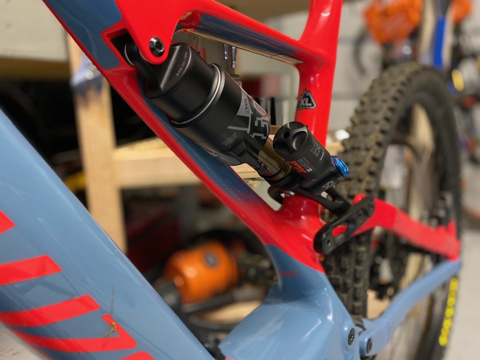

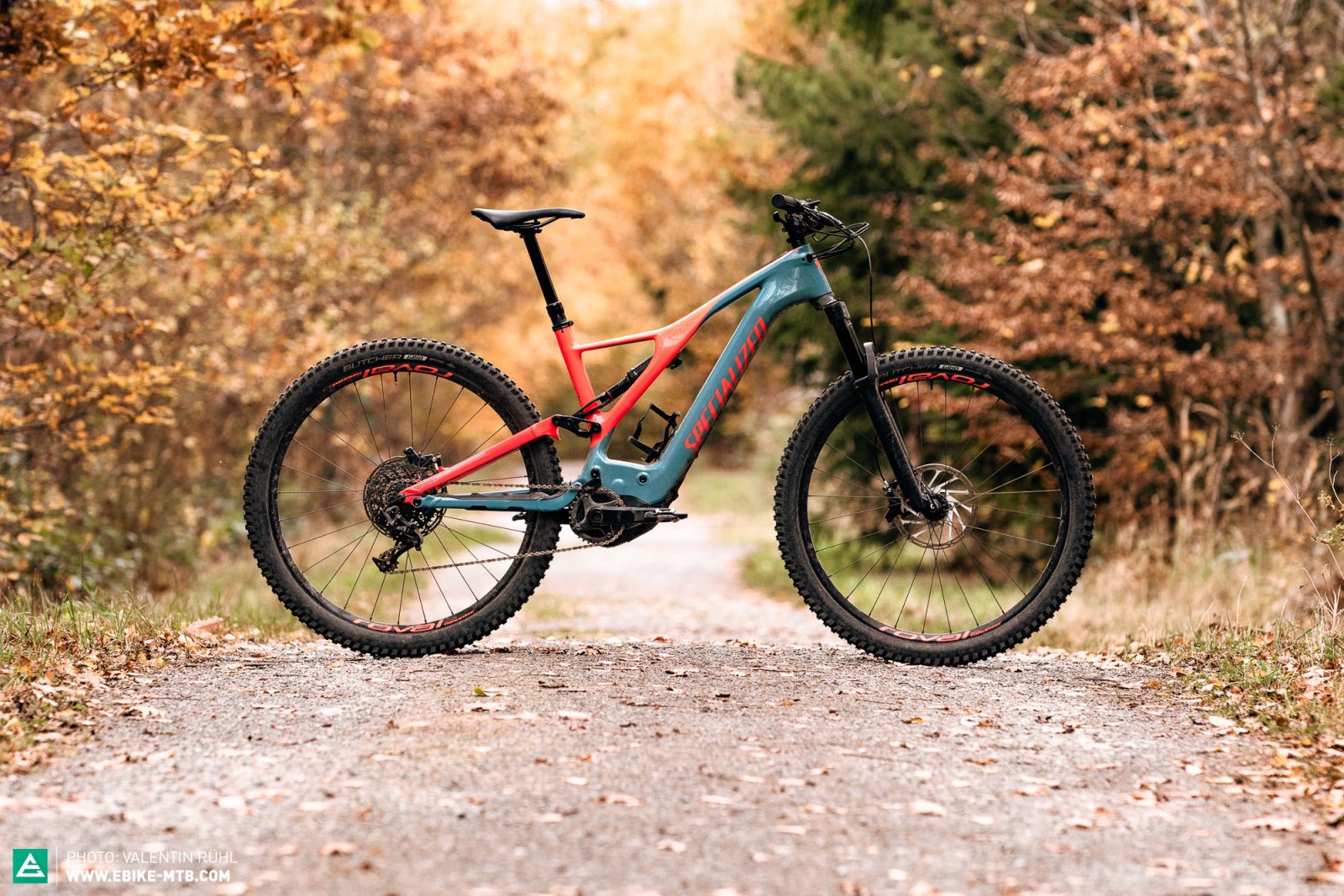

2019 Levo + Fox X2 Shock. No one seems to know if it fits, but i have an X2 @ 210x52.5mm coming in the mail today. I'll keep you posted

Cant see why it wont as its the same size as the standard shock from what i have read
Can i ask why you chose the X2? most reviews Ive read favour the DPX2 over the X2
This will prob be my next upgrade

the x2 offers the high and low speed compression adjust that i really want in order to take bigger hits and not bottom out while running a non crazy vol spacer amount and less LSC

Have you checked to make sure you leg/shorts dont catch on the shock? looks like it sticks out quite far!

That's what I ended up doing. the first time around I couldn't get it to fit but after another go i got it. thanks guys. Funny how after asking if anyone has put one on we get crickets lol, then once it's on everyone is like "oh yeah here see it fits fine" lol :p

Well after a few days with the X2 shock i'm SUPER happy with it. I opened the shock and removed the travel reducer to make it 210x55 and I set the flip chip to high. Let me tell you, anyone that thinks the dpx2 is better on this bike must not have much time tuning a 4 way damper shock like this because once you spend some time tuning it, its un-freaking touchable... it's at 4 volume spacers with a little more HSC and HSR than you would think necessary, but this means you can open up the low speeds to just EAT the small to mid stuff. The bigger hits is where this shines as well, no harsh bottom out no matter what I through at it. The dpx 2 I have tried felt like a cheap shock next to the x2, and i spent hours on it tuning, a big hit will quickly overwhelm even with higher psi, large vol spacer and the compression in most all of the way.
