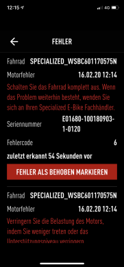

Today I also connected to MC app and got motor error 6
Turning off and on again didn't resolve the issue
The bike ride yesterday was normal without any problems? What to do now? 9D74E456-B9A8-45C3-84B1-0BEF426CD8B2.png

Yes the app has had an update and will show these error codes
If the bike rides fine then ignore the error codes and they will eventually disappear
This happened to mine Chris@BerkshireCycles said the above and indeed they did disappear and the bike was fine
I think Speciailzed resolved the issue so check you have the most recent version of mission control in the play store (Android) or whatever iphones use for its apps

I went for a ride today and the bike had the normal behavior. The error codes disapeard without any updates done to the mission control app.
Thanks
Biclas
escrs
Jun 26, 2019
283
260
More than likely you have the app set up to auto update, if not maybe Specialized pulled the updated version from the play store
Either way just ignore the error codes and they will go away, think i was told to ignore error code 3,4,5,6 im sure it is mentioned on another thread on here but cant remember which thread

I still have the error codes but don’t know why. I recently purchased Blevo and there I get a red blinking dot behind „motor“ what I think is nothing positive and maybe is the same error MC gives me...?! When we rode yesterday I had my little girl on the Macride childseat with me and the motor seemed a little noisy, not as I’m used to it. Don’t know what to think of all that...
