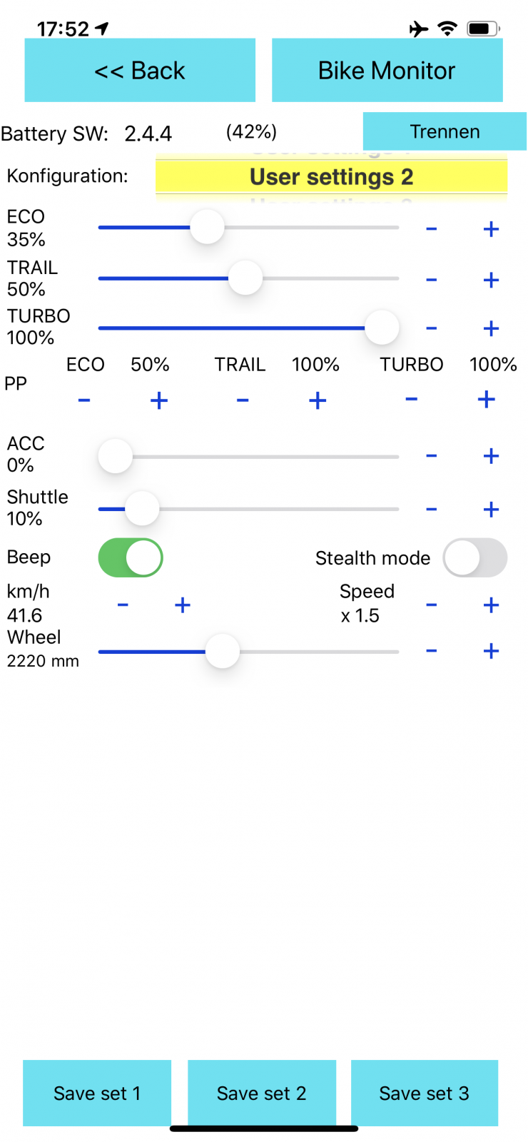

I can confirm the speedo does not work....set the Levociraptor on 3, in Blevo changed the multiplier to 1,5 and left the wheel unchanged at 2240 (27,5 inch wheel) the shown speed figures are too low probably around 10-15kmh

Sorry, I saw 3 screenshots and I don't understand the meaning.. first of all the wheel size must be the real wheel size. So the first screenshot is wrong.
The other 2 screenshots, I don't understand if the speed value appear after connection or you modify it.

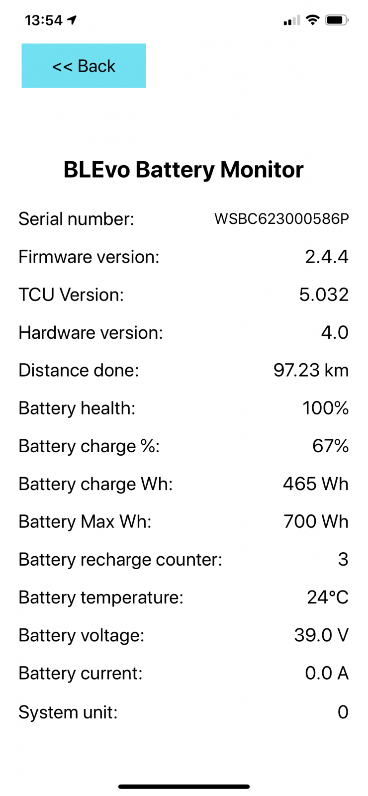

Which TCU version you have?

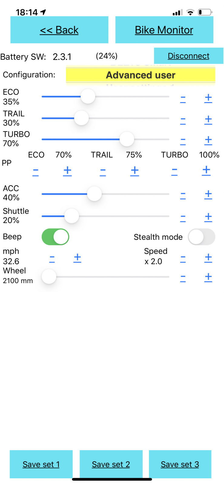

Ok just tell me what settings I need. I would like up to 27mph and my wheels are 29” . The bike is a 2019 turbo levo ?
Paolo, maybe we do not understand this correctly. Let me explain from the beginning. I installed the Levociraptor set the dial to 3 which means according to the Levociraptor manual a circumference setting of 1333 and a top limiter speed of 43kmh. Now my understanding is that the specialized Motor gives out speed readings over ANT+, so if I connect my Garmin Edge 830 and connect to the Kenevo Motor, I get the Speed Reading from the Motor. Now this speed reading is obviously too low as I am on 1333mm wheel circumference. Now comes the important part of my understanding (and this goes as well to TRAILWATTS) I sought that when setting in Blevo the speed multiplier to 1,5 and the the real wheel circumference (for 27,5 around 2220mm) it would "trick" the engine in displaying the right speed over ANT+ and onto the Garmin Display? Maybe I got this wrong and a 1x5 setting in Blevo only means I can see the real speed in BlLevo App but the ANT+ speed output stays at an equivalent 1333mm when (approx. 10-15 kmh too low) This would mean that all connected ANT speed displays which get the speed from the Motor do not display the "right" speed at which I am going but the 1333mm speed.
The speed multiplier adjust the speed only in BLEvo.. all the Ant+ data are wrong
Ok Paolo that answers the question. So I assume correctly that all the data recorded in the Engine (Total KM ridden) is wrong as well (lower than actual) but displaying total KM and Speed with Blevo is right! So this means that there is NO PROBLEM with Levociraptor... thanks that answers all Questions

Rememeber to restart bike TCU two times after install, don't ask how I know :)
I've spoken to Trailwatts and they have confirmed to me that this will not work on my 2020 Kenevo after I let them know my firmware details, yet othesr on here have fitted this to their 2020 Kenevos. I was unaware that on such a new bike that there would be different firmwares
The firmware version you have has not been tested. You are welcome to purchase and test. If unsuccessful then you can return for refund?
I am pretty sure it will work, I habe a 2020 kenevo expert with an firmware which is not on the list, levociraptor works like a charm
Please can you share your software version to help others.
