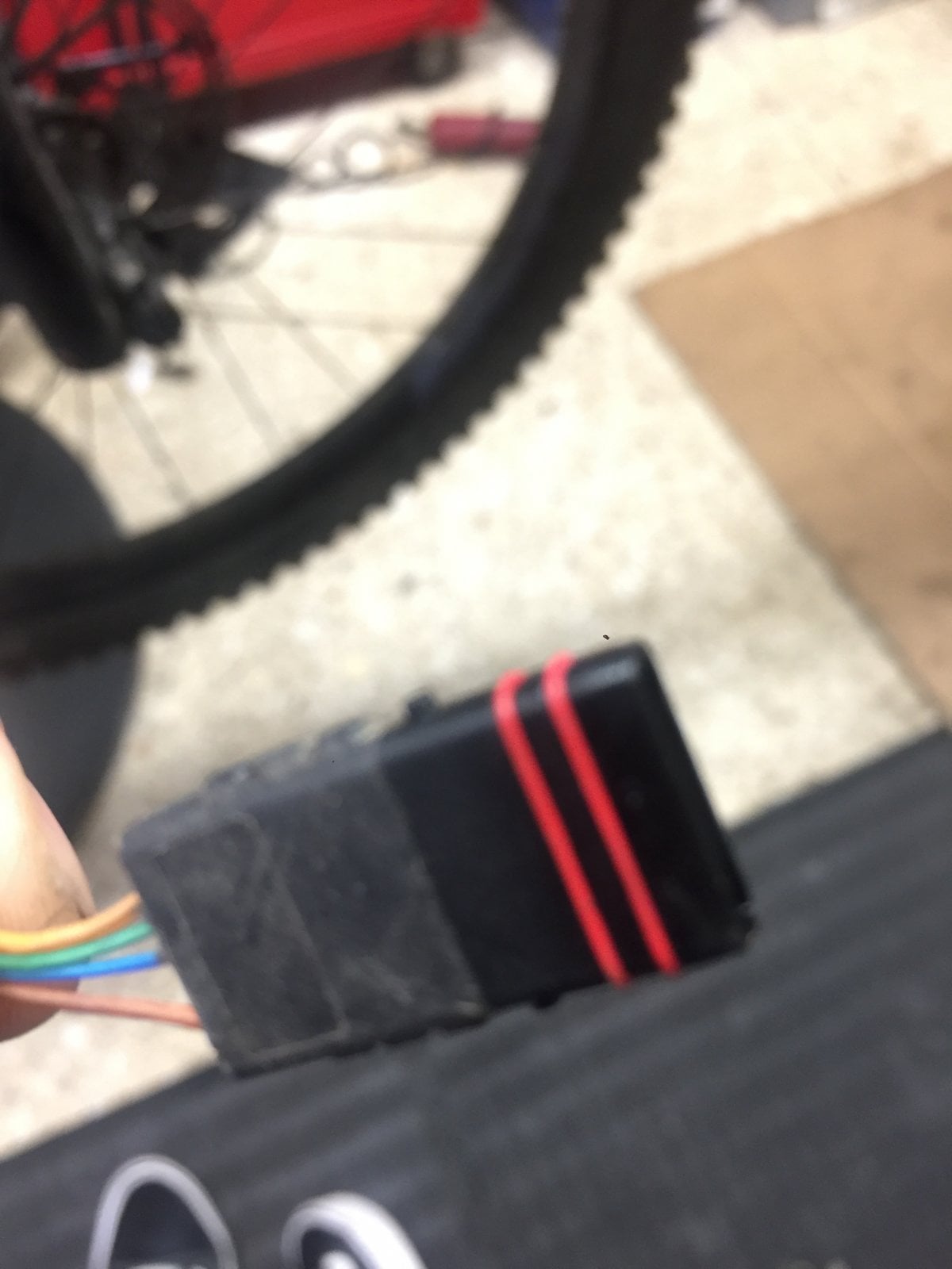

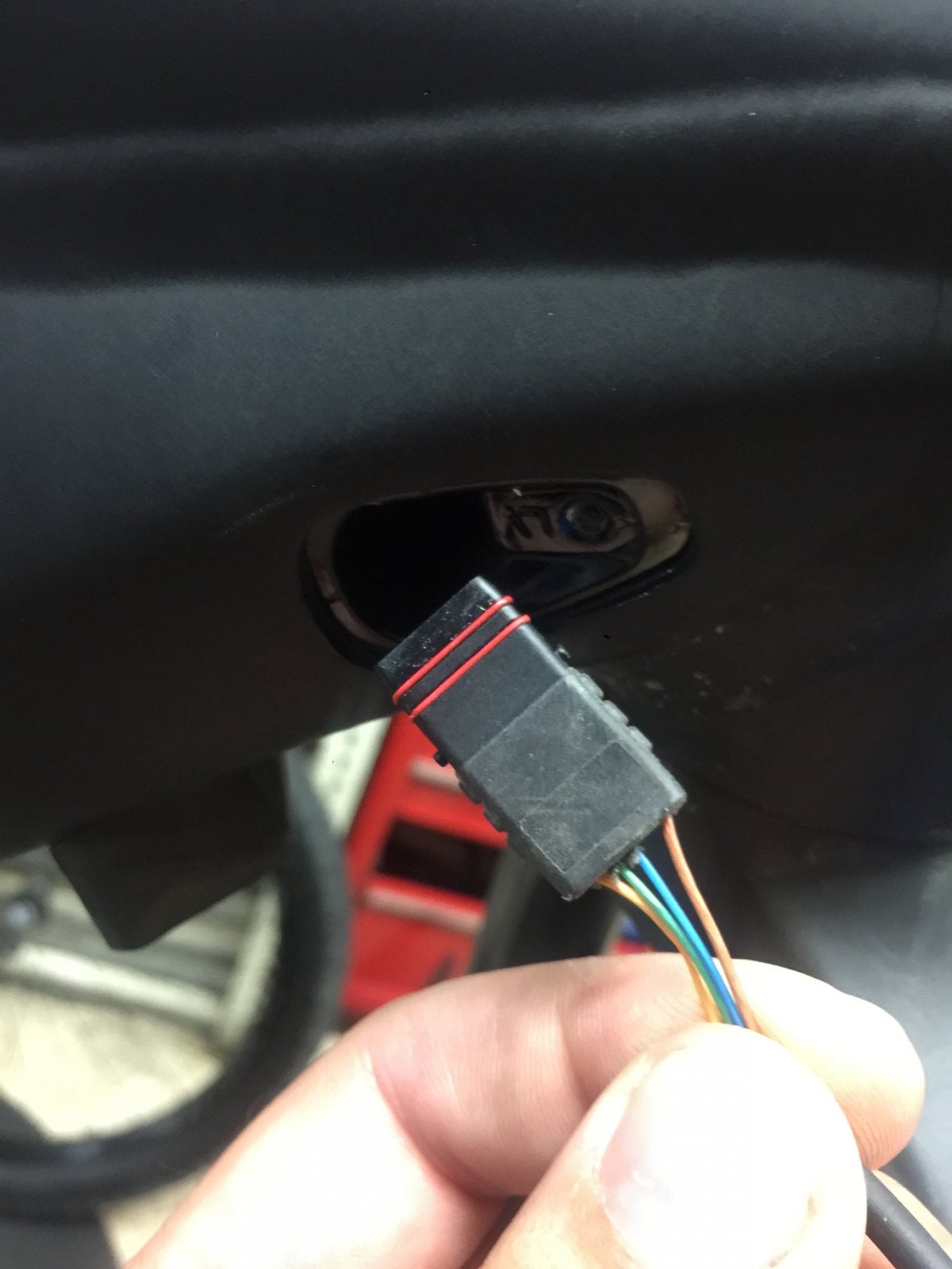

I walk assist handlebar controller (you can fit one to the 2017 model)
This isn’t accurate.
The 2018 has a bigger opening on the frame for the plug of the handlebar controller to fit through.
2018 Frame
2017 and older frames only have a hole small enough to fit one cable for a dropper post.
The only way to install it is to drill this hole out bigger and cut the wire and splice it back together. This will look like shit and and void your gram warranty.

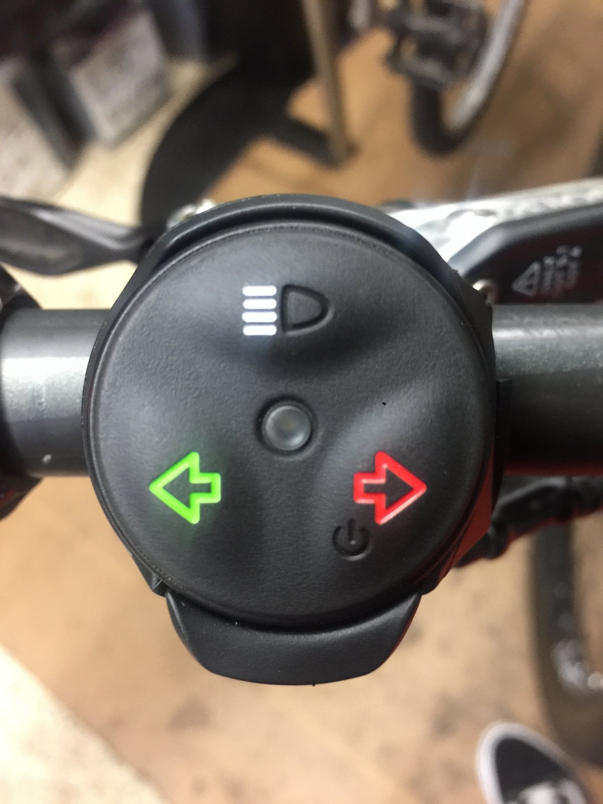

The best solution is the Garmin Ebike controller which uses no wires
Garmin eBike Remote | Garmin
It does have a walk button, but you’d be amazed by how little you would actually use this feature.
2018 Frame
There is no aftermarket part number for the Specialized remote to add it to anything else

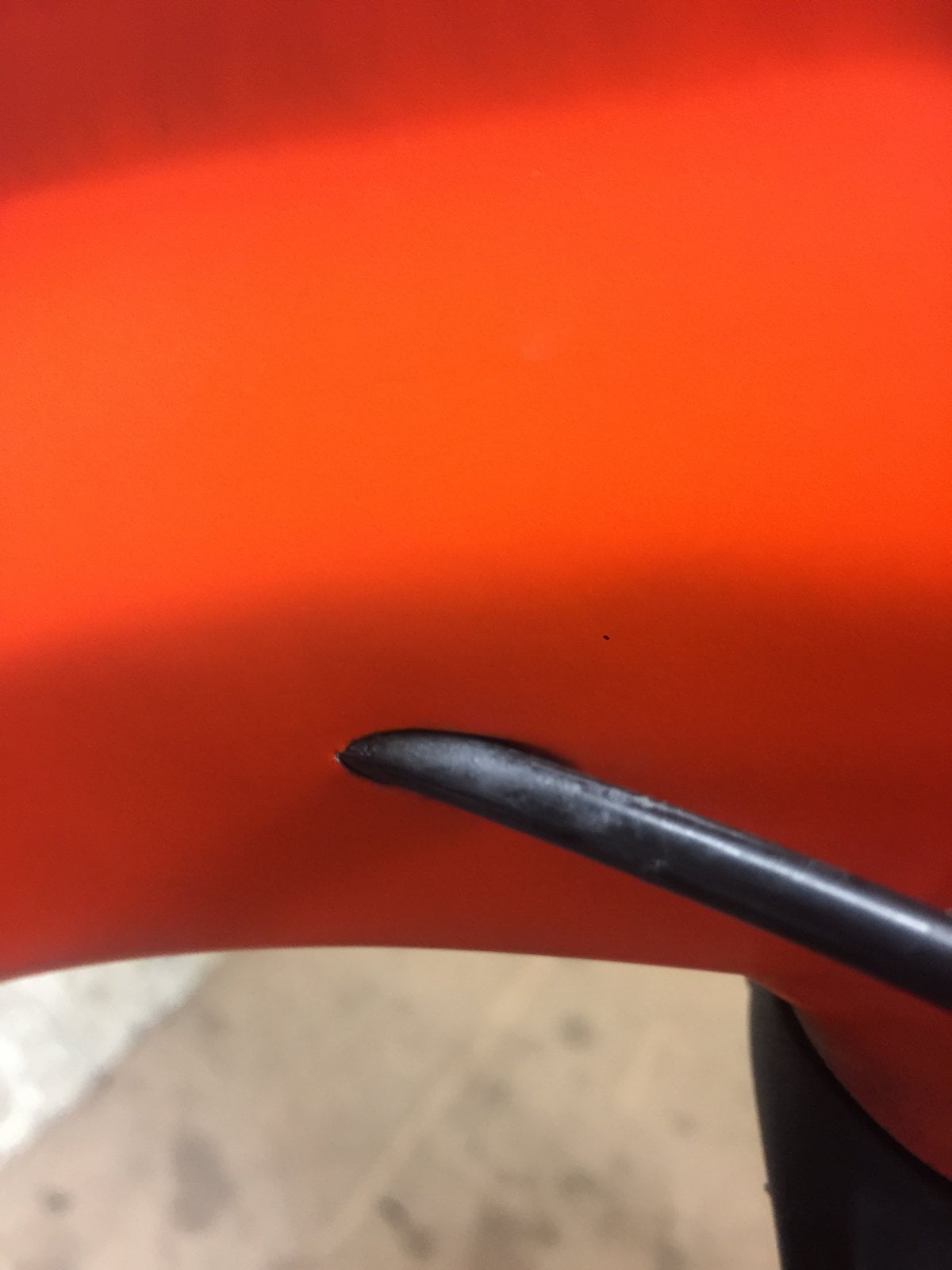

Hi Al
I didn't run the cable through the frame (didn't want to drill a hole and void warranty) so I bought some cable mounts with sticky backs and used those. So the cable runs from the handle bars, down the frame past the drink bottle, and into the plastic cover on the non drive side. Just used a dremel on the plastic cover to make room for the cable. cheers

The photos in my post were taken as I was removing a faulty Specialized controller this morning. My customer has had the bike for eight days and we installed the Garmin remote off her old Levo.
Since the Levo has internal cables it would look kind of amateurish to me to run the wire outside the frame, so it never occurred to me that anyone would do it that way. Cheers
Looks don't worry me (although black cable, black cable mounts on a black bike isn't noticeable) - warranty does.
