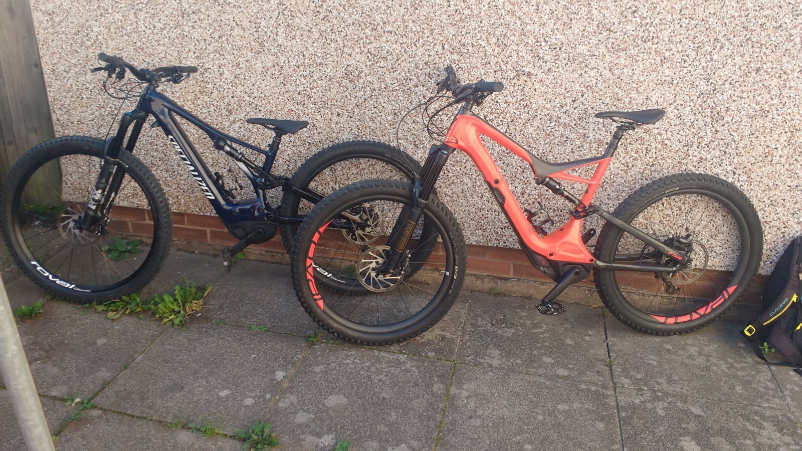

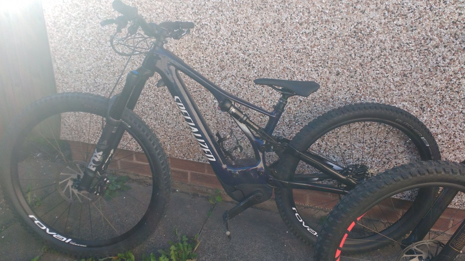

We recently hired a '18 levo on plus and '19 levo on 29. Her on 29, me on 27.5. Now i don't know if it was the weight/size difference being an XL and S or the motor or both, it certainly wasn't fitness/technique. We were both in Turbo on a flat blue trail. She continuously left me for dead and had not been biking for 2 years. It was embarrassing! I couldn't keep up. I've been riding 29 for years now: Enduro/SB5.5/Primer and would not consider a plus. They were too vague and I think the difference.
I'll have my '19 levo tomorrow, so will be able to compare even better.
So to answer your question...i would definitely consider 29. If the geom changes do not bother you.

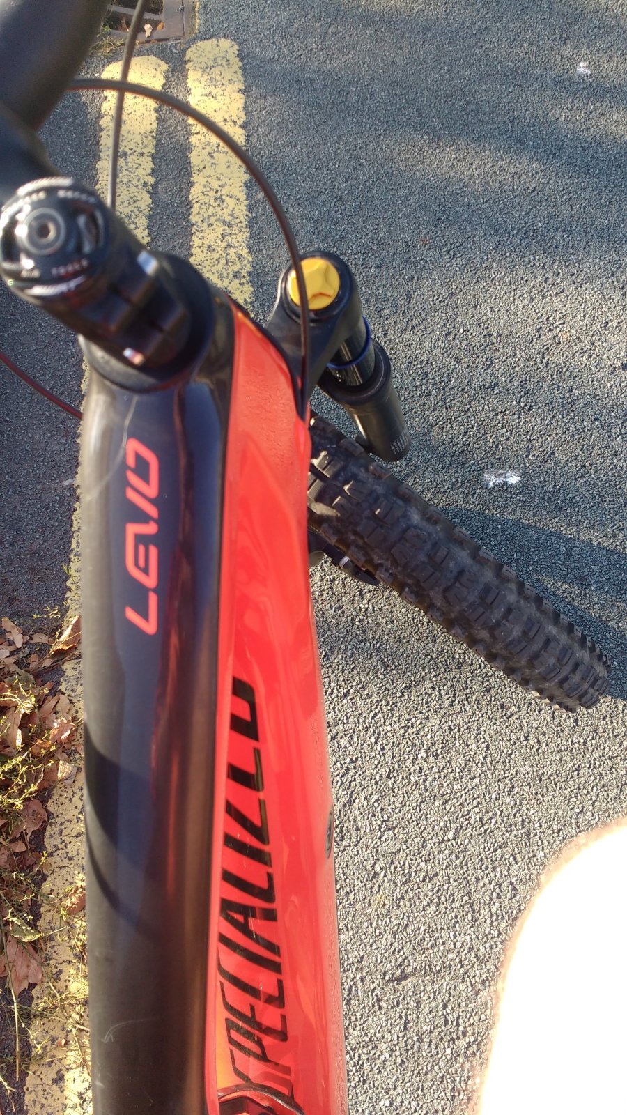

I’m a rather big unit. 6ft and 120kg. I found out the other day in degla I was running of the bends, and the switchbacks I was struggling to get the front wheel around.

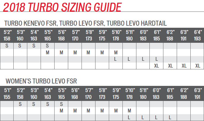

Trouble with front end grip is usually caused by not enough weight over front wheel. You may be able to solve by adjusting position of saddle forward and/or fitting a longer stem. But if reach is already a little long the later is not an option.
At 6'0", the recommended size for you is L.
