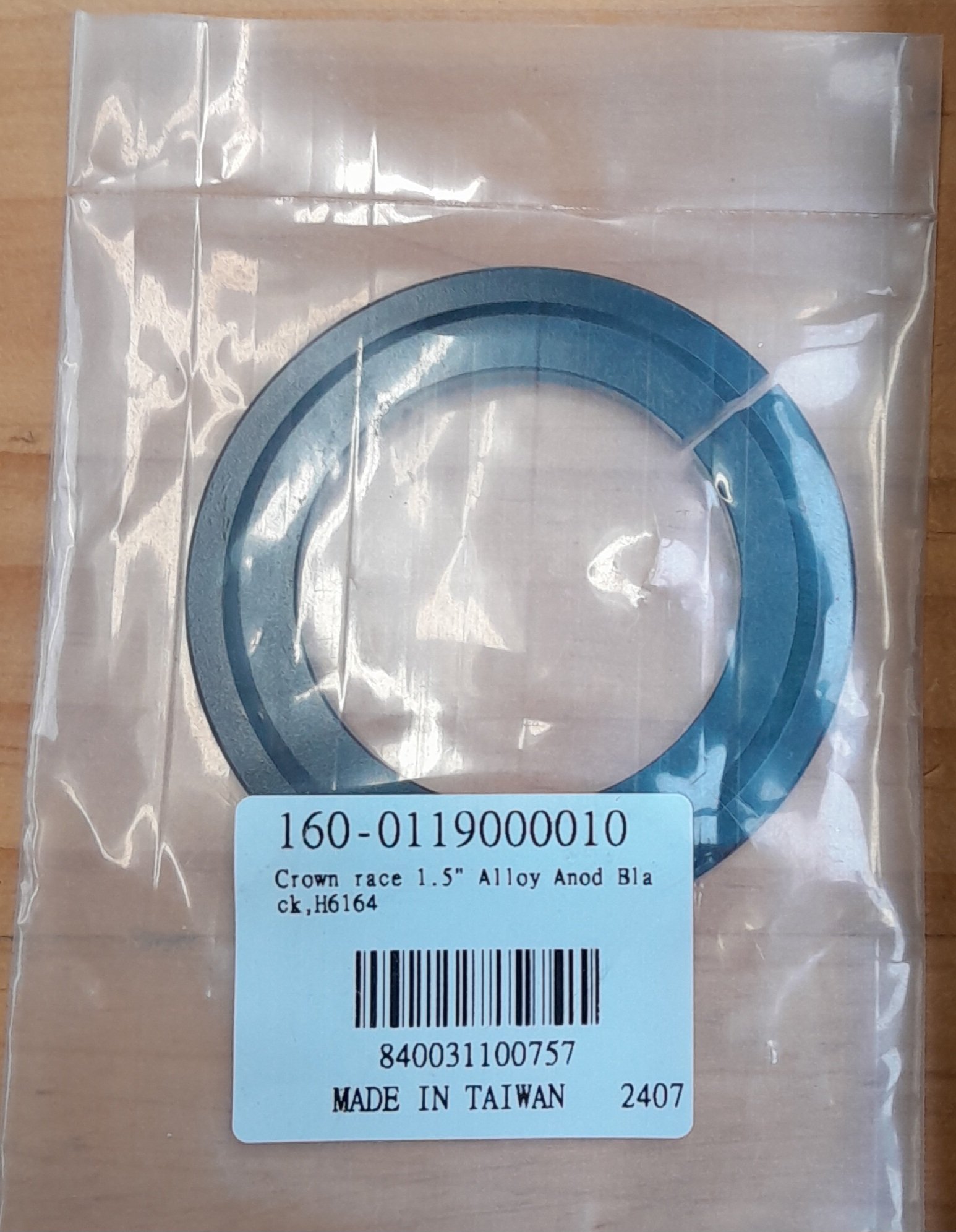

I picked this up from trek in usa Trek 2022 Rail 9.9 / 9.8 29 1.8˝ to 1.5˝ Headset Reducer Crown - Trek Bikes
seemed to fit my 1.5" steerer tube and mated with lower bearing frame I have not tried it out as it is on backup fork. Still using my oem zeb with 1.8" steerer tube

I've just bought some custom tuned forks for my new Rail 9.8 as I weigh less than 50kg. I dropped the original forks out and my heart sank. I didn't even realise there was another standard other than 1.5. Some frantic searching online to see if there was some sort of fix and I came upon your posts. You made my day! I bought the adaptor online from Trek in Australia.
