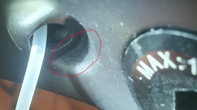

    Rough carbon that has not been painted properly. This is a very minor issue.

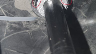

    Voids present in carbon at both sides of motor mount area, potentially compromising bolt integrity. Also the metal inserts are not in the center of the supports, weakening the adhesion.

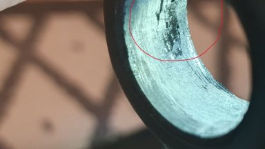

    Some red paint marker, indicating maybe QC fail. Some machining probably done, but it has not fixed the fitment issues

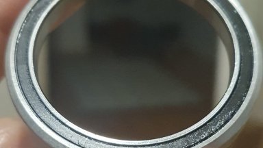

    The headset is according to LC made by Enduro. However Enduro confirmed my suspicion that they do not supply LightCarbon with headset bearings.
