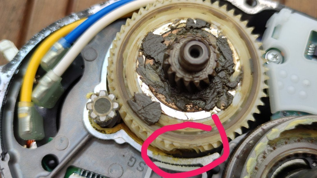

Yes, I noticed that, it is a PW2. But I have checked with a couple of Giant and and Yamaha bike mechanics and they told me that although Giant and Yamaha motors are basically the same, Giant has made it impossible to use a Yamaha motor in a Giant bike, there are several HW and SW incompatibilities that make it impossible to convert a Yamaha motor into a Giant motor just by reloading Giant FW.
I already opened the motor (18.000Km) and the problem is that the nylon gear has three broken teeth, but in eBay there was a brand new Yamaha PW-X2 for 516€ and my mate preferred the new motor. But as it is not possible to install the Yamaha motor, then I have bought a new nylon gear in eBike Motor Center and I will substitute it, and my friend will be a happy camper again.
This is the nylon gear with three missing teeth
Yes, I noticed that, it is a PW2. But I have checked with a couple of Giant and and Yamaha bike mechanics and they told me that Giant has made it impossible to use a Yamaha motor in a Giant bike, there are several HW and SW incompatibilities that make it impossible to convert a Yamaha motor into a Giant motor just by reloading Giant FW.
The problem is that the nylon gear has three broken teeth, so I have bought a new nylon gear in eBike Motor Center and I substitute it, and my friend will be a happy camper again.
