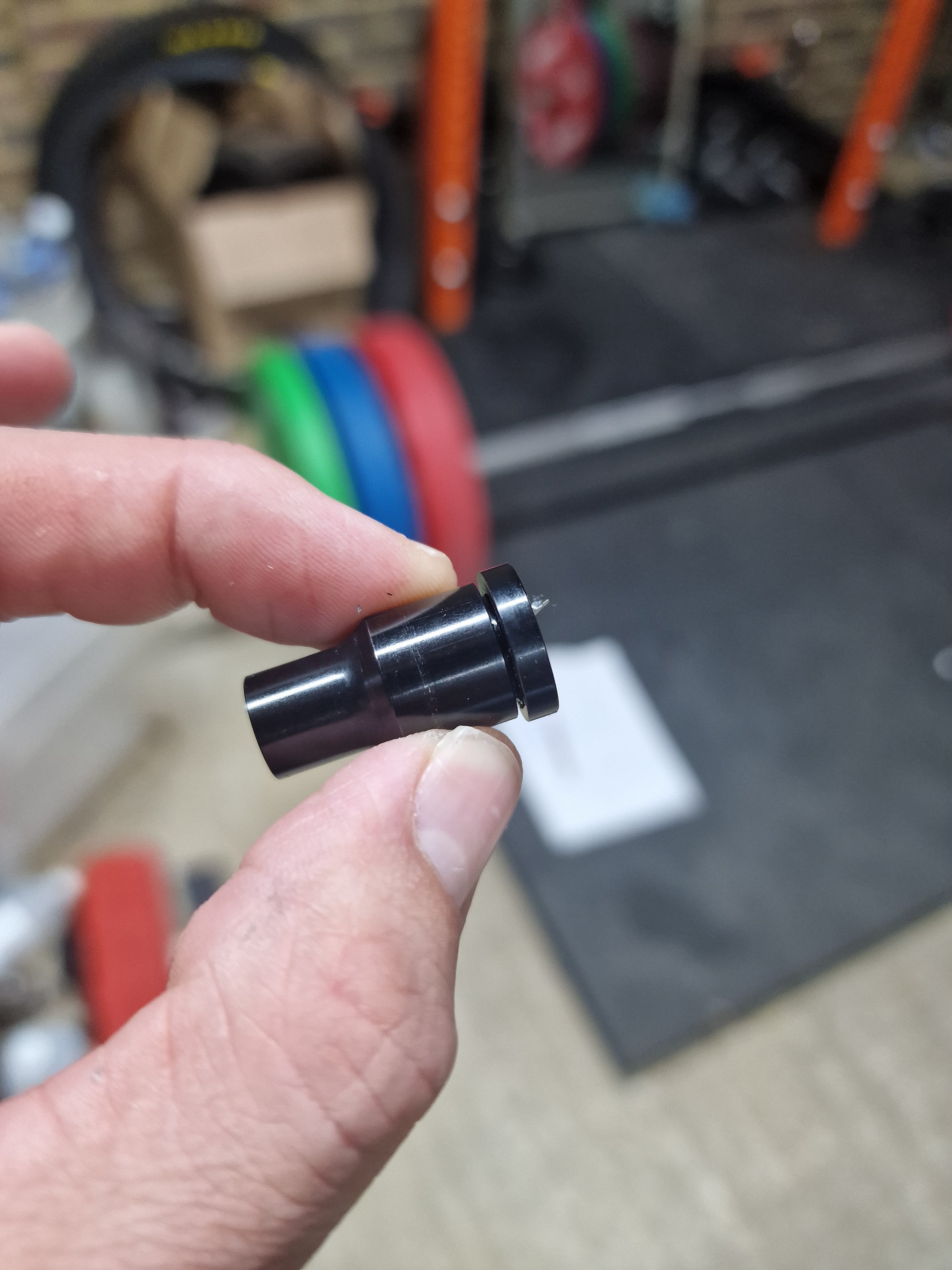

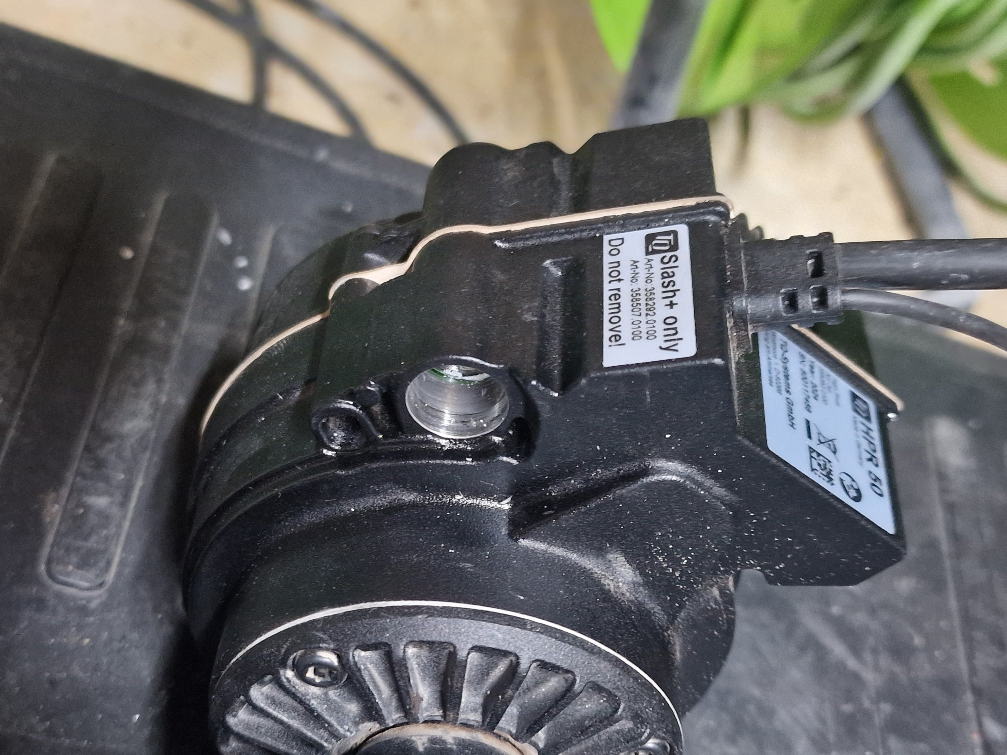

Are the two HPR50 Compensation screws on the Slash+ adjustable?
At risk of sounding really silly, I am almost certian both are adjustable however one has siezed on mine (well aware its left hand). Ive had to extract this as they are made of cheese and the torx bit was rounded off when I got it, and in doing so have removed the housing for the bolt too which was green threadlocked into the motor body.
Not the end of the world if I need to buy a HPR60, but pretty shit. Hopefully if Ive made a mistake here itll help someone else avoid it.
I also cant find a specific compensation screw for the Trek Slash+, Silverfish in the UK sell "TQ HPR50 Drive Unit Bolt Set SKU: TQ-339276" which arent suitable for the Slash+ as the Slash+'s screws have a narrower head.
Yes they should be both adjustable. If you need a new one you better of asking your lbs Trek. Usually they are set and forget, you only from time to time play with the fixation bolts to add carbon paste to avoid creaks on crank push.
They are definitely adjustable. And made of cheese!
I know mine were just starting to round out with a t55 wrench that had a tapered head. I was able to get everything aligned within .5mm and after re-assembly with anti-sieze & locktite the bike has been silent since.
I am not sure what you mean by "housings for bolts" but if the compensator bolts are still attached to the motor, disc brake shims might be perfect to get everything aligned without having to adjust the compensator bolts. Just measure the motor, measure the frame, then measure up a stack of shims thick enough to make up the difference.

I just hammered it back in.
Not ridden it yet, so dont know if it creaks

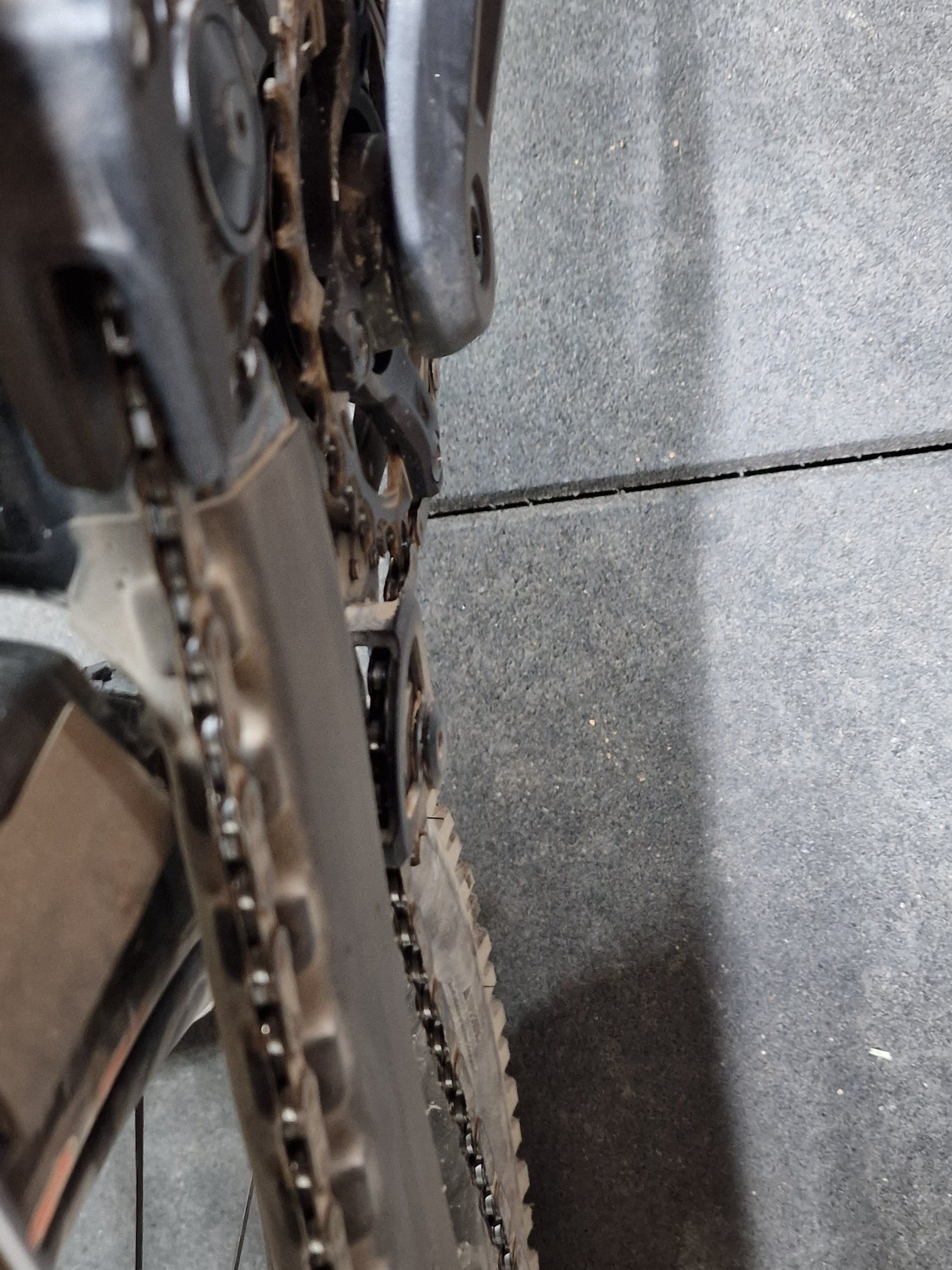

Small wash out and ive bent the lower idler.
Can it be removed entirely? I know the Slash owners do this.
Why do I have so many problems with bikes?
Maybe you can maybe you can bent it back.
In any case if you remove it it will loose tons of tension so you will need to reduce the chain length.
Honestly I would not remove it
