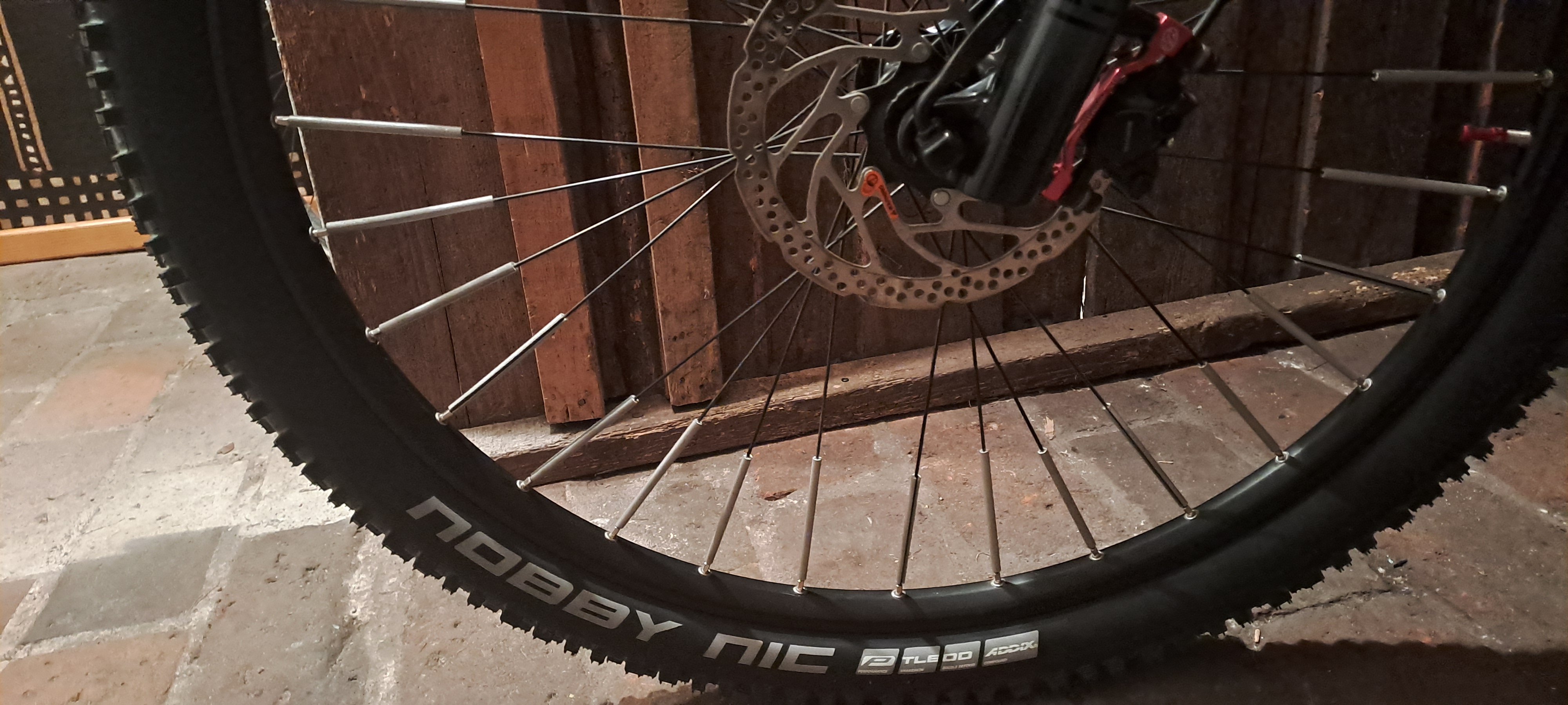

Also put on the new tyres, just in time for the shitty weather coming next week. (Related thread: Tyre advice: upgrade from Smart Sams )
I've put on tyres loads of times but I think this is the first time doing foldables, they were a bit of a bugger to put on as new tyres generally are. It's one of those "I need 3 hands" jobs (3 tyre levers ≡ 3 hands). Also in my haste put the front one on without checking the direction, was of course the wrong way (doh). "Changing tyres makes you tired".
Also cleaned the cassette and chain and the brake discs while I was there.
