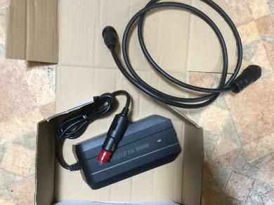

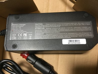

Hi kernow here’s a slightly different approach. My bike is The BMW version of the Levo and comes with an additional vehicle charger. Probably a BMW part so probably won’t be cheap, I haven’t used mine yet but it is purpose made for the job. Still needs a reliable power source though ie a running vehicle or charged battery. I guess the number on the back of the photo is a part number? Hope this helps.
Has that an RoPD connector on it? Would save me having to use an inverter. Only downside is charging at 2A where I can do 4A with my current setup.
I’m running a Focus with the same design plug. They are supposed to be a standard so it should work.
