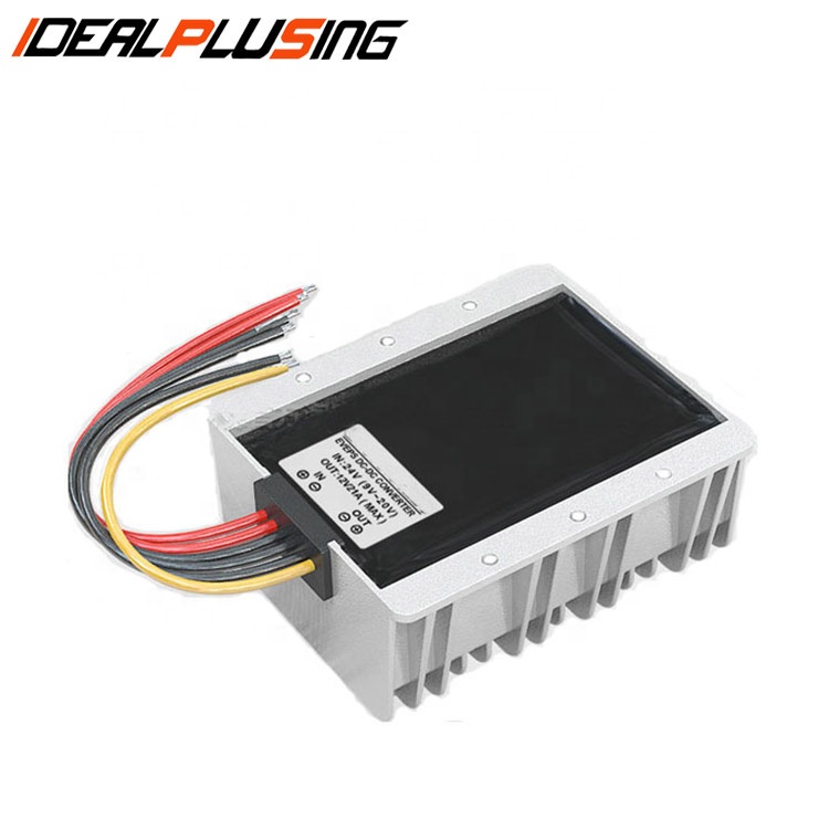

Anyone tried one of these?
Idealplusing 10a 420w 12v/24v To 42v Dc Dc Boost Inverter Power Supply Converter - Buy Power Supply 42v,9v To 12v Converter,240w Power Supply Product on Alibaba.com
DC-DC charger, so much more efficient that DC-AC-DC.....

I need to dome some hard thinking if the DC charger can push in more Watts than regular charger using the cars built in inverter.
To answer myself the standard Levo charger has an output rating of 42V 4A whereas the linked DC charger has 42V 2A output so basically half.
